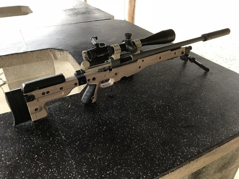

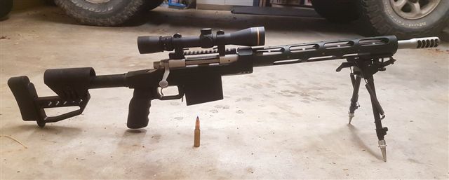

Like This (although its not a 6.5 or 308, its a 375WSM), Just fitted the XLR for a bit of fun. Eventually I will pull the barrel and rebarrel in 30Nosler

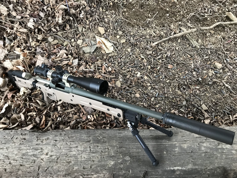

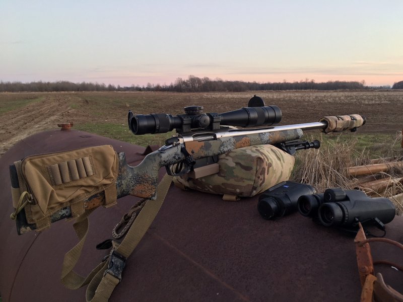

Ledzep is pretty much spot on if you're going to be walking even a small rifle can be cumbersome. The rifle pictured below is an 18" 6.5x47 with a remington/sendero varmint contour, loaded it's 12.5lbs. I'd go medium palma if you're wanting to retain some thickness. Look for a sub 30oz optic and pair it with a light stock/chassis.

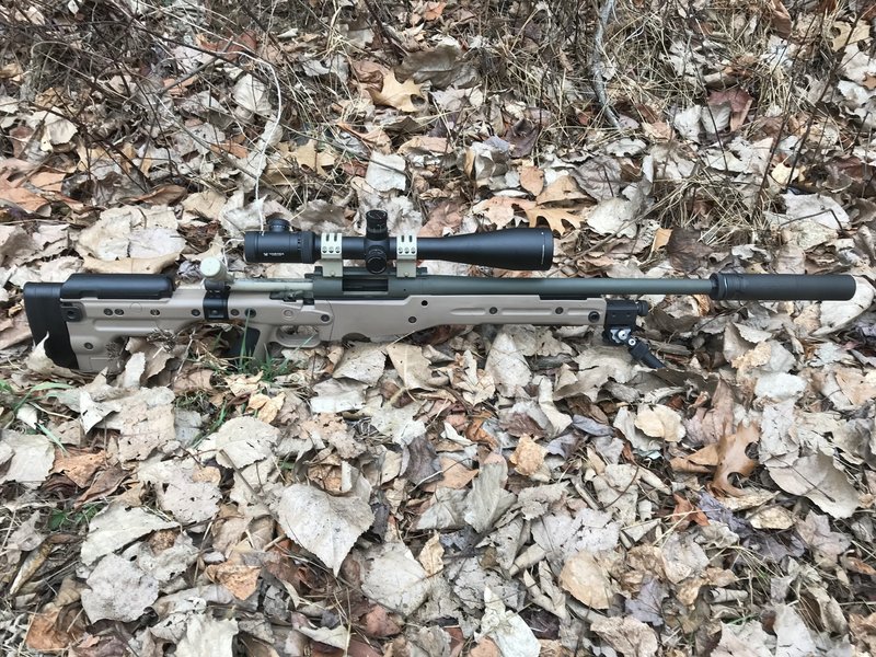

Do it - you won’t regret it. I recently built an 18-inch .308 with a Bighorn TL3 and a Criterion prefit in an XLR Element (my match rifle is a TL3/Element setup as well, but with a shouldered barrel from PVA). My plan is to have fun, and maybe shoot it in a club match or two. I am still working on load development, but it has been very accurate with Varget and a variety of bullets. So far 190gr MatchKings have been the best. Subsonic suppressed .308 pegs the giggle-meter.

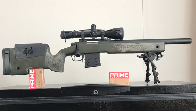

Just had a shorty built in .223 Rem, she is sweet..She feeds on 77 Prime.. I’m in love with her.. Tikka T3 or R700, just not Savage Happy New Years to all, and good luck in your quest!

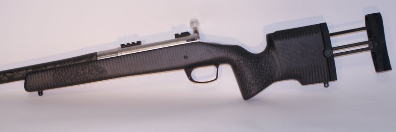

Maybe another option, Just for a shorty build, ( gap will also have a special youth model with spacers ) , Sneek peek at the new MCS-TC ( tactical Compact ). Details soon, will have new for shot show 2018. overall 24" collapsed, min lop about 10" quick deployment of butt to a max of 14". From front of recoil its only about 8" to tip of forend, designed for 16" to 18" or SBR suppressed. Pic is 700 style short action with 16" barrel in 6 creed. Thank you very much
