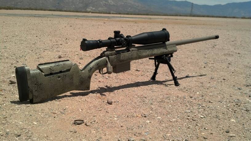

See photos.
The farthest target in front of the rifle is 450yds and was the one I was shooting at during the ladder test.

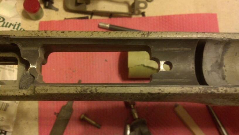

I did spend time lapping the bolt lugs, polishing the firing pin, bedding the scope mount, skim bedding the action, ect. before shooting the rifle.

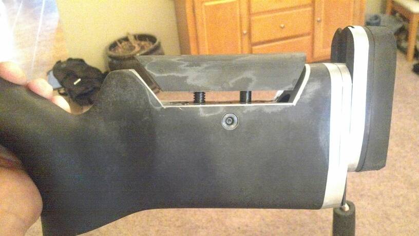

Great looking rifle! I just ordered the same one. By chance did you take any pictures of the work you did to the stock? I don't think that I will be lapping lugs, or polishing the firing pin, but I may skim bed the action. This is my first HS stock and I'm going to see how it shoots before I alter it.
Ergonomically, I'm not a fan of the hs stock on the savage. Palm swell seems too fat. It's a solid enough stock, though, and since i already had it I made the cheek adjustable using kmw hardware, the butt adjustable using a choate 3 way, and skim bedded it. It's a lot better now but still not a fan of the palm swell...
I saw the pictures of the loggerhead install, great job! I am planning on attempting that in the future. I have heard that the palm swell is like it or love it, I guess I'll find out when mine comes in. What bedding compound did you use? I have only used M-Tex in the past and wasn't sure how well it would hold to the aluminum block.
