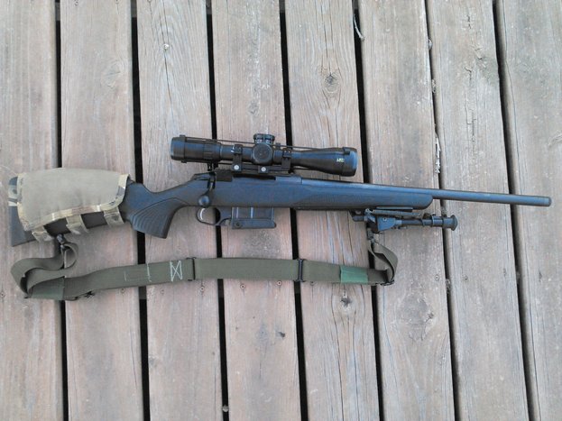

I do really like my Tikka CTR but as more of a general purpose rifle.
