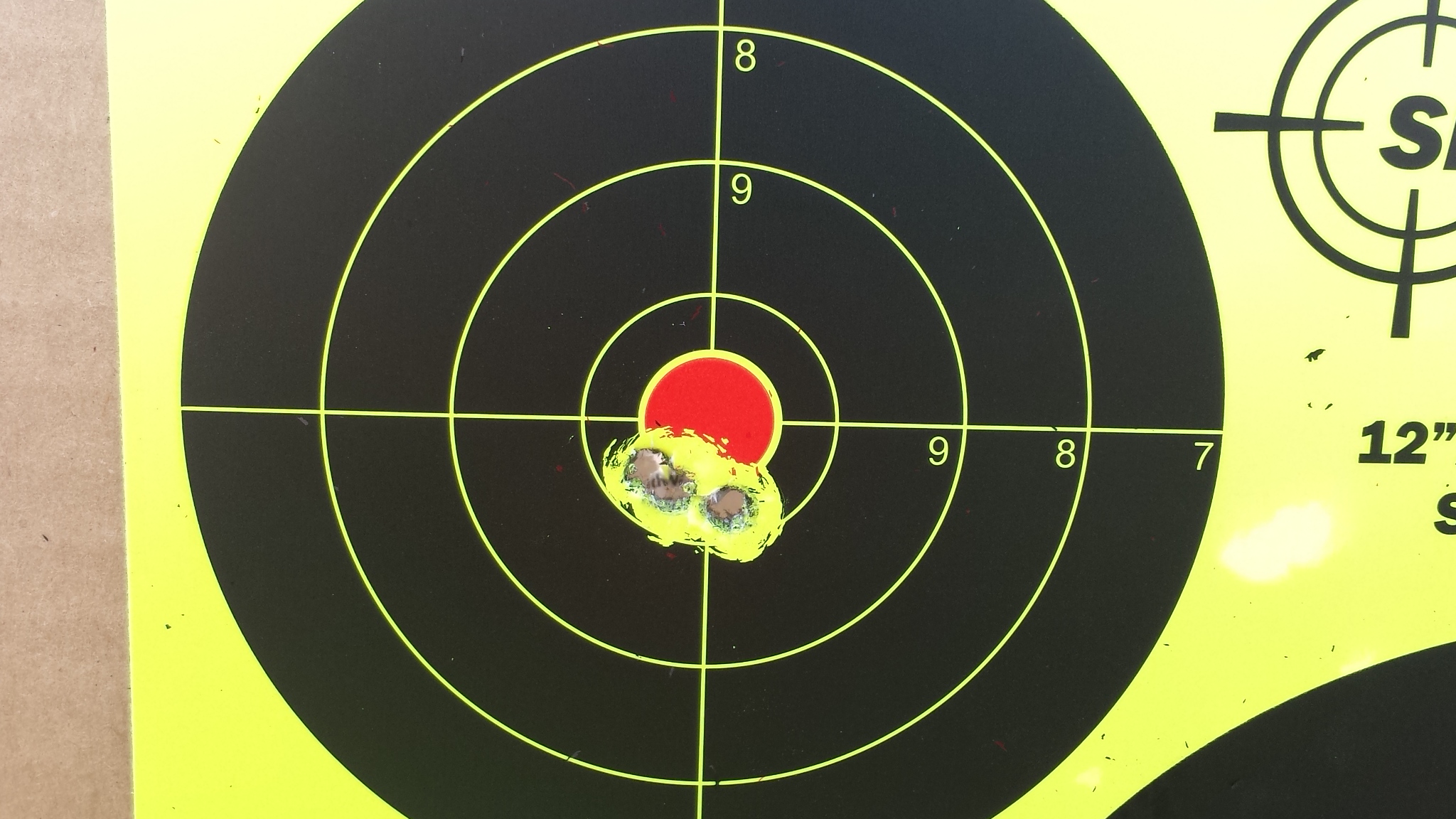

I have a .223/5.56 (Rock-River Ar & Savage Trophy Hunter XP) both with 1:9 twist. Both are completely stock.
I shoot 70 GR VLD for the longer distances . I'm using a Vortex Viper PST 6x25x50 (FFP) with a 20 MOA rail on my Savage. I can reach out to 800 yards, but it has to be fairly calm so that little bullet doesn't blow away. :)
For shorter distances I use a 55 GR Hornady B/T with 24.5 GR TAC, or 25.1 Varget.
This is an excellent round, reloading components for it are easy to get and they are not too expensive.
Once I learn the principles of longer range shooting with this round, I too am going to get a 6.5/284.
The pic I posted is a 3-shot group at 100 yards with the Savage 223, loaded with 55 Gr. Hornady B/T and 24.5 Gr. TAC.
