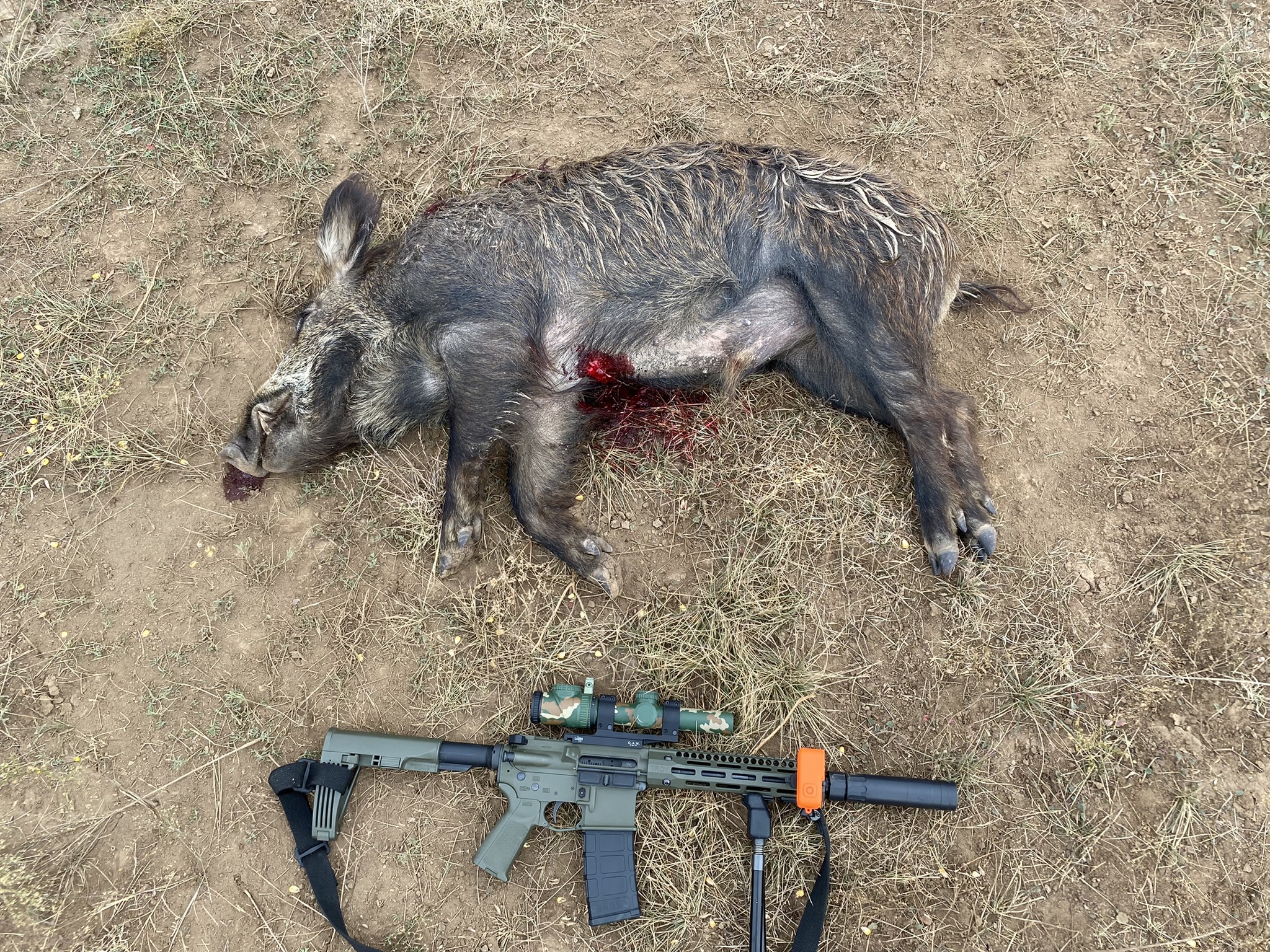

Does parallax adjustment really matter for a 200 yard and less hunting 300 blackout build?
I have a 10” 300 blackout that has been used with a Trijicon Accupoint 1-6x24 for a couple of years. I like the scope, and have taken deer and pigs up to 200 yards no problem with 110gr vmax but I am wanting a bit more mag and better low light performance. This is for thick central Texas hill country.
i think my scenario pushes me into the 2-10xish category that has objective bells from 36 to 56mm.
My price range is less than $1,500, preferably $1,000 or less. The best glass on this range probably I’ve found unfortunately has fixed parallax,namely Trijicon Credo, Leupold VX-5 and Nightforce SHV.
Am I overthinking this that the Primary Arms GLx 2.5-10x44 is the way to go bc of parallax adjustment? Or do I just go for the best deal I can find for Trijicon (some good prices on Euro Optic right now) Nightforce vs Leupold bc if the name brand and assumed better glass?
FFP vs SFP doesn’t matter for this purpose. Weight isn’t the biggest concern bc it’s a light rifle. Even with up to 28 oz scope I think it’s fine.
