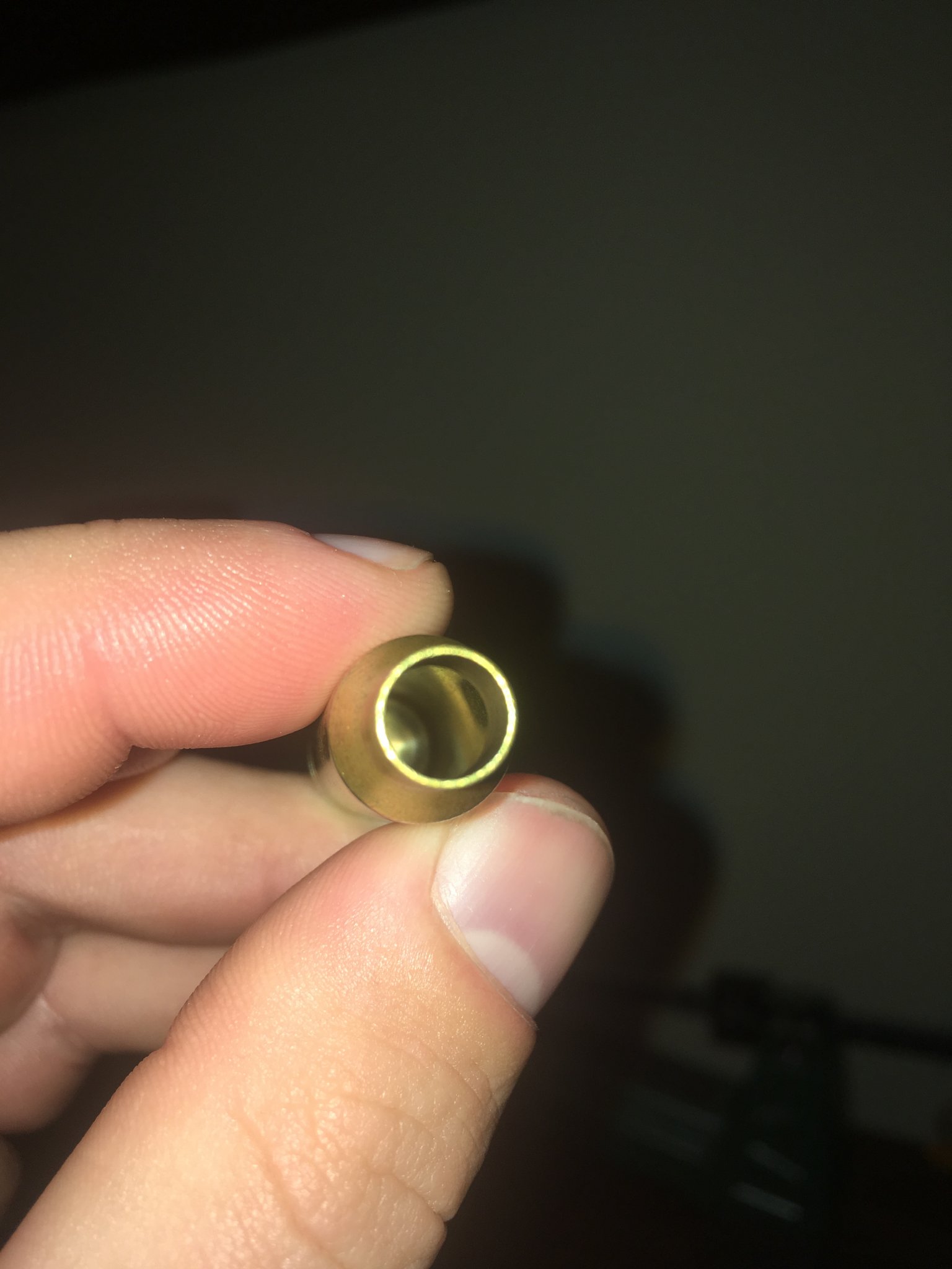

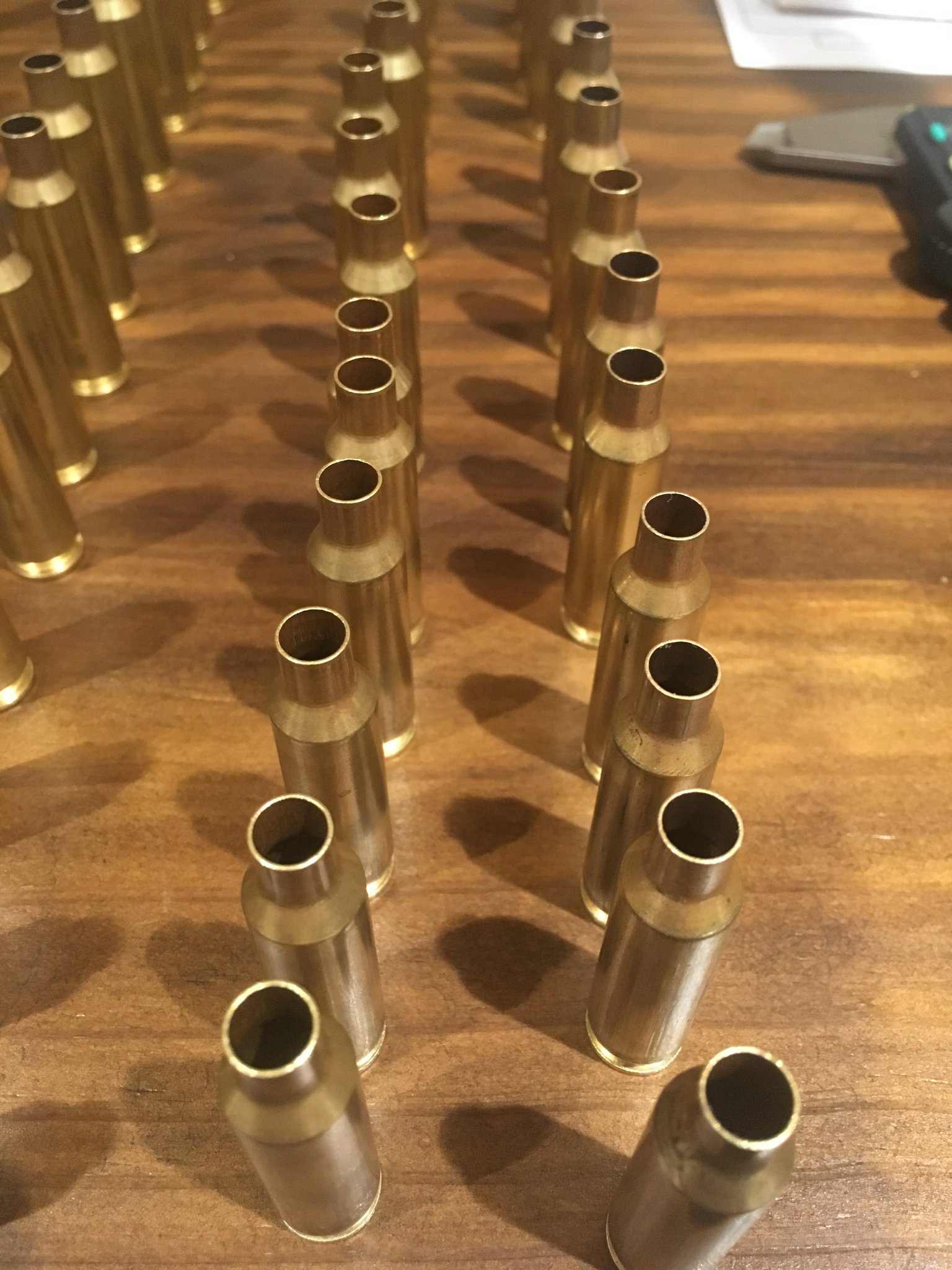

I have a new reloading setup at my house and used copper creek to help me develop a load with their stage I and stage II kit. All is good and I have the load data now. It is 6.5 creed Alpha brass with H4350 and loaded with berger 130 AR hybrids
I deprimed, tumbled in wet stainless media, annealed with AMP machine, then went to full length resize and 2 things are happening.

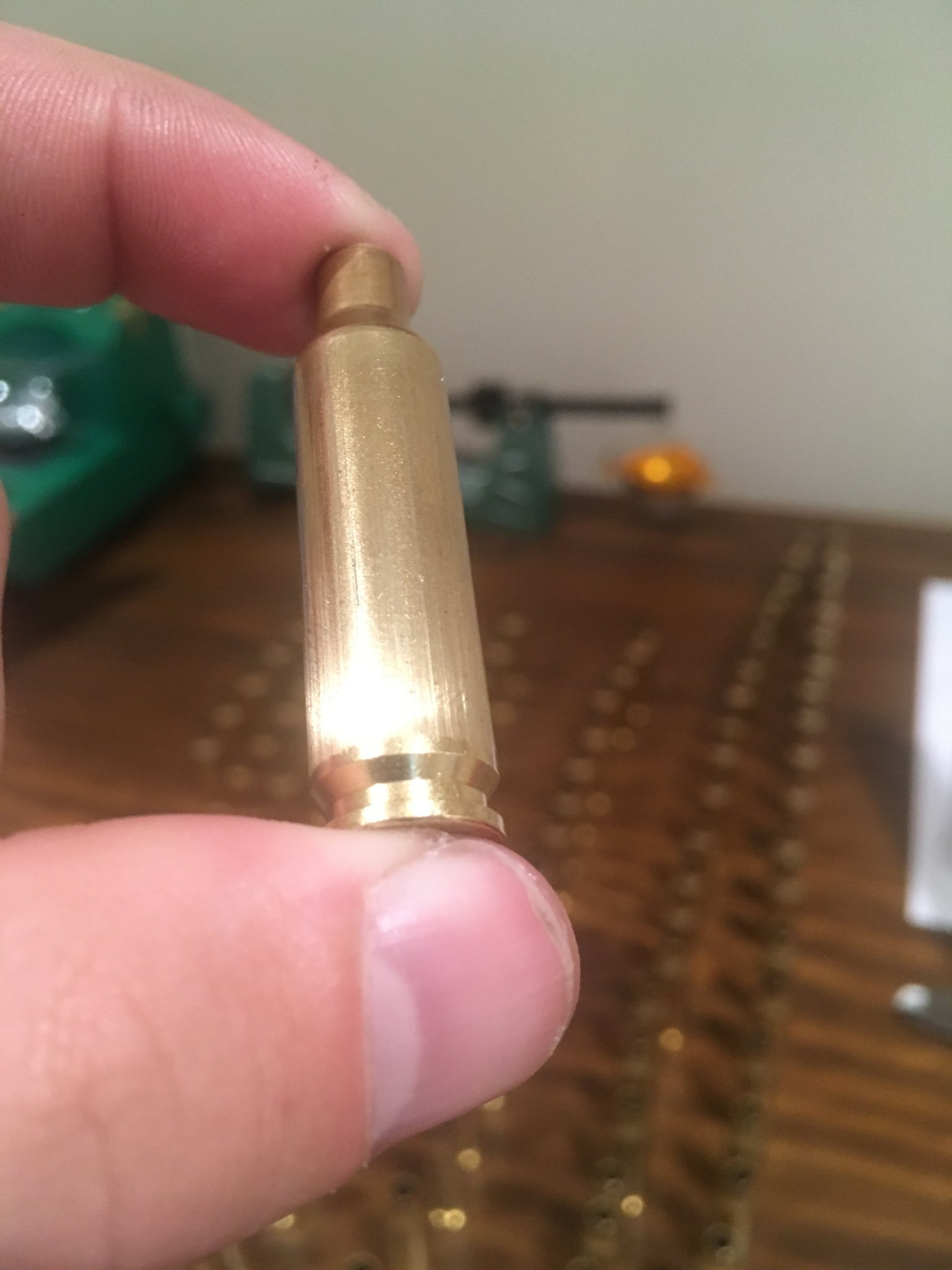

1. All my brass is getting gouged around the full surface of the brass. (I lubed the brass with hornady spray lube and I cleaned my LE Wilson die before use)
2. After getting the die set in my Forster press my shoulder bumps are averaging between -.003 to +.001(most are -.001 and .000) when checking with my Whidden case gauge. Is this correct? Should it be the same every time?
