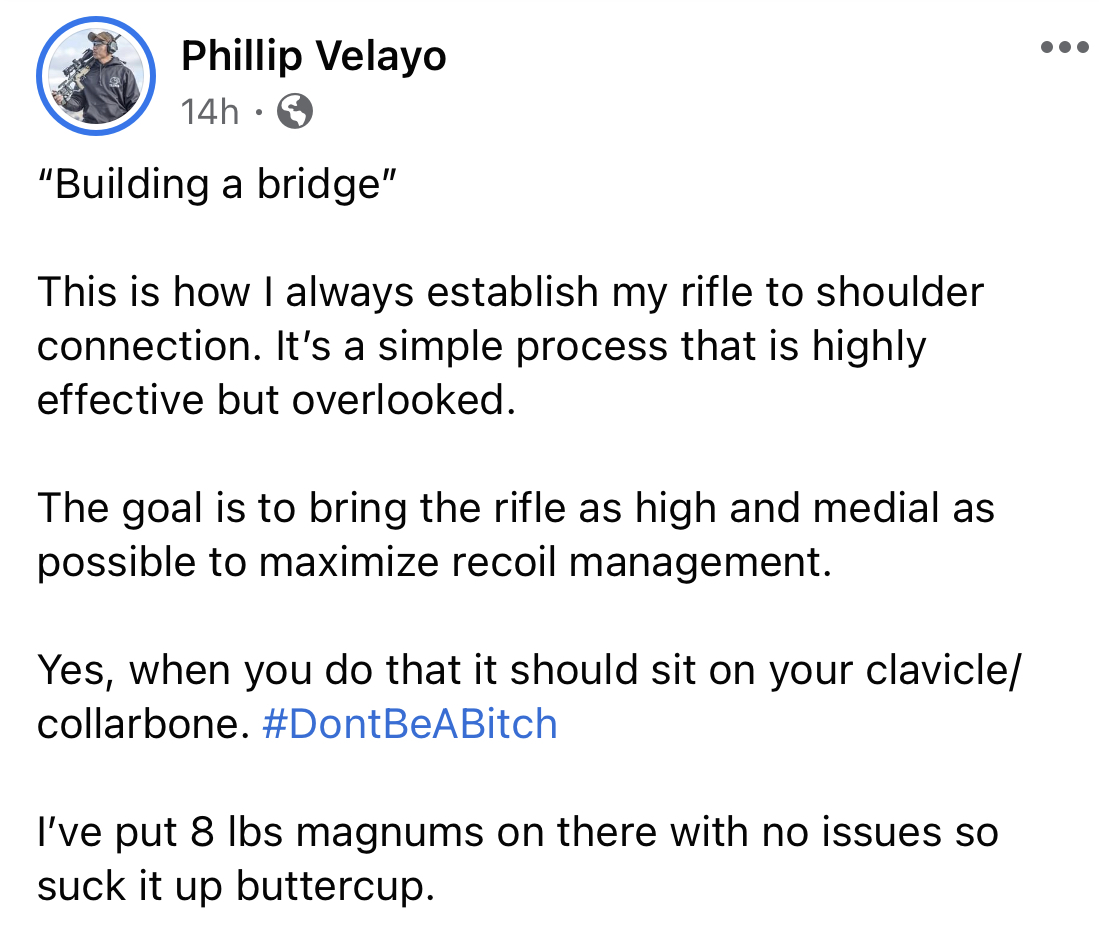

I find that putting the butt of the rifle stock on my collarbone really helps out with recoil management while in the prone. Is this wrong. I have heard you do not want it on the collarbone, you will eventually crack your collarbone With a magnum rifle. I find if I put The butt of the rifle stock in my shoulder pocket, it is always bouncing to the left. Not so much with the heavy rifles, but especially with lighter hunting rifles. When rifle is On the collarbone the rifle recoils straight back and I am back on target after the recoil pulse.

Yeah, I saw his videos. Just trying to make sure my fundamentals are set up properly

In one of the latest training videos, Mark says he puts the stock on his collarbone and he knows this on his collarbone because it is broken. I take that to mean it is more inboard. I could be wrong, I was wrong once before.

    The “pocket” most people think of is that soft spot just inside your shoulder. You can make this work, but to illustrate here’s an exercise:
    Have someone stand in front of you and square to you. Now, put your hand in that soft shoulder pocket and push them. You should be able to fairly easily rotate their body a bit.
    Now, same setup, put your hand close to the middle of their chest on collar and push. They may move back a little. But very little rotation.
    This is what your rifle will do. If it starts to rotate you, it will escape out to the side and your muzzle will move the opposite direction.
    Get it on your collar as close to center of your body as possible while still being comfortable behind the rifle with your head as vertical as possible.

    That is the same conclusion that I came to. Actually I found if I put the rifle into my shoulder pocket, when I pulled the rifle in I could see the crosshairs always move a little bit with the rearward-pressure. But up on the collarbone, more centerline, the movement in the crosshairs was a little to none.

    On the collarbone directly under my right cheek is how I run all my precision rifles when there is front support. Keeps me square to the rifle to control recoil inline.
    I practically eliminated that jump up left from poor positioning.
