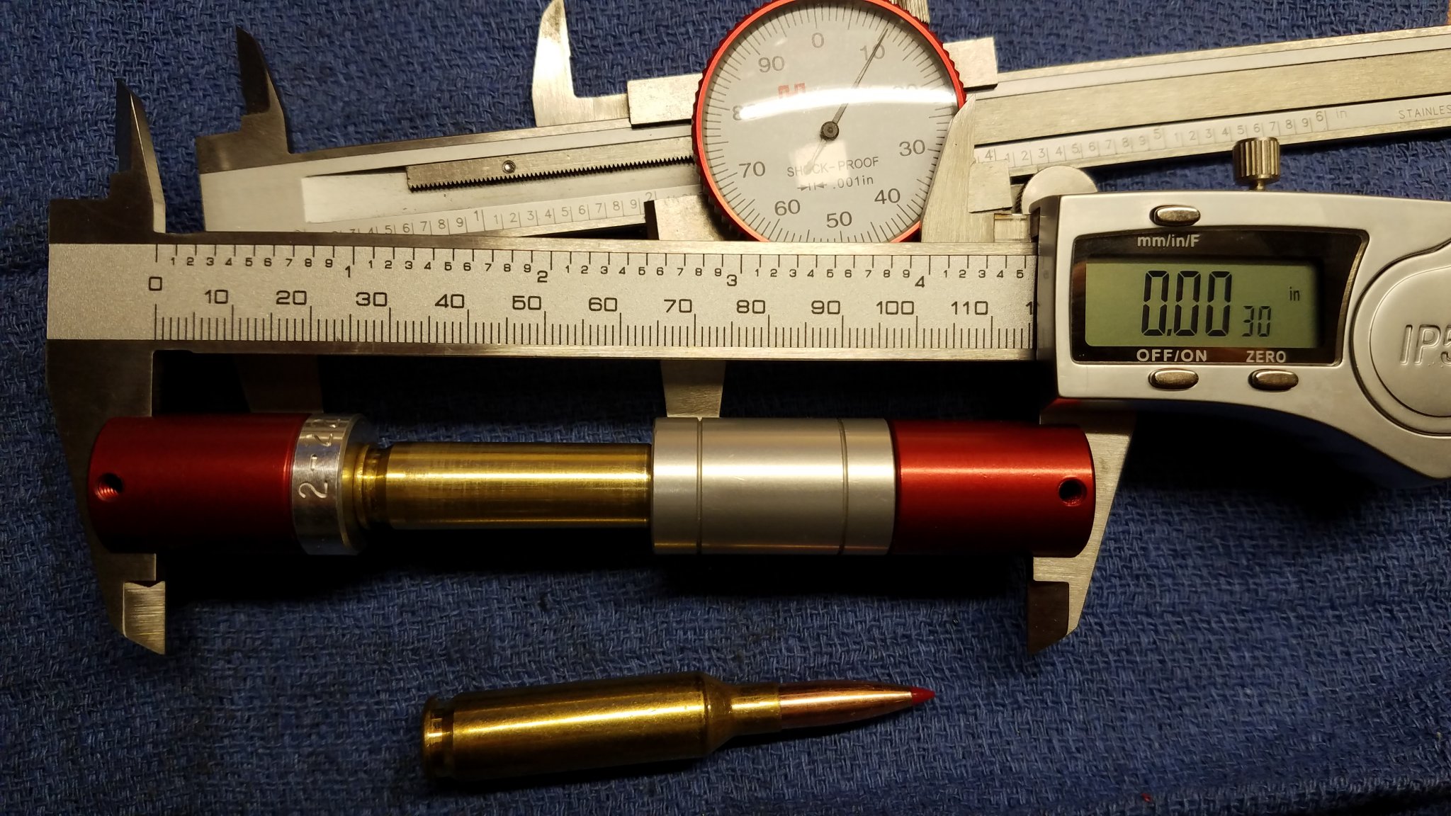

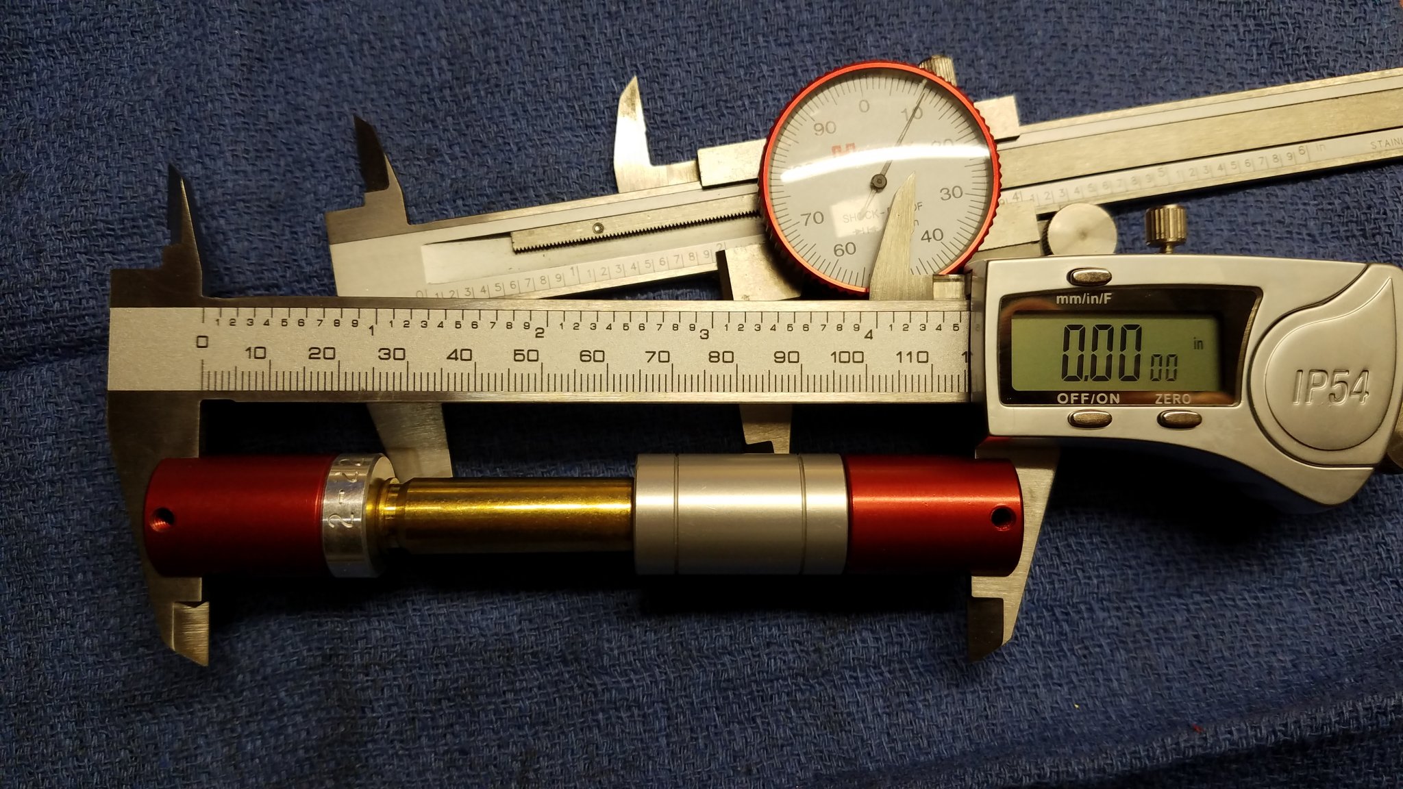

    So I did an experiment and set the die to touch and even to slightly over cam to make sure the case was going as deep as it could. When I compared it to a factory unfired round this was the result.
    Sized Case:
    Factory case
    I'm only using the bullet comparator in conjunction with the headspace gauge as an anvil, or flat even surface, until the actual Hornady anvil comes in.

    Measure a fired and deprimed case, as it will be chamber length. Compare that with yoursized case. How long are the cases that don’t chamber well, from your old die setting?
    No need for an anvil, just use the opposing jaw of the caliper.
    Regarding the vid you saw of the of the shell holders. I’m assuming it was the Redding comp shell holders? Yes they’re taller, but not in the way you think. There’s more material on top, which holds the case further out of the die, in .002” steps. So standard shellholder is the most sizing, and the tallest comp shellholder is .010 less sizing.
    And you never said if the fully sized case chambers properly?
    Edit: I thought I was seeing all zero’s on your caliper...is the virgin case .003 longer? If so, what’s the problem? And by that I mean, back the die off until you get the number you want based off of the fired cases, not a virgin piece of brass/factory round.

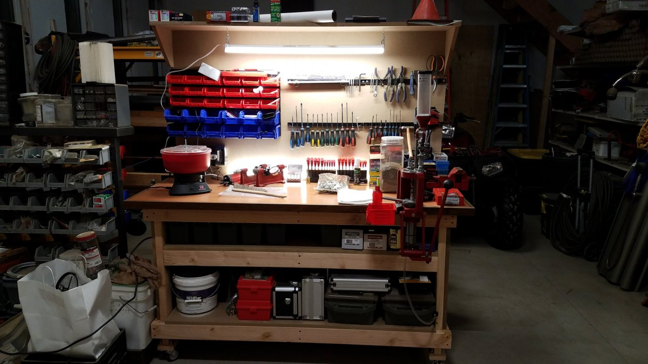

    Some food for thought. I use a Dillon 550 as a single stage for precision rifle. Due to their shell plate set up, in my experience, you will not be able to bump a shoulder back because the die will bottom out on the shell plate before the case shoulder can be set back. I carefully take .040 to .060 off the bottom of the die (making the die shorter if you will) running it on the flat side of a bench grinder. Work slowly and keep the die cool with fluid. Chamfer the inside edge when finished. I can now bump .002 very consistently for the bolt rigs. If this is your issue, the above may help. YMMV

    I posted my response because my take was he’s not getting any shoulder bump/setback at all. I may be missing something though.
    That was what I thought at first too. Either way, a fired case is not likely coming out of his chamber the same as it went in, and if he’s getting the case back down to virgin length, I’d say that’s likely too much sizing. But he’s left out any details of his actual chamber dimension.

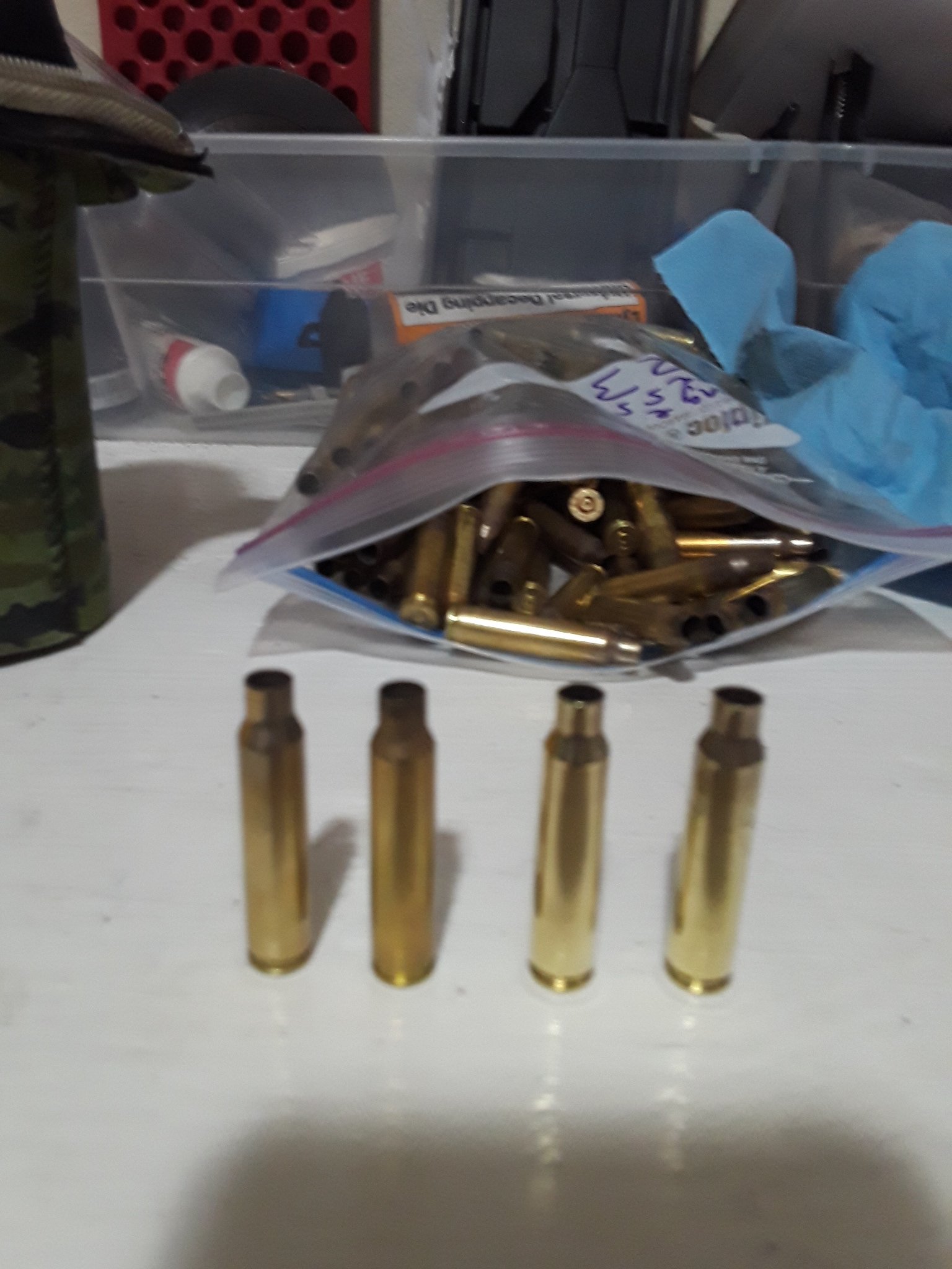

    This was all first fired range brass, I removed the crimp.
    Its pristeen and from a private stash.
    Not formed in any of our guns so I ran them to go in any chamber but not as short as factory loads.
    I was bumping to factory specs in the past by default of die instructions now we have the shoulder comparitor.
    First fired from our guns got mixed in the gassers.
    7042632
    Tumbled on the right
    First fired from our guns got mixed in the gassers.View attachment 7042632
