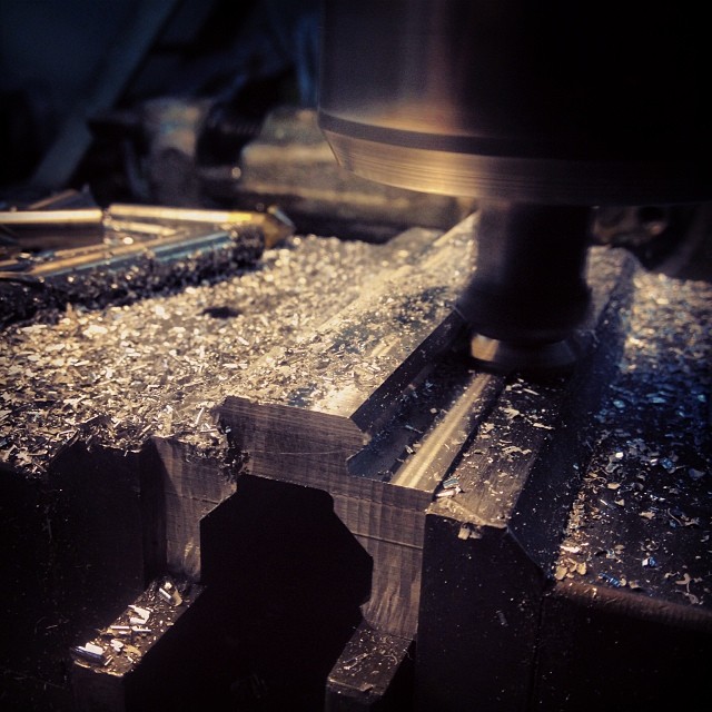

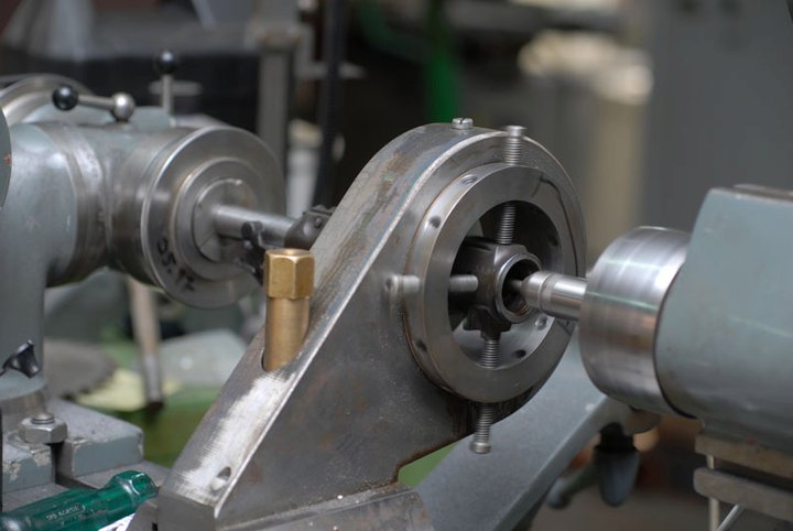

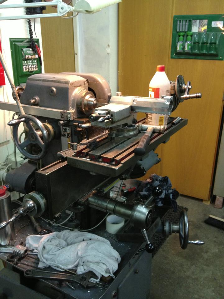

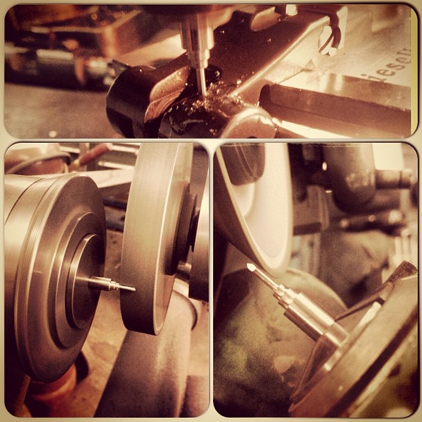

    I have two shops, one production shop with good five axis machinery etc.
    And an old prototype shop where a number of prototypes and a lot of strange odd jobs are done.
    Almost perfectly for advanced gunsmithing.
    I would really recomend you to get some small precision Machines.
    Small lathes with collets and a tool grinding machine to become really flexible.
    With the toolgrinding machine and/or a single lip grinder like Deckel SOE you are normally only 15-30 minutes away from special cutters all the time.
    Here is a few specials I have done.
    All cutters you see here is homemade:)
    The setup in the lathe below is a cutting a torx grip into a special screw.
    the reiciver is in a special set up in the tool grinding machine to have it's locking lugs corrected.
