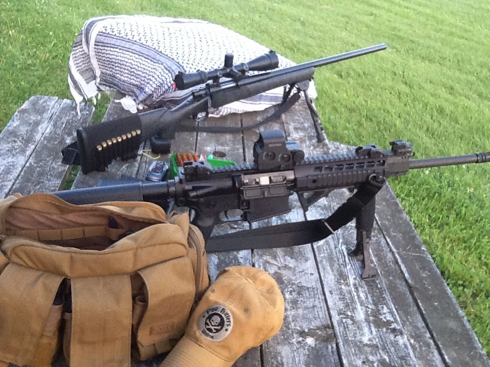

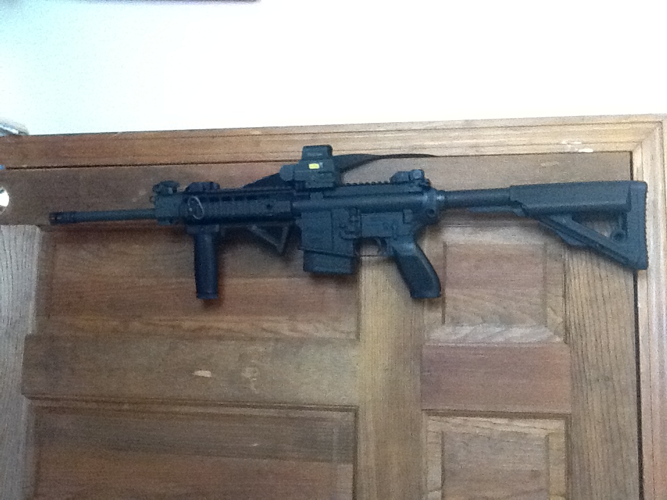

I'm not sure if its me or the gun, but my SIG 716 Patrol seems to have loose grouping tendency.
This is 100yards with 168amax's & 40.5g of 4064
The gun is stock other than the trigger group. The lower group was the eotech the higher group is the stupid fat-posted back up sights.
I feel like something is a little off, I don't expect sub minute from a battle rifle, but I don't expect her to be the least accurate of all my girls.
Am I just chasing my tail here, being unreasonable, or is this just how it is?

Not sure which groups are which, but iron sights or an eotech at 100 isn't how you produce tight groups. Maybe something with more magnification before you draw any conclusions? Your front sight post and your eotech are probably 4MOA. Hard to tell...
Maybe I just suck, but NO WAY could I shoot "groups" with an eo-tech or iron sights at 100 yards. Its impossible, IMO, to hold the same POA with any degree of accuracy. At best, with a 4MOA eo-tech or a 12 MOA(roughly) front sight you will completely cover any bull and possibly the whole target.
Get some glass on it, even a cheap scope with a simple cross hair and maybe 8-12x magnification, and you will be able to actually hold the same POA at 100 yards.
When I built my SPR with top quality components I was chasing my tail doing load development with a 1.25-4x Leuopold. Once I put the 2.5-10x Vortex on it, everything came together since I could actually make out exactly where I was holding at 10x and 100 yards.
Now for actual real world, poking holes in man sized targets or 2 MOA sized steel targets at distance, yea a WAY lower magnification works, but you also arent trying to stack 5 rounds into the same hole.
