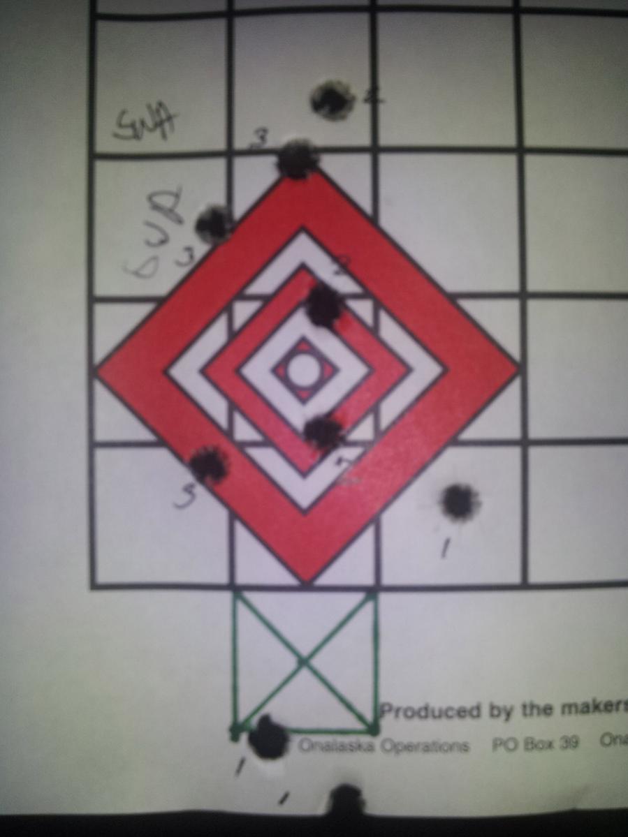

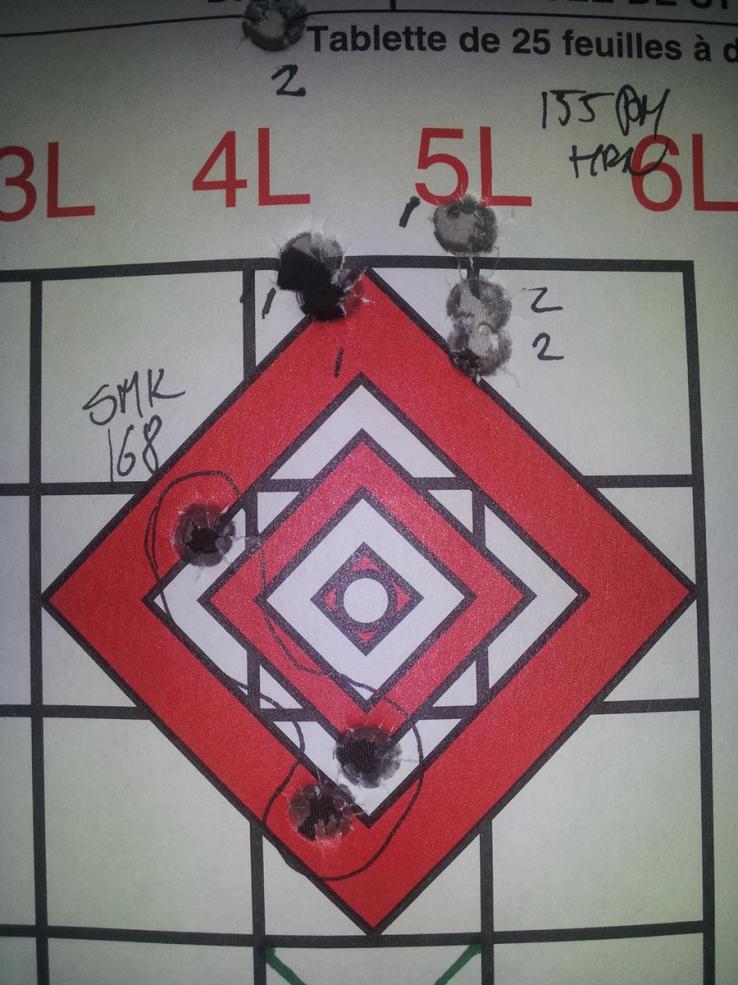

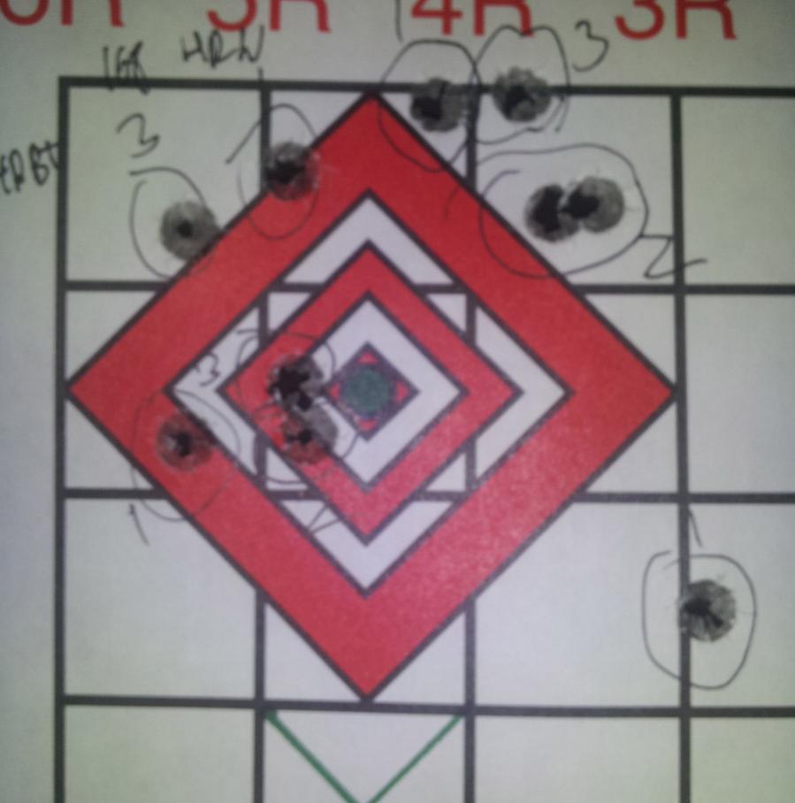

Need your help on interpreting these results, please. My set up is Sig-716 with USO 1.5x6 DFP scope. I'm shooting off a bench with sandbag under the front and butt-stock.
Loaded 3 cartridges of each to see what kind of grouping I can get and see what my rifle prefers. As you can see in the grouping that I would get 2 fairly close and the 3rd would end-up 1MOA apart! What gives? My rifle is zeroed at 200yrds, but this target was at 100yds and I aimed 2" below the "X". The rifle has about 300 rounds through it, with no issues what so ever.
My question.. Is it me? Is it the rifle? Is it the scope (all is tight). Could it be the last round causing it round to fly that much off? Any suggestions, constructive criticism, opinions are welcome. Thank you for your help!
155gr Southwestammunition.jpg155PalmaHrnand 168SMK.jpg168AmaxHrn.jpg168HPBTHornady.jpg
Dracozny-Hover your mouse pointer over each photo and you will see the ammo specs. All factory new ammo, The SouthWestAmmo are reloads. It seem that no matter what I shot, I was getting one of the 3 way off. Thanks for the feedback.
First, when going for tight groups, zero the scope for the range you are shooting so you can hold on a very specific aiming point and eliminate any ambiguity in where you are holding. Next, if you don't know if it's you or the ammo, then it's probably you because you should know if it isn't. So, get someone who you know can shoot and see what their results are and you'll have your answer.
What Newtrick said...If you are loading just 3 at a time in the mag the recoil impulse is different on the last shot due to the bolt not going back into battery and being held open. This is of course if the errant round is always the last shot of the group.
Thanks eeveryone for the suggestions. After I left the range I thought of loading 4 and shooting 3. On my next outing I'll do that and see if it makes any difference.
Most of your groups are stringing vertically. That is usually cause by not having you check weld in the same place shot to shot. My brother had the same problem with his 700 SPS tactical until he corrected his non consistent check weld. The horizontal displacement your getting could be the load or perhaps you are inadvertently torquing the trigger. Last it could be the scope.
Thanks Samnev for your suggestions. On my next outing, I'll be paying more attention to see if t helps and/or improves my issue. Can you please explain "torquing the trigger"? My technique is to pull it towards the back in one smooth pull. After it fires, keep it held back, let the gun settle, re-aim and smooth pull back. Thx
If your pulling the trigger straight back as you indicated your are not torquing the trigger which means you are pulling it slightly to the left or right. Since you are following thru and pulling straight back that is probably not the problem. One trick that I used to help friends who are experiencing problems is and load the rifle with them not looking to se if there is a round in the chamber and let them pull the trigger. Many times it became very evident they were suprised to see the rifle move even though their was no cartridge in the chamber.
I still believe check placement is the biggest problem. With my 716 I find check placement a follow thru is critical. Much more so than my bolt action AIAW. By the way what ammo are you using? To eliminate this variable consider buying a box of 168 grain Federal Gold Metal Match and see how the 716 shoots if all else fails. Hope you can resolve your problem.
I do practice dry-firing to make sure nothing moves when I pull the trigger. I do have few boxed of 168 Federal SMK's. The best groups I got were with Hornady 168 and 155 A-Max's If you hover your pointer over the photos you will see what shot in the photo names. Cheek placement could be the problem. Although I try to be as consistant as possible. I'll try narrowing it down on my next rip to the range. Thanks for the response!!!

Can you show us groups you've shot with other .308s? Not trying to talk down to you or anything, but if you're just getting started - which some of your questions and comments indicate you're at least a little new to this - the default assumption should not be that the rifle is at fault.
As has already been stated, holdovers are good for field shooting and whatnot, but not the best way to shoot tight groups.
If we had a frame of reference for what you can do with a rifle that is known to perform well, that would make it easier to root out what is human error and what can be blamed on the rifle/ammo.
