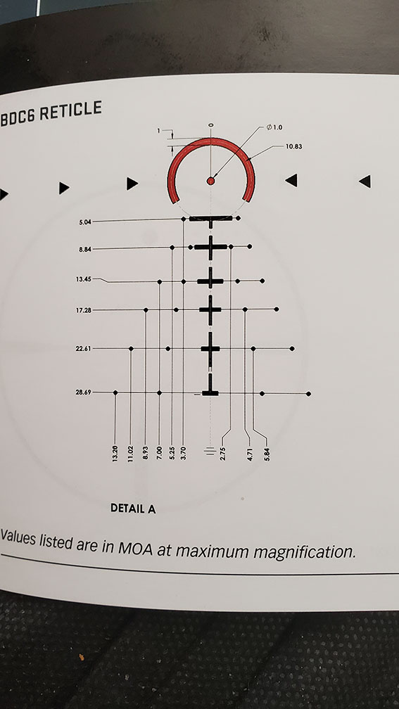

So I have a Sig Sauer Tango MSR and looking through the manual, there is no mention whatsoever to as of what distance the scope should be zeroed to properly utilize its BDC6 reticle ranging capabilities shooting 5.56/223. All it gives are MOA values. Does anyone know how to make sense of this?

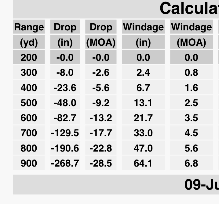

With my 14.5 and 77 tmk handload and elevation and all that jazz a 200 yard zero will give me first line 400 then to 900. It’s a close enough match for me. Played with all sorts of zero distances on JBM and this gives me the closest match to making each line work
