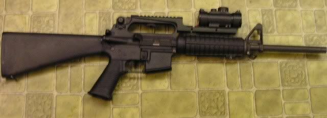

    Went from this
    to this
    I am just waiting on a better trigger so I can unlock its true potential. I got a decent blasting load with 55 FMJ and a target/coyote load with the Hornady 75 BTHP sorted out. That is if I exclude my fliers presumably from the gritty 8 pound stock trigger, both of those look to be 1 moa or a little tighter. I will put a more appropriate scope on it after I confirm my loads with the new trigger.
