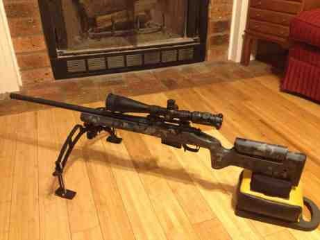

Here it is set up, after the match. ImageUploadedByTapatalk1374970090.396915.jpg
