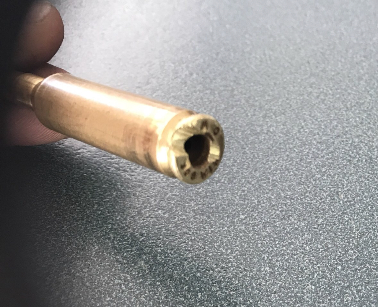

Cheat! I didn’t take my ejector out either but I did a work around that made it easy. I did destroy a case tho but I got a repeatable reading that I’m confident in. Worked a treat! Just make sure the dummy round has low runout or that can give false readings.
