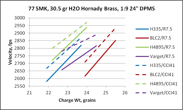

I'm in the honeymoon phase with my Magnetospeed. These are some pressure/velocity ladders I shot last week. The actual velocities were fit to a line to clean them up.
Old 24" DPMS 1:9 barrel. 2.260" OAL, 2.280" to the lands with the 77 smk. Depending on the powder, ~2850 fps seemed to be 223 max pressure, 2925 fps for 556. Might get 3-4 loading at 2850, one and done at 2925. With a 16" barrel Quickload gives 2610 and 2680 fps for the limits.
I've used the 24.5 grain Varget load with Remington 7.5 primers for a few years and it works well. It looks like H4895 is going to give more velocity without a compressed load. BLC2 was the tamest for a given velocity by far. I was surprised at the pressure/velocity differences between the primers.

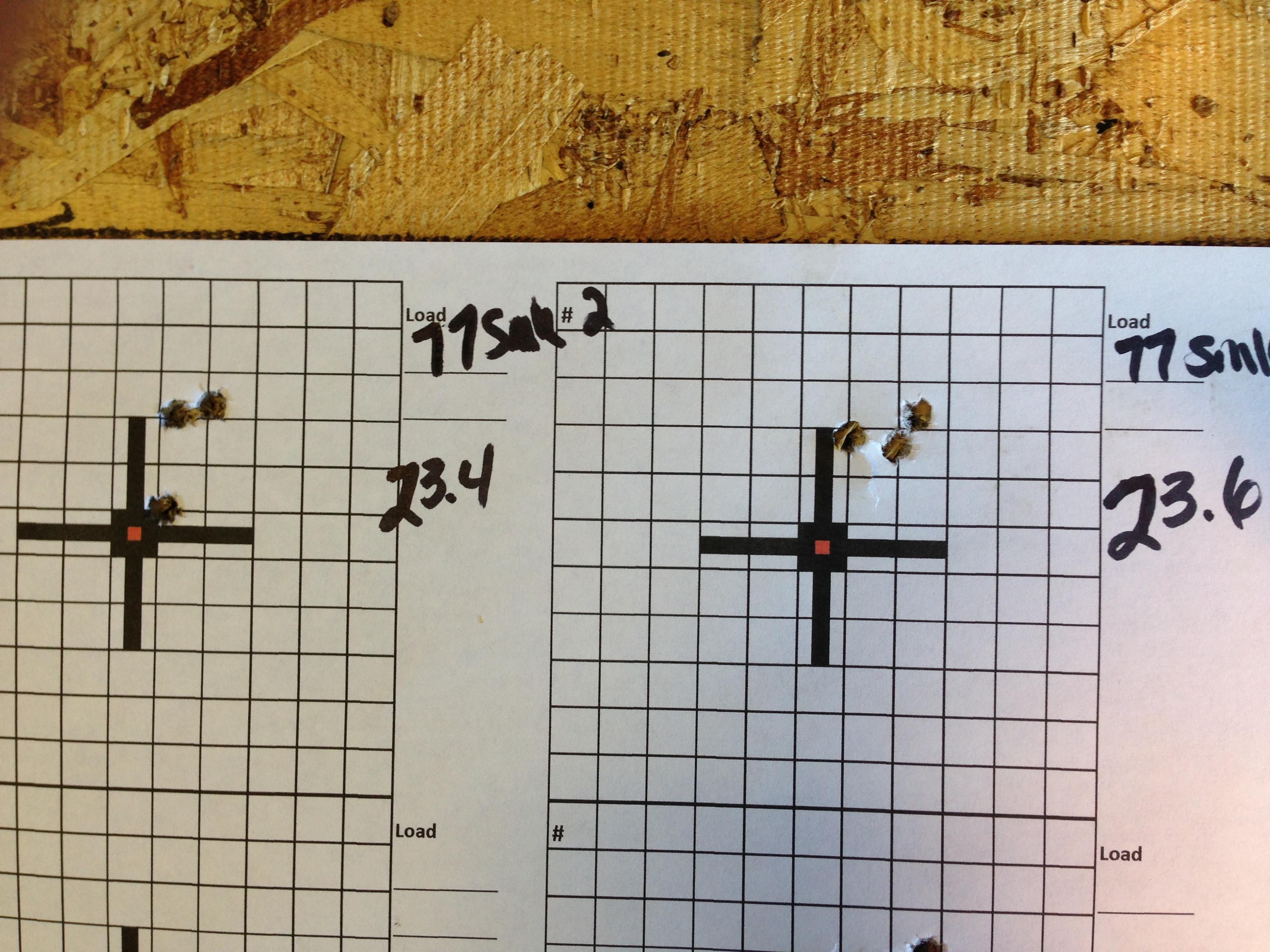

So, I thought I post this here since I followed your info. Thank you for posting all this, you probably saved me a few primers and a bunch of powder. Anyway, here's what I got on my initial OCW with 77smk and 8208.
I was initially going to run 23.4 to 24.2, but I bailed on 24.2 due to flat primers at 24.0.
Data:
LC06 1x annealed, weighed to within .5gr
Fed 205M's
8208XBR
77SMK's weighed to exactly 77.0
Seated to 1.853 Ogive
No chrono…:mad:
Rifle:
Black Rain w/18" WOA 1/7 SPR mag fed, shot round robin
3 each, 23.4, 23.6, 23.8, 24.0
Top row only
I know they're only 3rds, but the last 3 groups all measure .5 with 24.0 being .41
I wish I knew the speed!!! Anyway, I think I'm gonna load up 5 of each, 23.8-23.9-24.0 and try again. I may be able to borrow a buddies chrono on Wednesday(i hope)
Yea your right in the node. Would love to know your speed with those loads. Think I got a slow lb of 8208. Picked up 4# a few days ago that Im gonna test.
