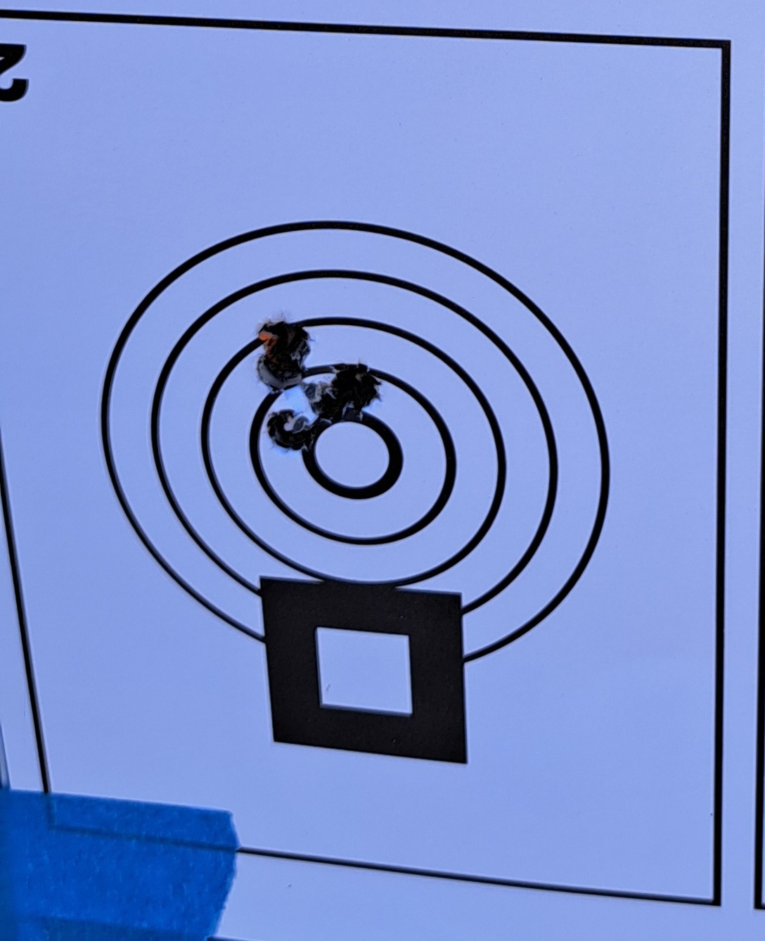

I think I have a bad barrel. 🙄
Proof 7.5tw, 22", chambered in 6-BR.
Shot from a rickety wooden bench with a tail wind.
5265 rounds on the barrel.
I demand a refund!!!!
