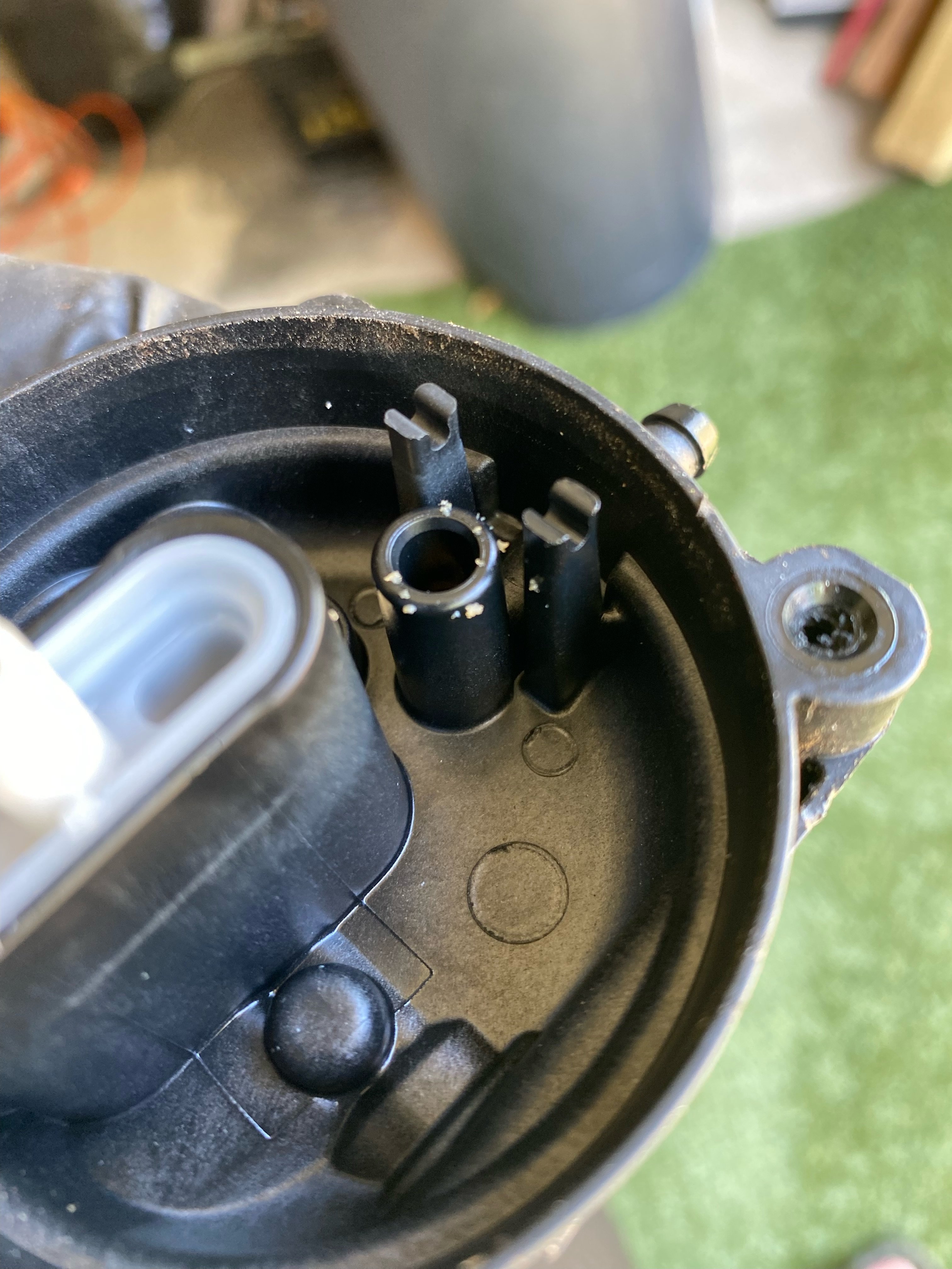

Yes pull float and needle valve, Blow out all passages, confirm nothing blocking the main jet into the venturi. Some modern carbs have more passages you can access that do get clogged but require further disassembley. If it doesn't act right when you re assemble, might require more in-depth cleaning.
A plastic carb from a brigg 140 I did for a friend earlier in the week. Obvious white debris.
