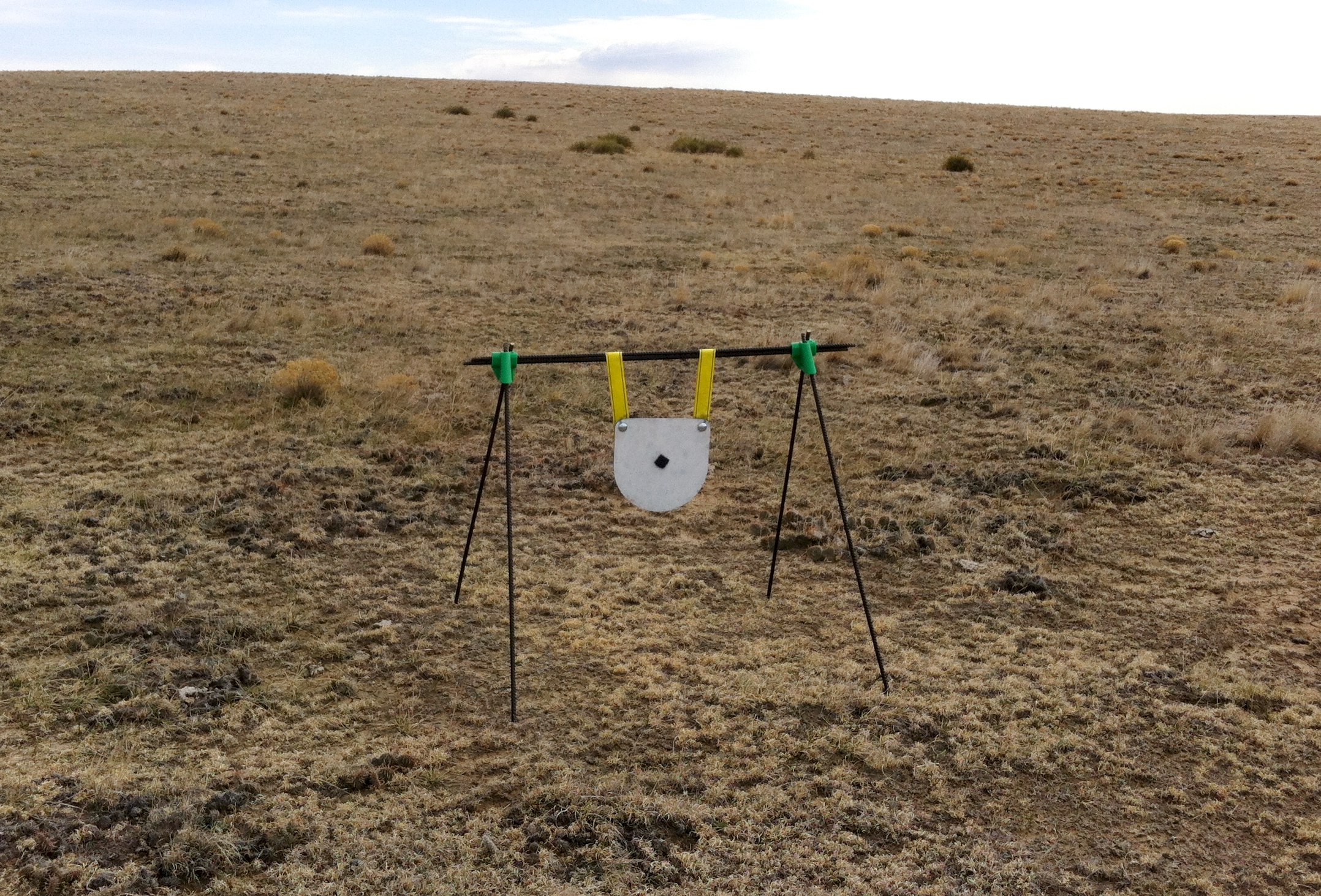

    We really like to use rebar target stands. We sell them in sets, in either 1/2" or 3/4" inside diameter. 1/2" is most popular and fits standard rebar that can be had at the hardware store of the junk yard. I like 4 foot lengths on the rebar.
    We also include a set of grade 8 hardware, and a strip of conveyer belt. Hard to be for $24.
    Here is a pic, just a standard 12x12 AR500 target, getting beat up pretty good.

    We just use it because we can fit a bigger pipe in it to be more heavy duty. The legs we use for the spinner and KYL rack is a precision .750 round bar. So its pretty strong, and high quality, but it costs us quite a lot, almost $3 a foot for that stuff because its a true .750. And that's what we like for out .750 SS bearings on out spinner. We just decided to use them for the KYL rack to keep quality of legs high, and the entire unit is very stout. Does not shake, move, etc when a target is hit.
    When I am hanging one single target, like a 12x24" or 12x12, or 66% IPSC, I always go with the 1/2". Its plenty strong, and just plain works.
    I have had a time where I used the 3/4" rebar stand, and had an 8 foot cross bar, then I hung 5 targets up at one time. That was a blast as well. Poor mans KYL rack at its best.

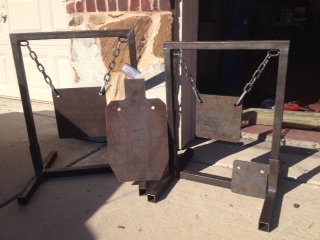

    Heres one I made recently. The uprights fit into the legs and it breaks down relatively flat
    Those look really nice, but unfortunately I have no access to a welder...

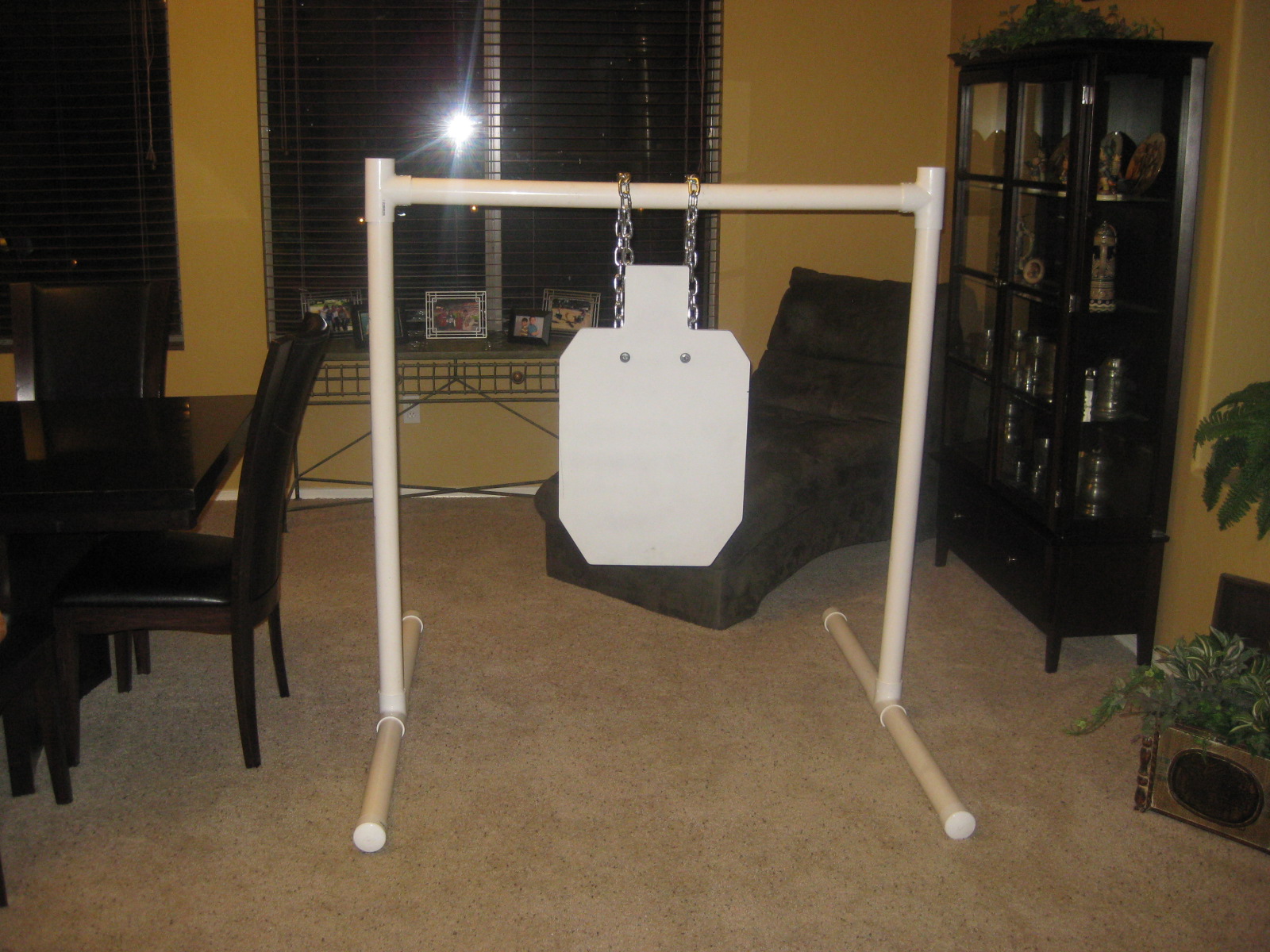

    I used 2" pvc tubing. It can be assembled in less than a minute without the use of tools, it fits in an old tent bag, it cost 30 bucks to build, and if it gets shot it can be easily replaced with another tube in seconds.

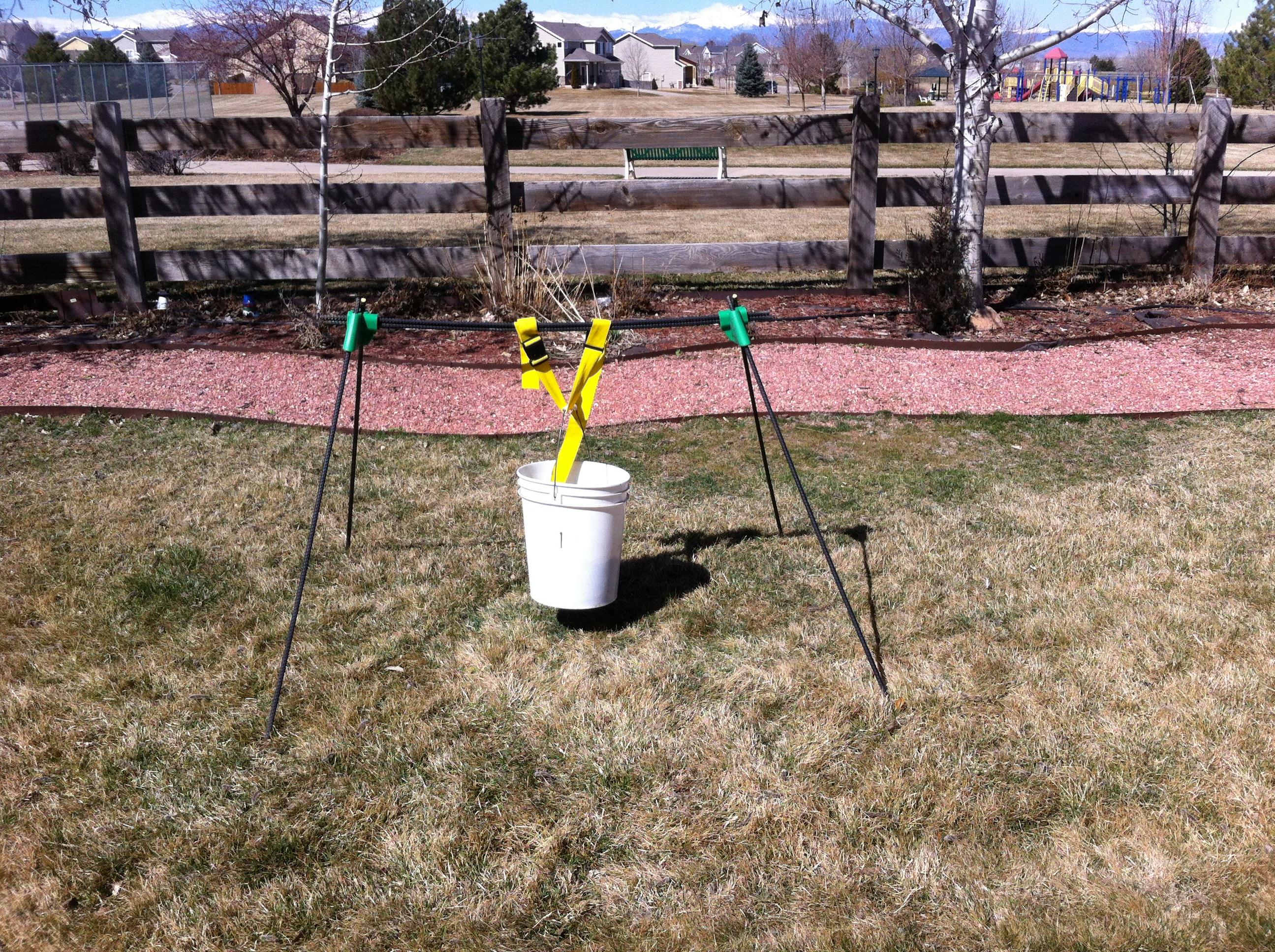

    Along the same topic. I just tried out a set of "last stand" rebar stand keepers. Not bad, not bad at all. 12" AR500 plate took 308 hits at 300 and 500 and did not tip over. Best part is how light everything is now. Need to wear good gloves though, because the copper jackets stick in them from the plate splash. All-in-all thumbs up. pic is shooped a little to remove personal info.

    Not sure as I have not weight tested it. The rebar for the cross section is double, as to not sag. The gong in the pic is a 12", I will test it with more weight to see what it can handle.
    Edit:
    Weight tested and the most I would go is 55 lbs. Weird how weight jumps. I have a 3/8 12" gong and its only 13 lbs.
    The stand holds 70 lbs but you can see the strain. I put 90 lbs and it was a no go. The stand wants to fall left or right.
