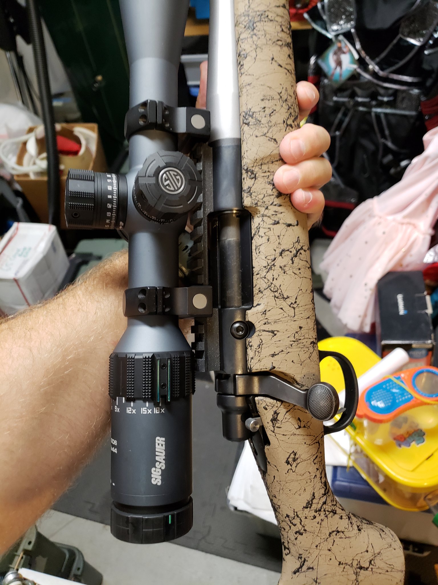

    How abt posting up some pics of the rifle? I too have the Remington UML and have been debating on doing this very thing to mine. Give us a spec breakdown of it also if you don’t mind. Thanks man

    Sorry I was self isolating in Lake Havasu with about 10,000 other people!
    Spec wise, simple R700ML action, Brux Barrel , I need to look it up, Timney Trigger, 1/28 twist, and HS Precision stock
