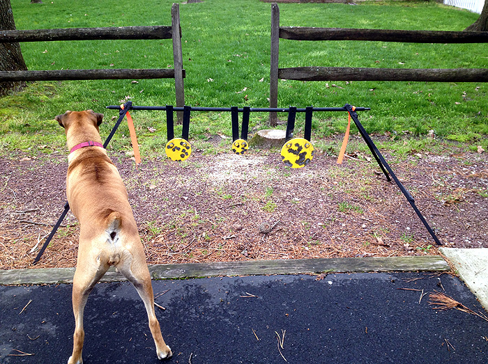

Accuracy is my goal. Not sure if I want to get F-class crazy but under .5MOA or better would be nice. I shoot steel plates mostly @ 300yds. 4", 6" and 8".
