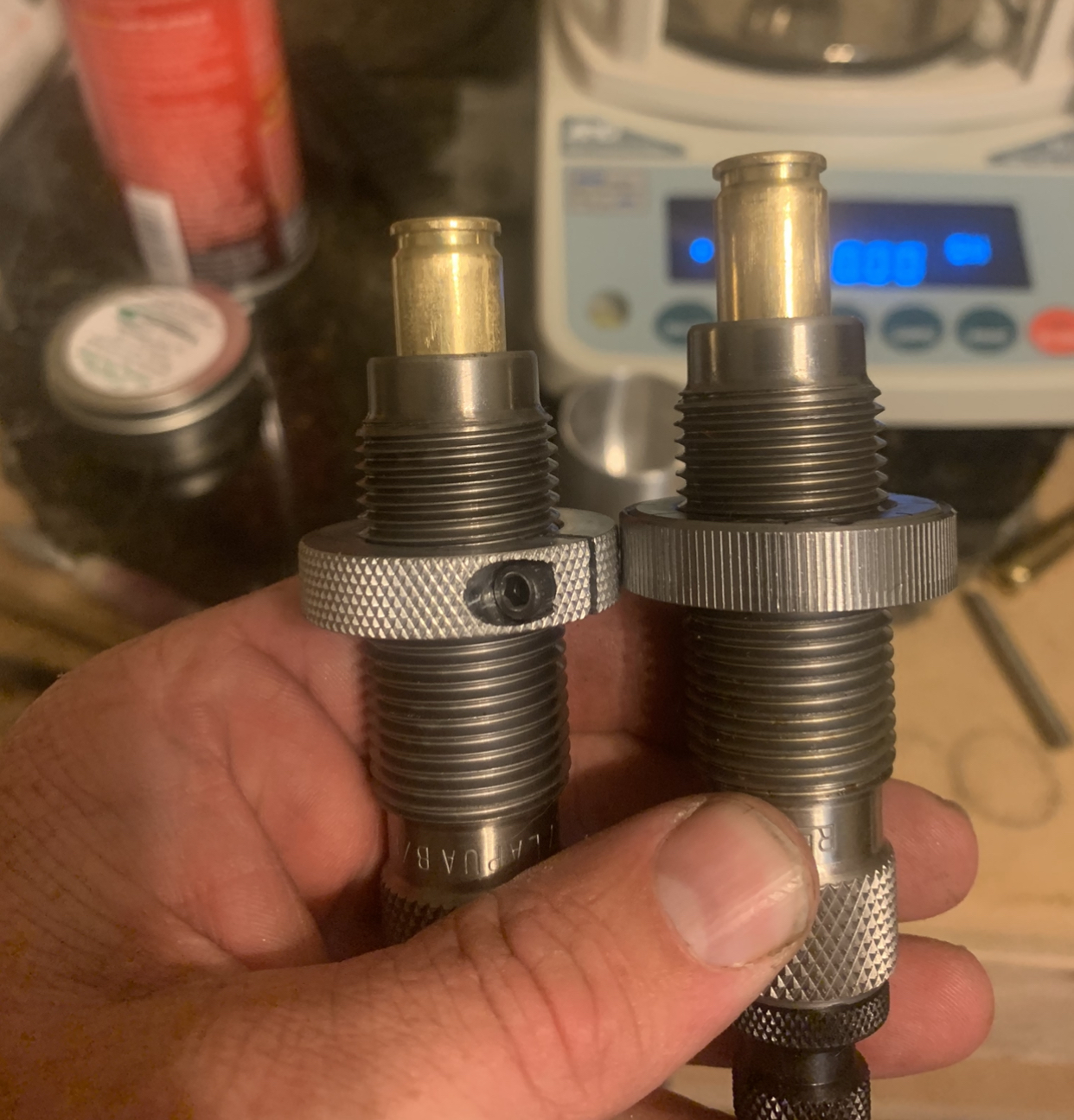

Ya, definitely not all created equal. Here is a 6.5x47 and 6x47 die, both made by Redding. The case body should be more or less the same as 6x47 should just be necked down 6.5x47.
But the 6x47 was much tighter. Ended up just using the 6.5 with appropriate bushing.
I can show you a picture just like that except the dies are the same caliber by different manufacturers. It does make a case for custom dies doesn't it?
