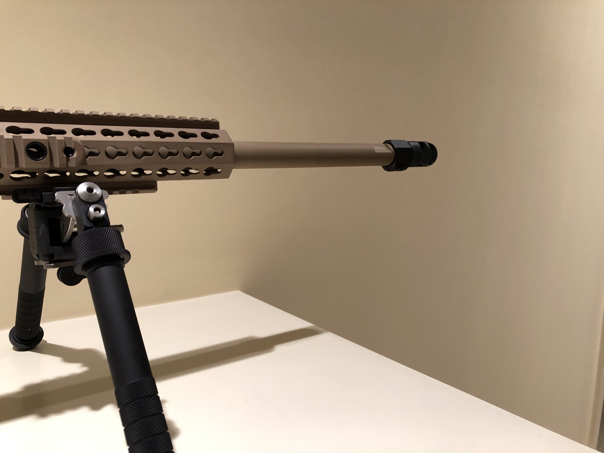

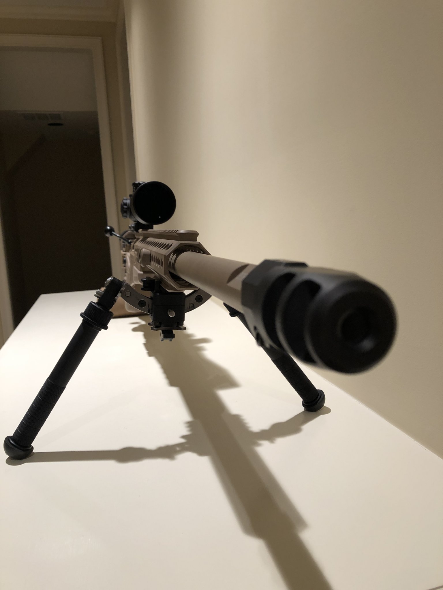

Gun is back and the barrel is thicker for sure, but nothing crazy. Installed the AI competition trigger while I was at it. Hopefully will have some groups this weekend...

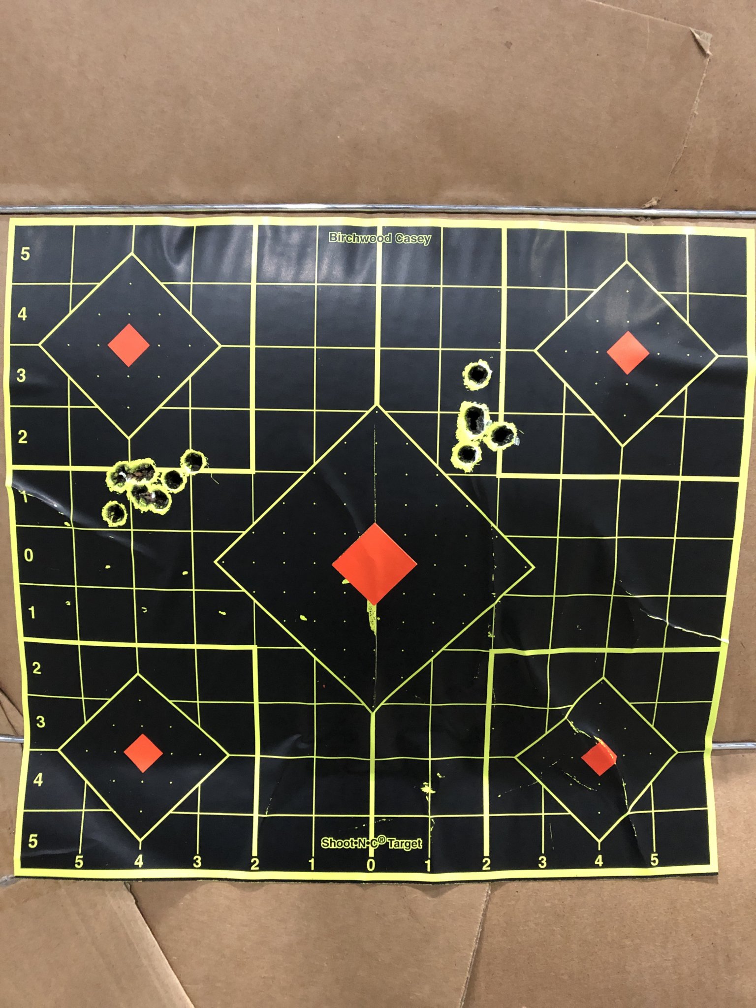

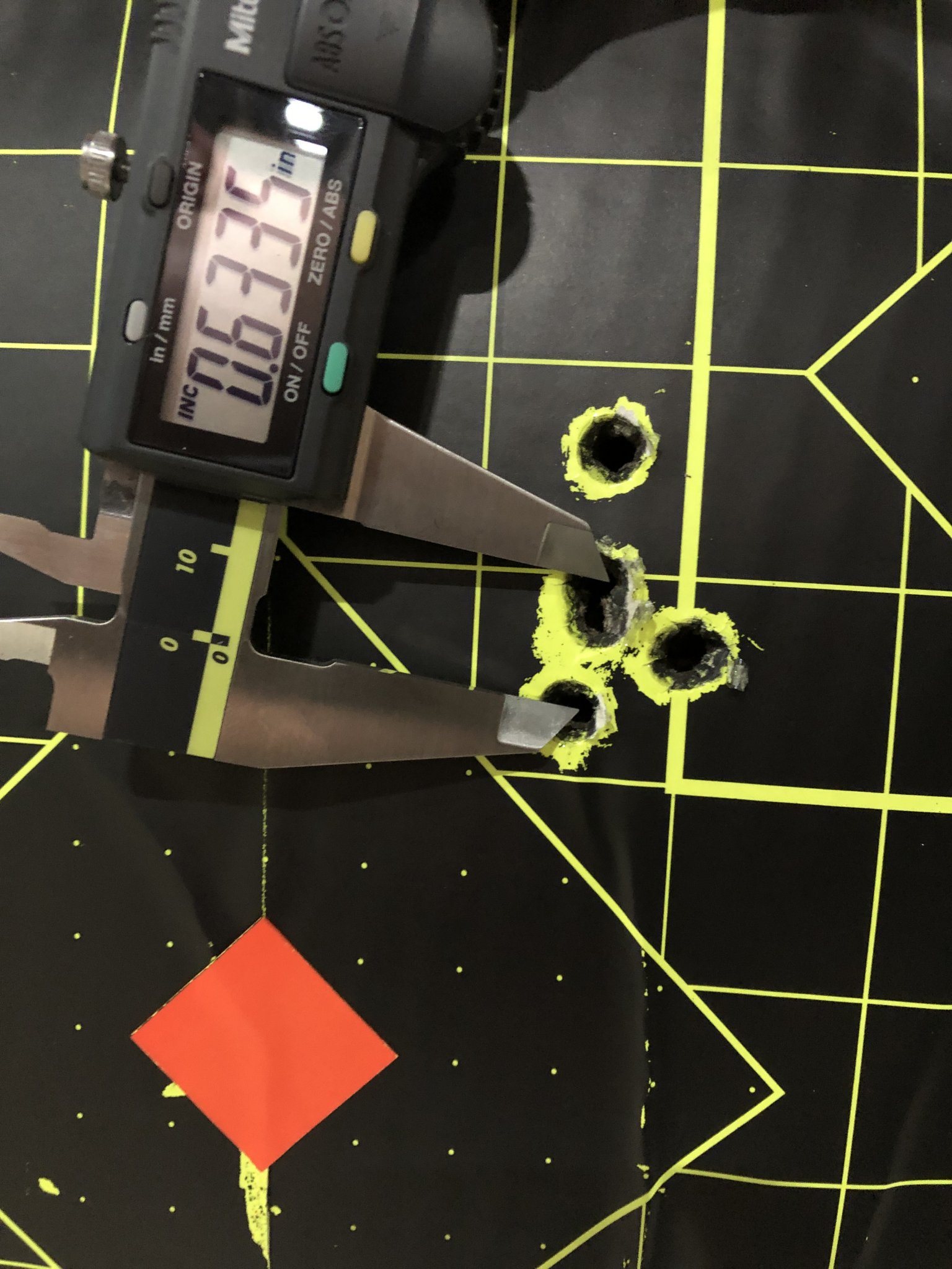

Well she shoots better now. Shot a fouler shot since they had cleaned the barrel before shipping (round above the 5 shot group on the right), then punched 5 shots into around .6 MOA. The surprising thing is the 5 shots of factory Lapua ammo spit out a 10fps ES at about 60F but I know in the 90+ temps the ES opened up to 45fps on the old barrel with Lapua ammo.
Left group is a ladder test of .2 increments from 87gr to 89gr. Barrel is producing better flat spots as well. From 88.2 to 88.8 gr, there was a 14fps ES.
Final results are in:
Unfortunately I only made 20 rounds because I didn't totally trust my reloads but after the fact, I think I am good to go now...

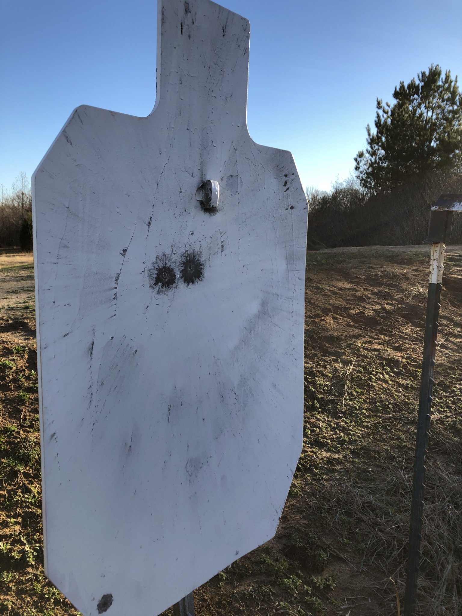

It was still shooting .5" groups at 100 yds, I laddered out to 570 then started to jump big in distance, this is the 2 shots at 570:

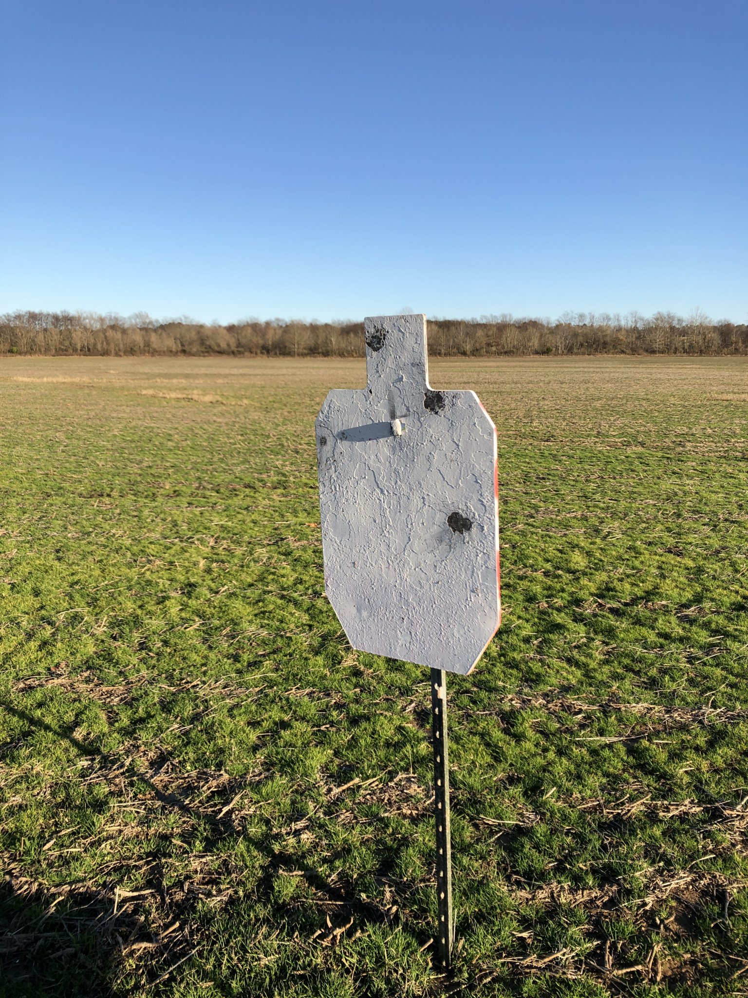

Then I went out to 1,067yds to do some velocity and BC truing. I had to increase both a little, because I was hitting high in relation to point of aim. I was not intending the first shot to hit the head, but it looked cool at least. Finally got the elevation dialed in on the torso shot. Wind was a huge factor today. Consistent 8-12mph wind with gusts hitting up to 20+mph
