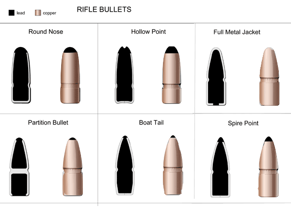

I think youre blending lots of different terms together.
The round nose, the hollow point, the partition, the boat tail, the spire point are all "soft point" bullets. They have the soft inner lead exposed which allows for quicker expansion. In this pic none of them are solids, they are all lead cores with copper jacket however the FMJ doesnt expand similar to how a solid doesnt expand as much.
Solids can have the same sort of design features, they just do so without the lead core, usually its entirely copper or brass (Ill get to solid lead later). Typically people like solids for extreme long range as you dont have lead inside the bullet that can get disturbed or uneven. They are a solid piece of metal so there shouldnt be any discrepancies in bullets internal balance and so on from differing materials. Its easier to machine something out of a completely perfect solid material than it is to try and make a completely perfect bullet by mechanically casing one material inside another.
So typically the solids dont expand as much... unless they are designed to expand.

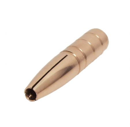

Here is a solid bullet... only it has the open hollow point style tip to expand easily.
So really your choice is not between two things but two choices between four things.
Conventional lead core copper jacket bullets can both expand (the soft point, hollow point, partition, spire point etc) or they can not expand (FMJ).
Solids can both expand (makers, lehigh) or not expand (warner flatlines).

The Prvi Partizan ones are the round nose ones, based on your chart. That's my fault, I should've been more specific in what I said. All of my current firearms (excluding my shotgun) either fire their respective military-issue cartridges in FMJ or else use a round-nose flat-point solid lead with no jacket of any kind, and I've never thought to feed them with anything else (my USGI 1911A1 does not like HP, for example), so this is a new concept for me.
I think I understand now but let me see if I have it right from a usage standpoint. A round nose or a spire point is good for white tail deer through big antelope, is usable on animals like bear or buffalo but may not penetrate or expand as well as I'd like. A solid brass is good for dangerous game where I want to make sure it will penetrate and expand correctly, is usable on less-dangerous game but may be a waste of power and overpenetrate or not expand as well. A solid lead will penetrate and expand fine in most circumstances but not the best option against certain animals (i.e., Cape Buffalo). That about correct?
Which, then, of those four selections (conventional round nose, conventional spire point, solid brass, or solid lead) would be best for target shooting? I think for that I should lean towards the conventional round nose or the solid lead.
