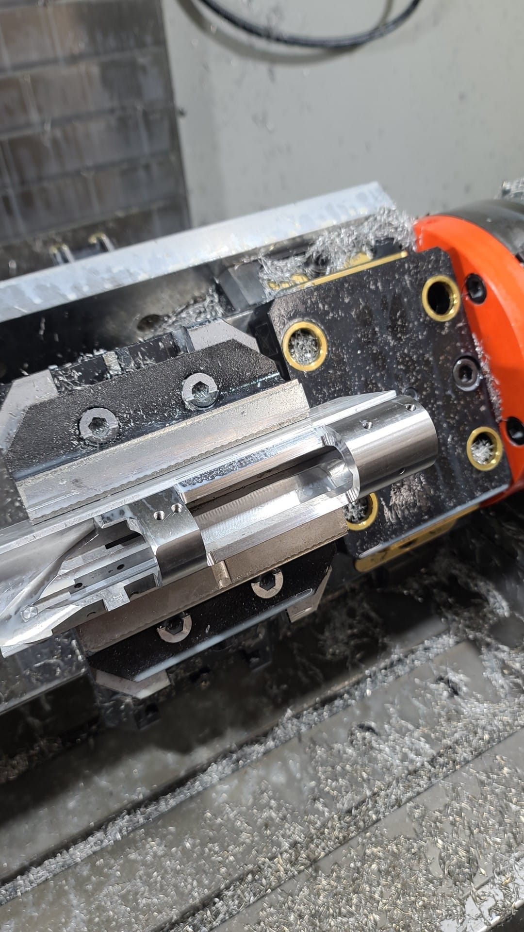

    This is just a sneak peek of what we've been working on last few days. First, a little history:
    Prior to Remington imploding, the Custom Shop was down the street from me in the Dakota Arms/Nesika building where I worked years ago. In December of 2020, the RCS liquidated a bunch of their inventory and I was lucky enough to be able to buy some of it. A bunch of Model 7 receiver bodies was part of that purchase. They've been sitting on the floor here ever since and I'm basically tired of looking at them. (So is my accountant, lol)

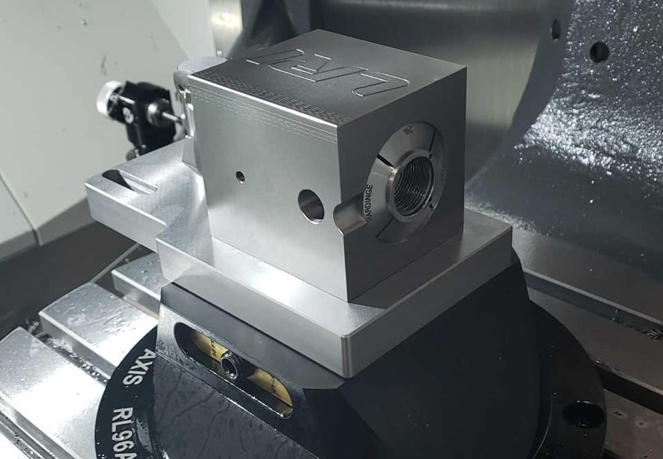

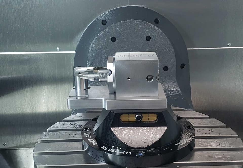

    This week I had enough. I had my "blueprinter guy", Derek start working on them. Here is what we're doing:

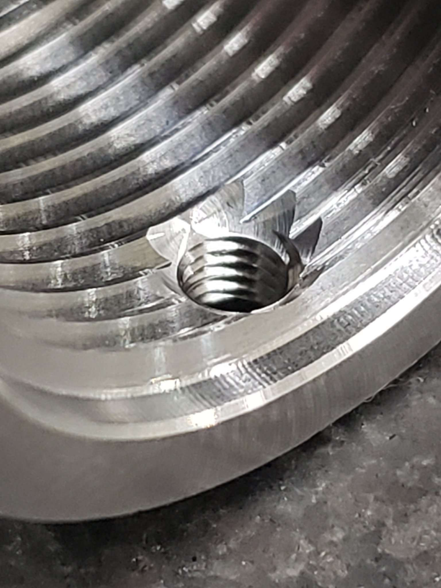

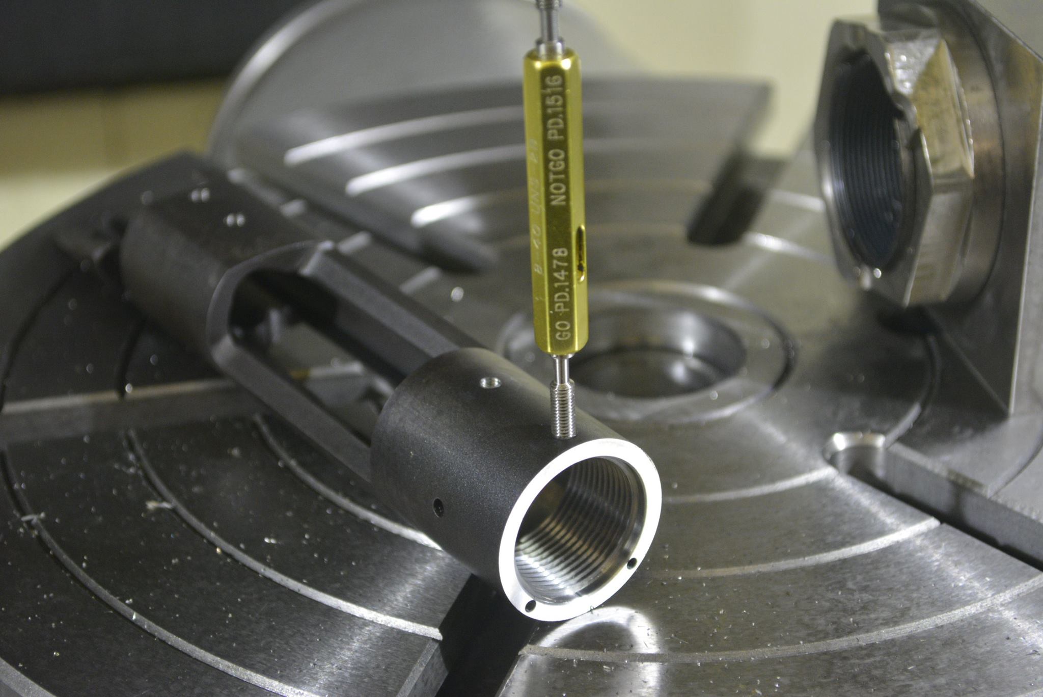

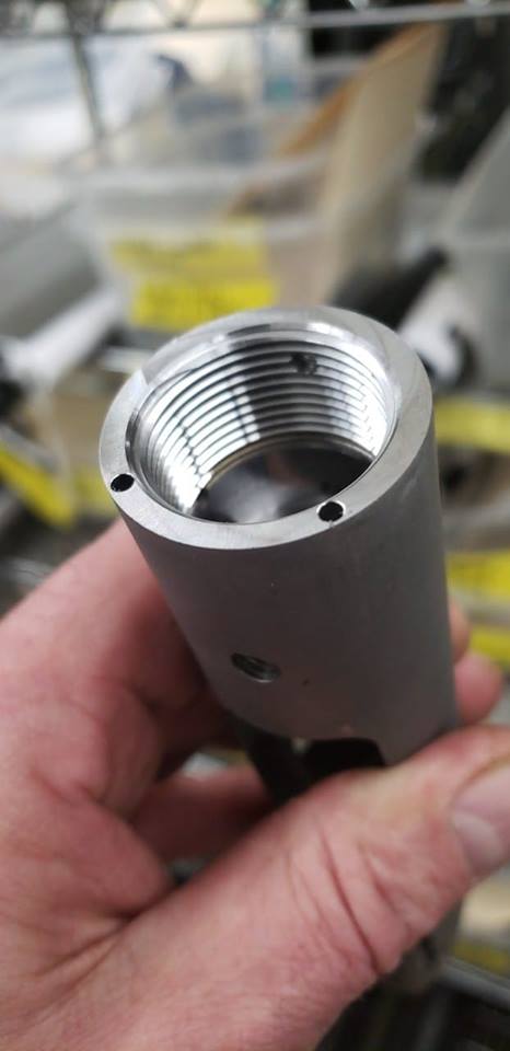

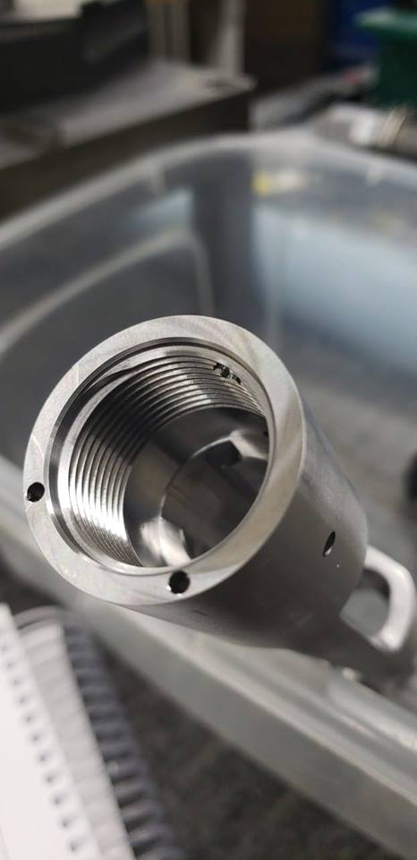

    LRI Tier 1 CNC 5 Axis receiver blueprint service:
    • 8-40 base holes, 4 hole pattern
    • Rear tang hole opened to from 8-32 to 1/4-28 so that it matches the front screw
    • Ejection port resurfaced so that it doesn't look like it was cut with a belt sander
    • Receiver ring threads altered to 1.085-16
    • Higbee lead thread modification
    • Internally chamfered front scope base hole
    • Drilled for LRI pinned recoil lug
    • Receiver ring face resurfaced
    • Lug abutments resurfaced
    • Single stroke diamond-honed receiver bore

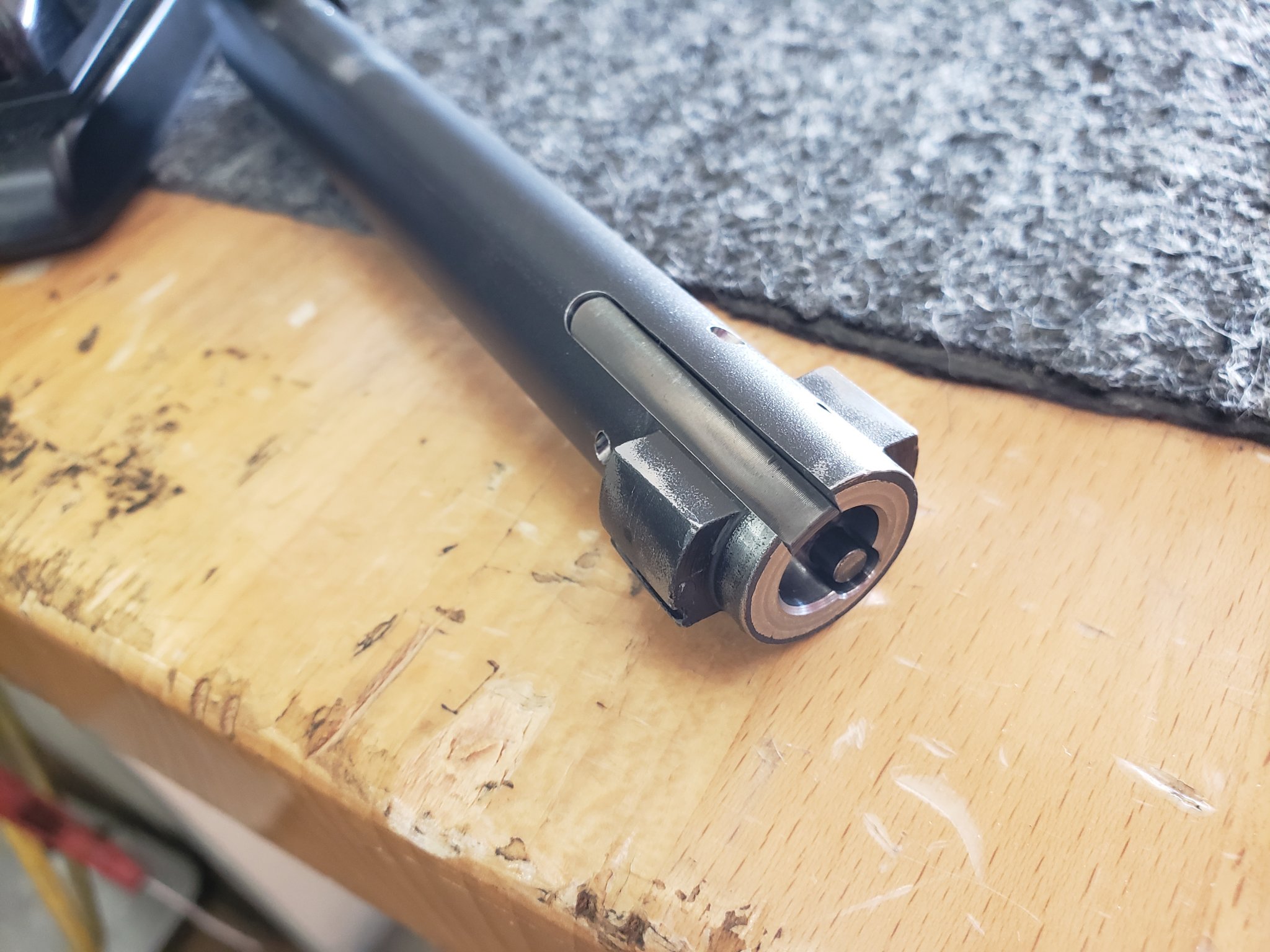

    That covers the receiver body stuff. I have well over 100 of these things. Bolts however are a different story. When this purchase was made Rome was burning so it was literally a grab what you could situation.

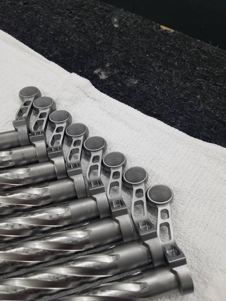

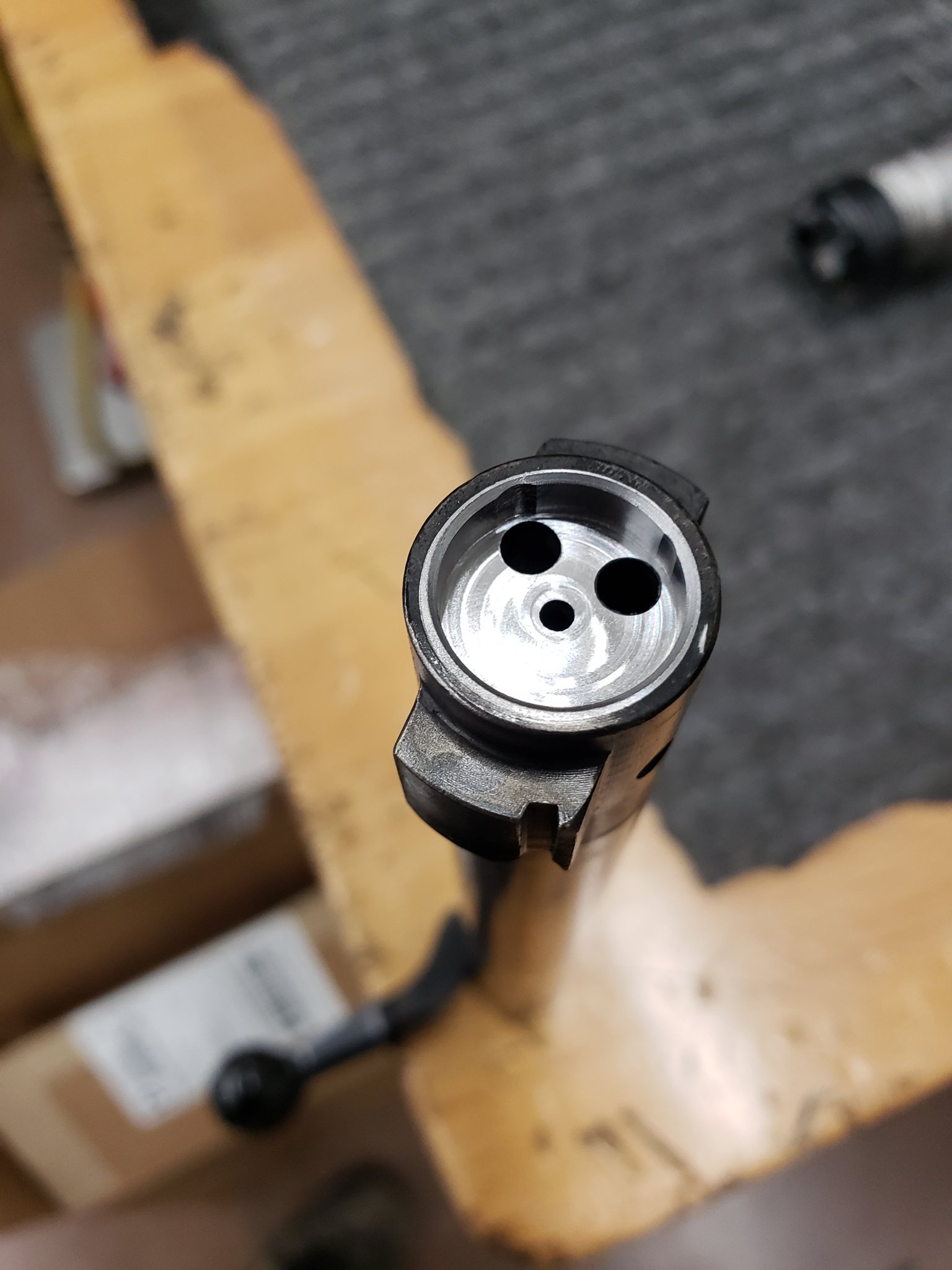

    The bolts that we do have will get the following:
    LRI Tier 1 CNC 5 Axis bolt blueprint service:
    • Bolt nose resurfaced
    • Bolt face resurfaced
    • Forward side of lugs resurfaced
    • Rear side of lugs resurfaced
    • LRI M16 extractor install
    • Threaded/induction soldered bolt nose bushing to whatever cartridge size the CST asks for
    Elective options:
    • Bolt fluting
    • Faceted bolt shroud (CST supplied)
    • Dual ejectors
    • Tac knob installs
    • Time/Tig bolt handle
    • 40x Time/Tig bolt handle upgrade

    Thanks for looking and keep an eye out here in a week or so. Photos are just random pics I uploaded that detail what we do here on receivers and bolts.
