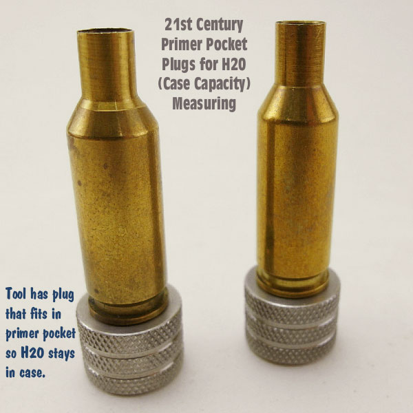

Even better would be to weigh them with water or alcohol. Use this to plug the case, put it on the scale and zero. Fill it up with water and then you have the weight of its actual equivalent internal volume.

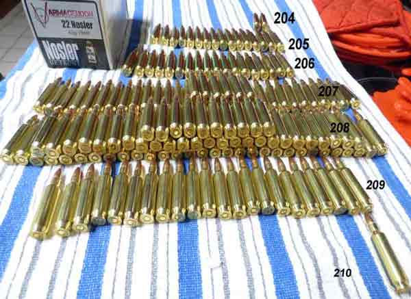

Here's a few boxes of 22 Nosler 62gr factory ammo. Cartridge weight generally 208grs with a couple of outliers @ 204 grs and one @ 210.
My GUESS is that is mostly case weight variation. Picking the 207/208 to plink with (bought at a discount) should give me closely matched once fired cases to reload.
I'll mark the Light and Heavy and keep them for fouling shots.
Will they perform differently? Not at 100 or 200 yards but they won't be tagging along to a competition. Sorry little fellers.

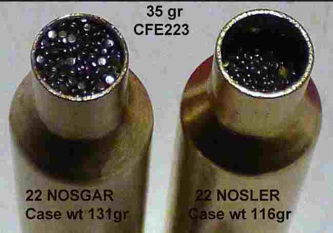

I am playing with a 22 Nosler right now. 22N cases and necked down 6mm Hagar cases. Drastic difference in weight and capacity.
Think that would matter? 12 to 13% difference in weight, about 3% different in capacity even once fired and resized.

As far as Scientific data about case weight/powder capacity, just look at the .223, the .223AI, the 22 Nosler.
Primary difference is powder capacity. Same with the many variations in 6.5 cartridges.
If 7% between the 223 and 223AI makes a difference, would 1 or 2% capacity be negligible?
