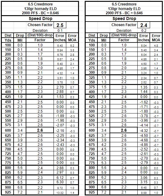

    I finally listened to this podcast. This system is interesting, and it does work.
    Here is the chart I used to choose what range this method can be applied to my 6.5 Creedmoore. The valid range of use is increased or decreased by choosing a higher or smaller factor. This also changes how accurate you are at the middle and edges of the range. My top factor is 2.6 (In Heavy box), I choose a factor of 2.5. This will put me 1/10th (.3MOA) low at the center of the range and 1/10th (.3MOA) High at the edges of the valid range. If I wanted to stretch the valid range of this method I could choose a 2.4 factor. this will make me 2/10ths (.7MOA) high in mid range and the same low at the edges of the range. This is "choosing the amount of acceptable error" Colby talks about.
    2.5 Factor
    Valid Range = 425 to 825 yards
    2.4 Factor
    Valid Range = 325 to 900 Yards
    I added the MOA column to the charts to better understand the limitations of the method. If we apply this to Target shooting (not a military application) the targets are usually in the 1 to 2 MOA. I wanted to stay below 1/2 MOA for my use, this is how I choose the 2.5 to the factor I will use. 2.5 is also an easy number to do the head math.
    And, Don't forget density Altitude will effect this factor as well. If your DA has a big change, you'll need to alter you factor.
    One thing I noted from the podcast was Colby's comments about this works best for higher BC bullets after 300 yards. After working the numbers I see how this is true. I don't own a 6mm but would be interested to see how well it works for that speedy caliber. Your valid range will certainly get larger. I would also be interested in seeing how this works for larger calibers like the 338 pr 300prc. The longer flatter shooting calibers will also add more valid range.
    I think this method is meant for a hasty quick dial or hold number, and if time is available, may not be our best option but it sure is valid if you had to use it.

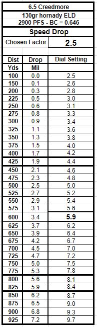

    Here is a chart to change your Dials so you can hold your yardage. This only works in the effective range zone. You'll still need your charts or memorized data above or below the effective zone. With a flatter shooting 6mm this is less of an issue.
    1. Keep your rifle and scope zeroed at 100yards.
    2. Slip your caps so your 100 yard zero lines up with your Factor (2.5 for me)
    3. In the effective range of this method, Dial your Yardage. At ranges above and below the effective range you'll need to reference your charts.
    Here is a chart for what my scope would read - Dial Setting
    You'll see in the 425 to 825 yard range I am one 1/10th high or low from the yardage number.

    I think we would slip our turret up +2.5 rather than down.
    Shooting 100 yards - Dial reads 2.5
    Shooting 600 Yards - Dial reads 6.0
    Shooting 734 Yards - Dial reads 7.3
    Maybe for the faster, hotter, flatter cartridges this changes. I am not sure.
    2.5 Factor
    2.4 Factor
