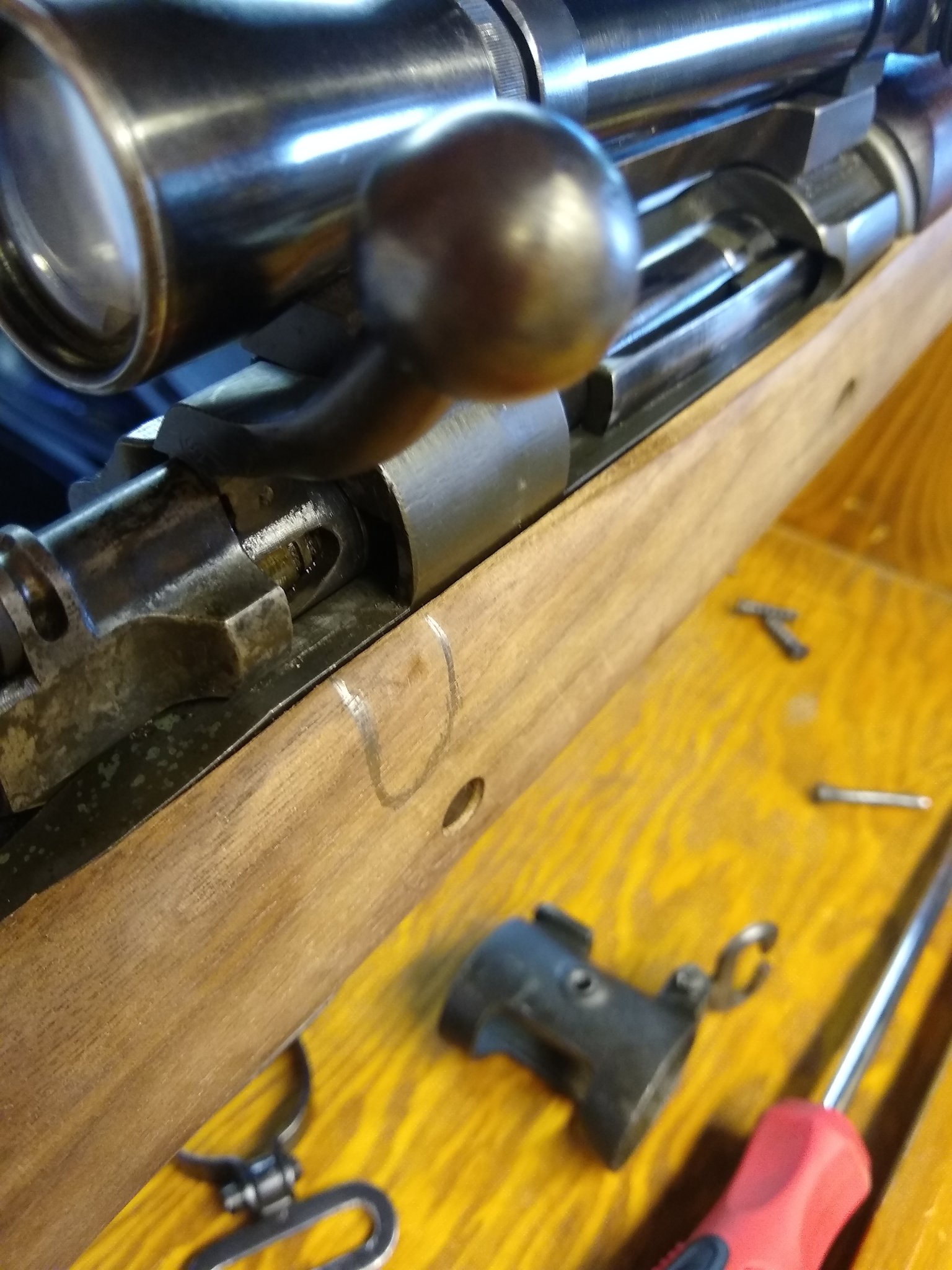

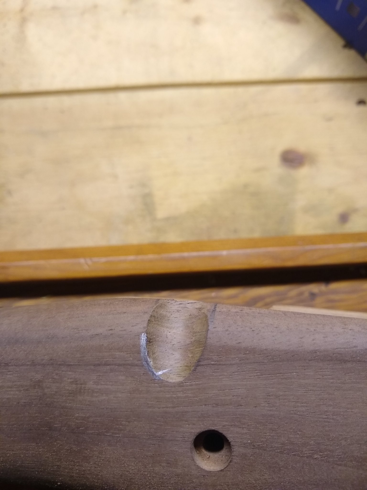

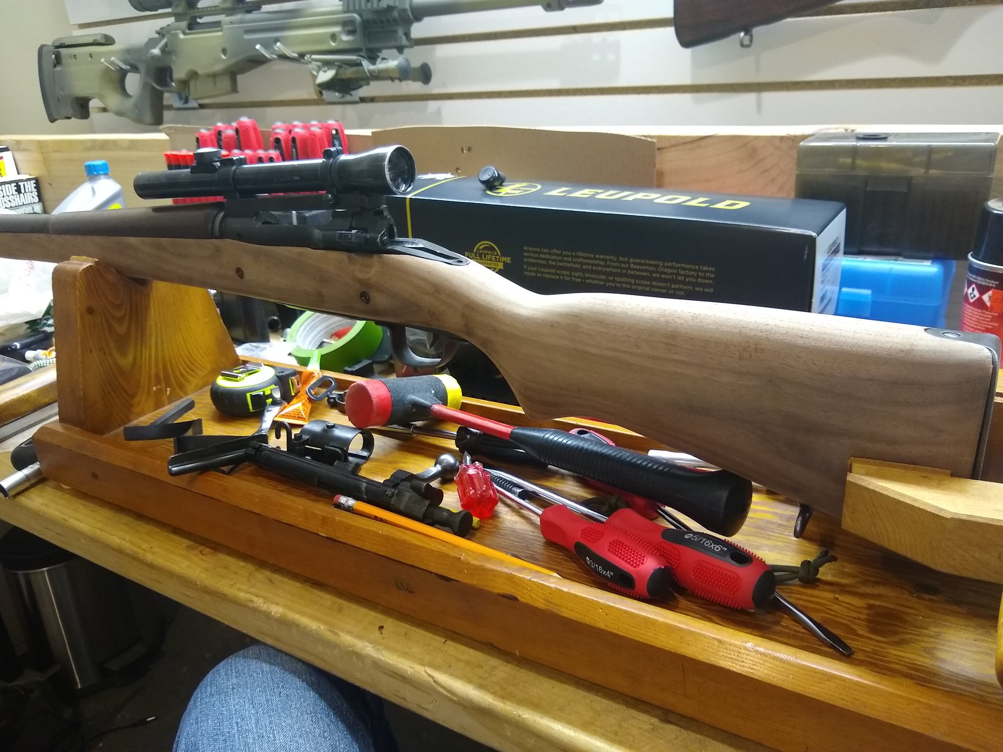

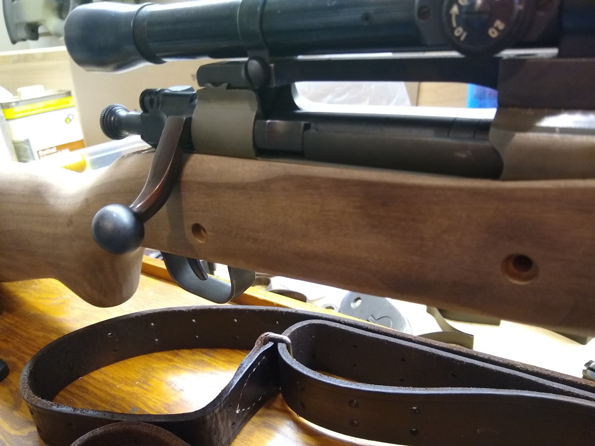

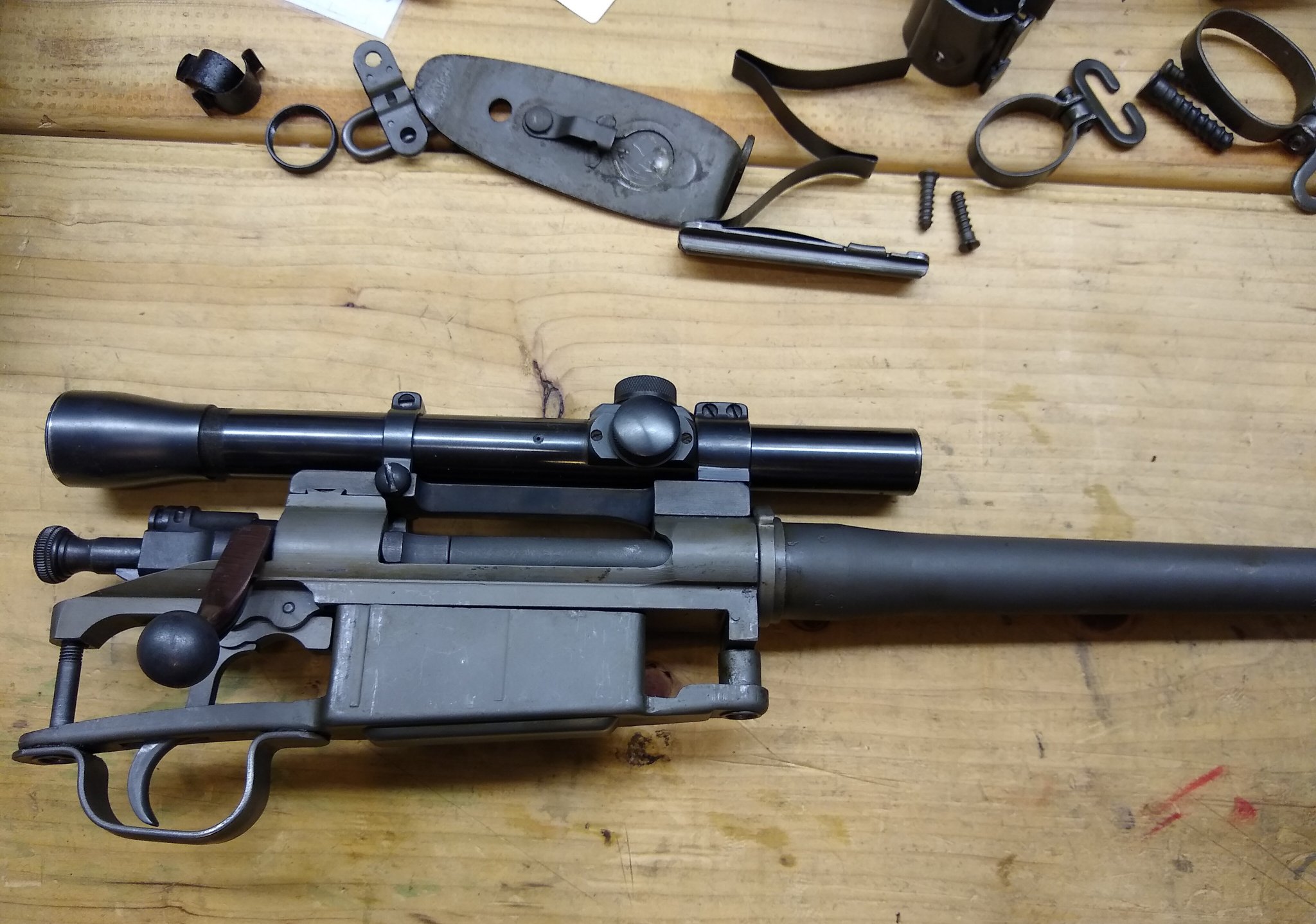

That would be a great candidate for a restoration. It will be a chuck of change, but done that will be a really nice piece.

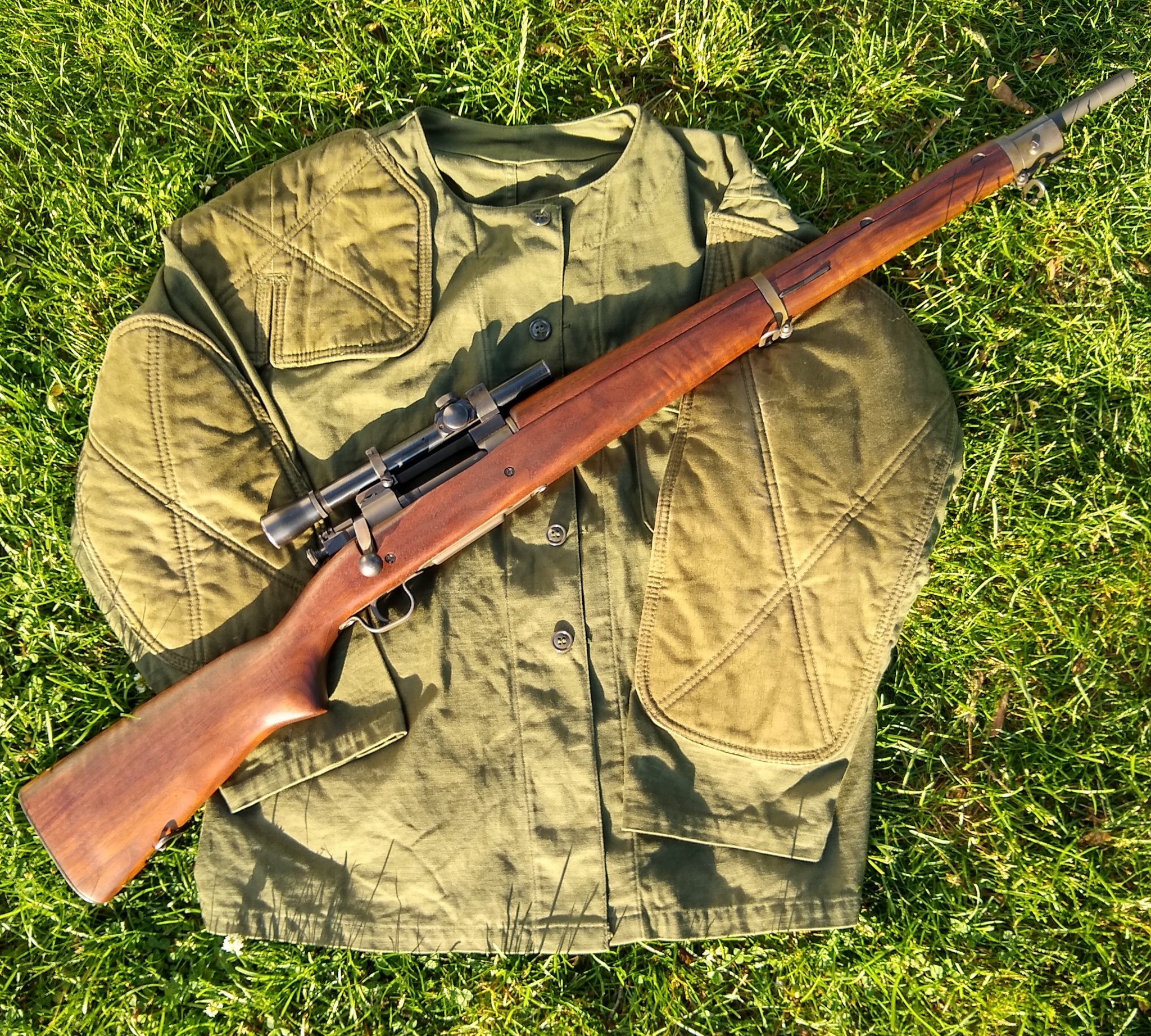

Needs for CMP Vintage Sniper:
- C or S stock
- Correct barrel Criterion or NOS
- Rings vertical split rings or Horizontal
( Depending on scope choice )
Your bolt body looks correct. If it has been modified for the aftermarket barrel you'll need one of those as well.

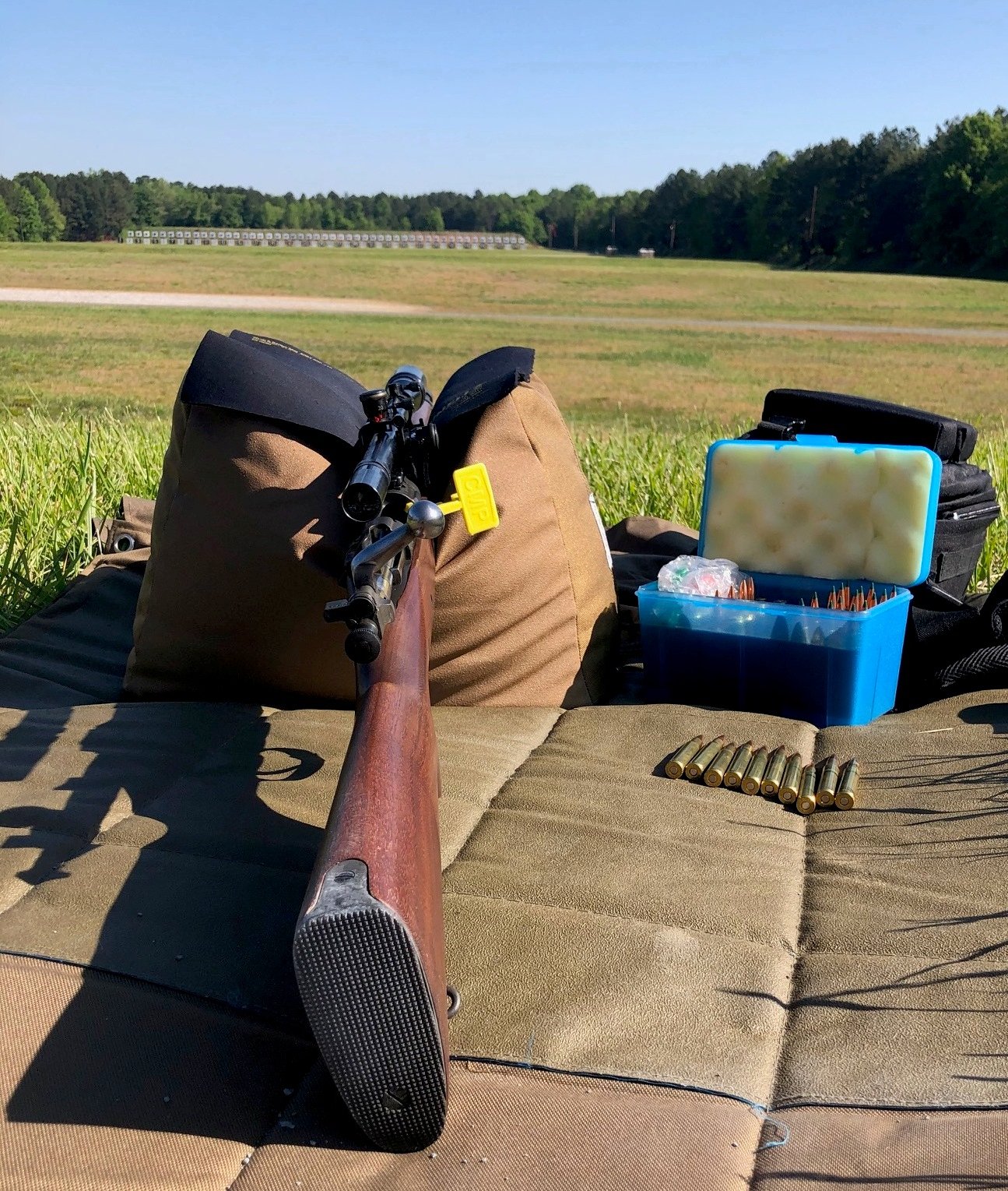

Let me know if your interested in any other information or are considering selling it as is. I just did two for CMP with Lyman Alaskans and one with a modern Hilux M81.

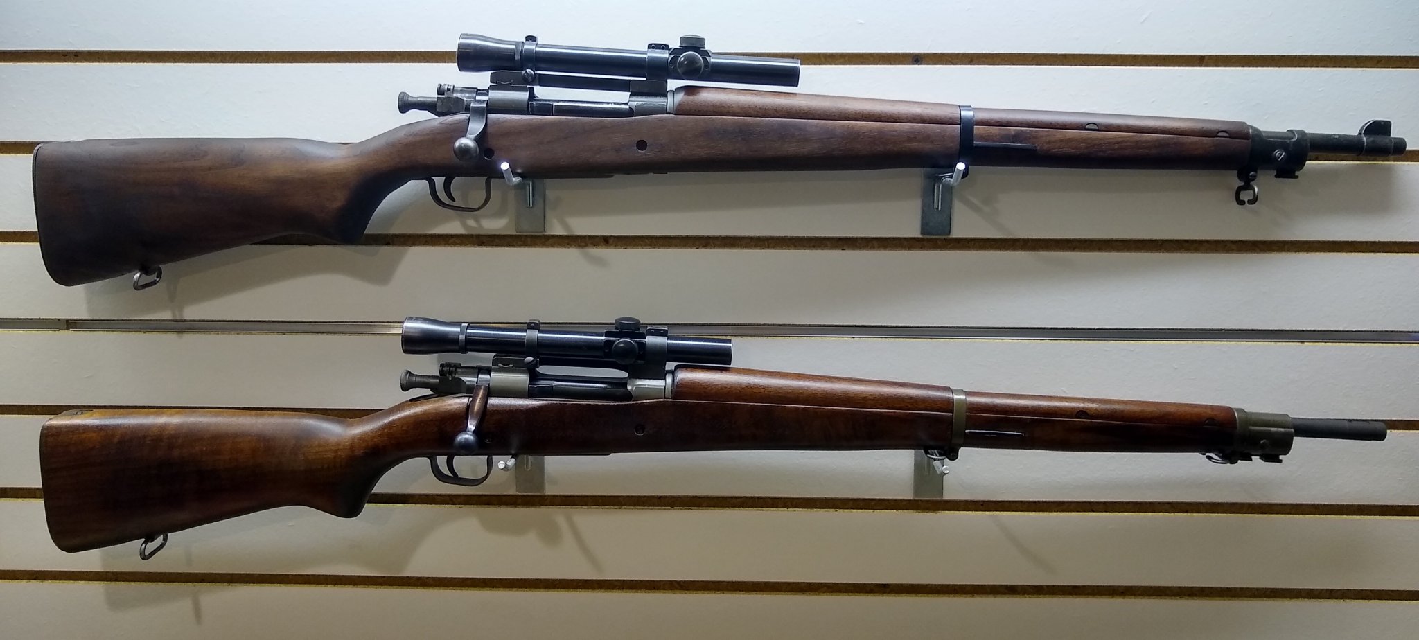

I own a Gibbs, aka Rock Ridge Machine Works, 1903A4 replica. It shoots 150g and 168g ammunition well. I've fired quite a few 1" groups at 100 yards with 150g JSP and 168g reloads (2500 fps). Sub 4" groups at 300 yards were also the norm if I do my job.
I haven't found or developed a 175g load that groups well.

Thank you for the kind words. I love that scant stock and the fact that your bringing it back to original condition. My original barrel shot under an inch at 100 yards, but had very little rifling left so I switched it for a Criterion. My shooting partners 1903 still retains it's original barrel and shoots lights out at Perry.

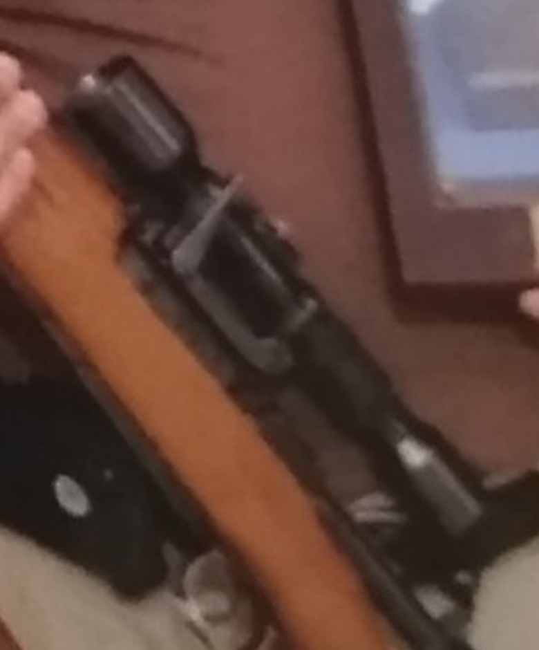

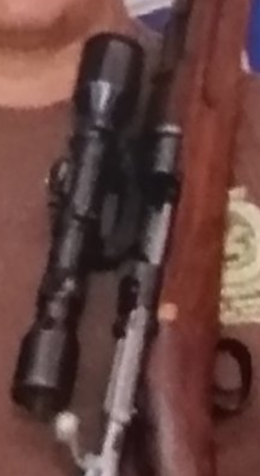

Interesting. How did the 8x 1903's do?
Were the Swede shooters using any kind of cheek rest?
8x's held their own. The wind was ripping left to right. Ballistics took the day. They both had the raised leather cheek pieces. When I get home I will find a picture of them and post it here.

I've got one of those strap on cheek risers, but wasn't positive that it was legal.
Say, LPR. Were those Swedish Mauser shooters using Weaver scopes? Hard to tell.
They look like a German variant. Alot of guys where using Weaver 4x scopes. The above scopes look like they have an AJAKS style elevation turret. Can't quite tell though.

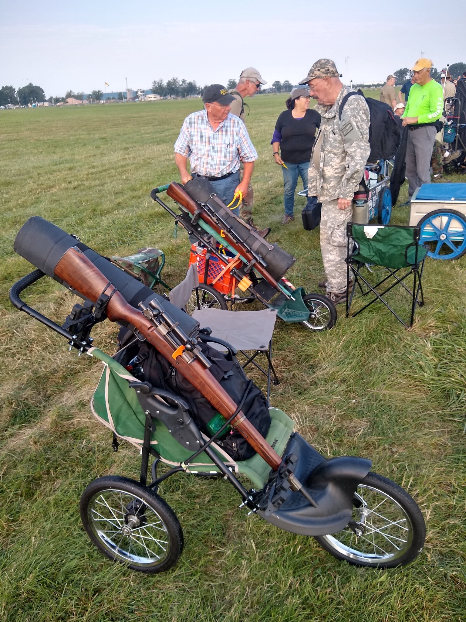

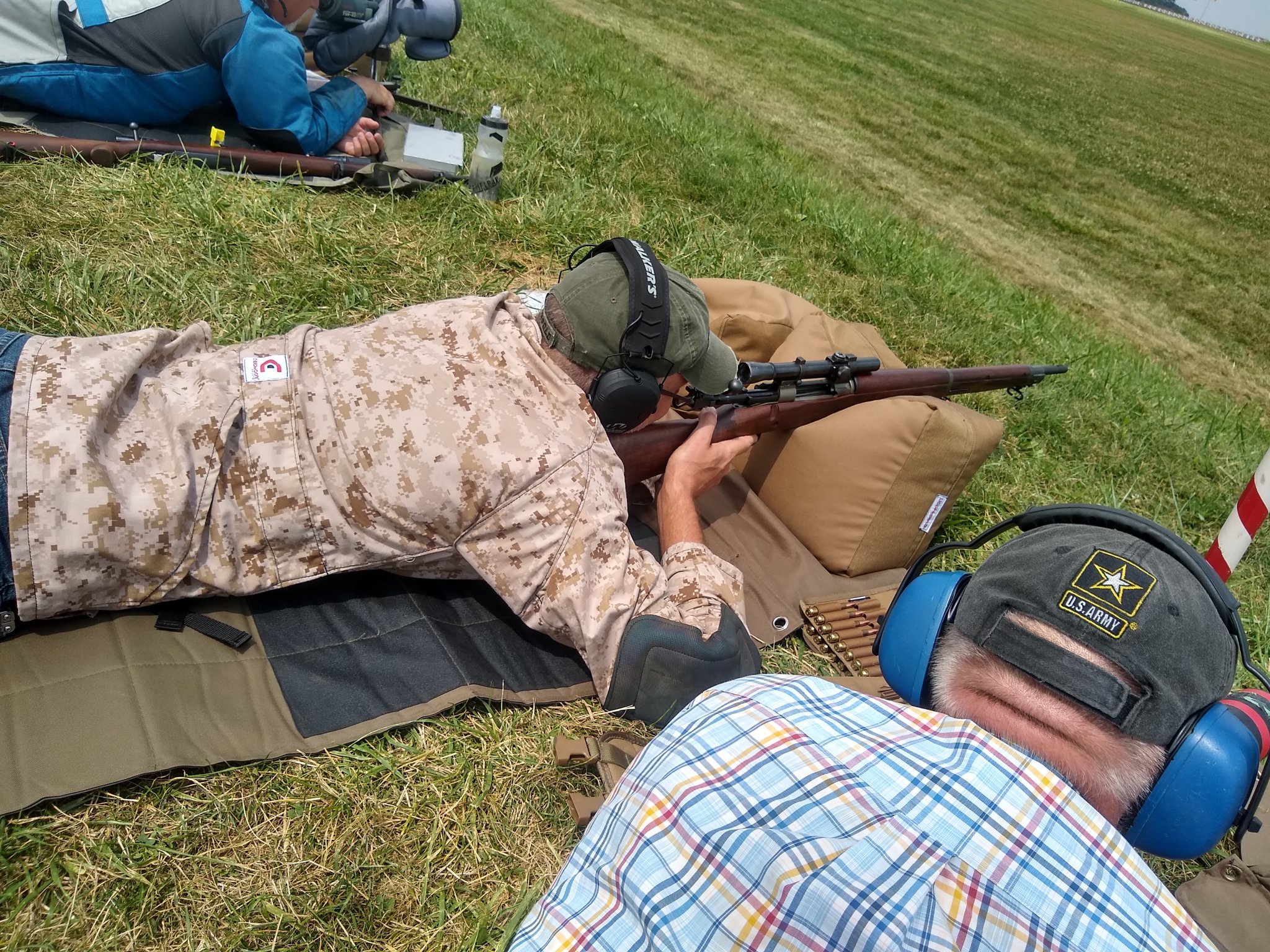

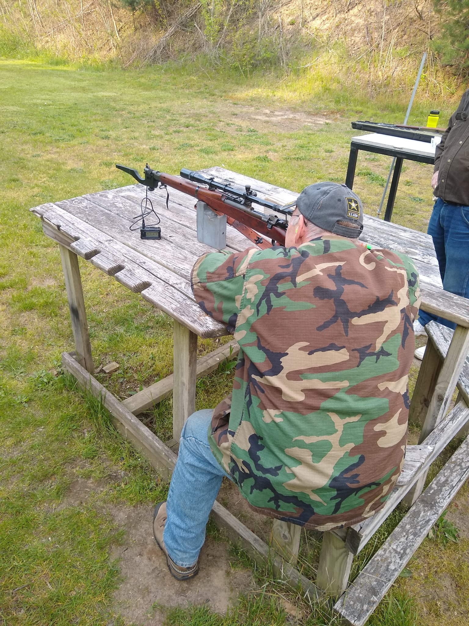

Nice pics. That is some great shooting with M41Bs given their lack of windage adjustments. I'm bummed that I can't attend CMP Eastern Games next week due to work commitments. The vintage sniper match is my favorite match. Here's a pic from 2021 on the 300-yard berm w/ trusty M1908 w/ 8x scope.
...the electronic targets that CMP uses makes the matches run really quickly.
