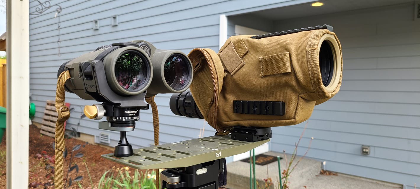

I personally would recommend the MUB MOD DOS if inclined to achieve what you are looking for. Mount the spotter to the table with a standard arca clamp, place a M-LOK picatiny section on the plate with a red dot mounted to it. It should work fine once the red dot is co-witnessed to the spotter, however depending on the red dot sight mount height may be a little awkward as the viewing would not be on the same height viewing plane. I run a Bushnell Legend Tactical T-Series Spotting Scope 15-45x60 with a PA red dot on the side for ease of aiming and SIG KILO 3000BDX Range finding Binos on a MUB plate. The Bushnell is clamped to the MUB with a standard arca clamp, the Sig held by a RRS polymer cinch clamp on a FotoBetter MBP-19 mini ballhead to co-witness to the spotter. The nice thing about the MUB is it's very versatile with plenty of M-Lok slots and 1/4-20 mounting holes.
