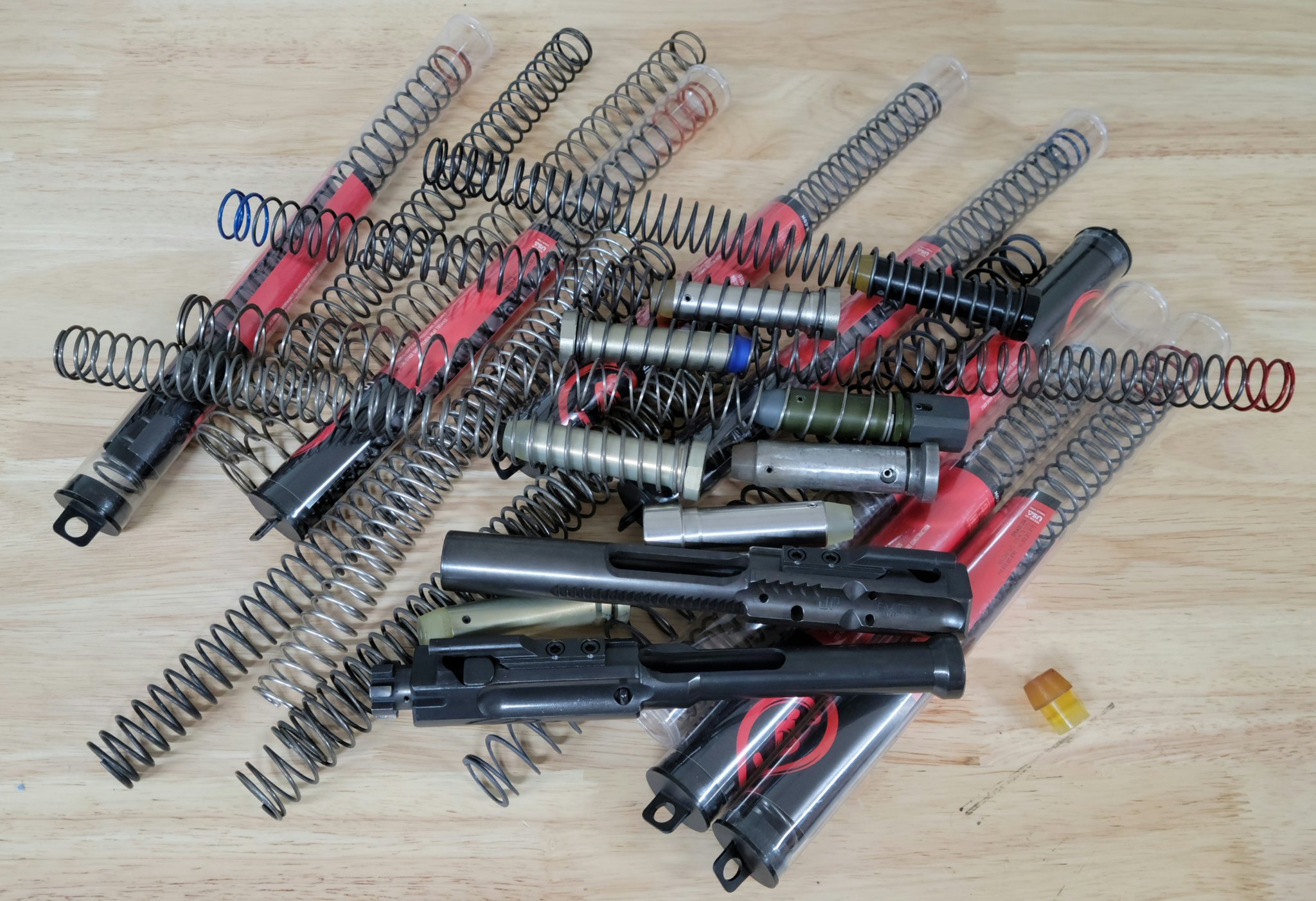

If you "scienced" harder you wouldn't have so many unused springs/parts laying around not in functioning rifles.
