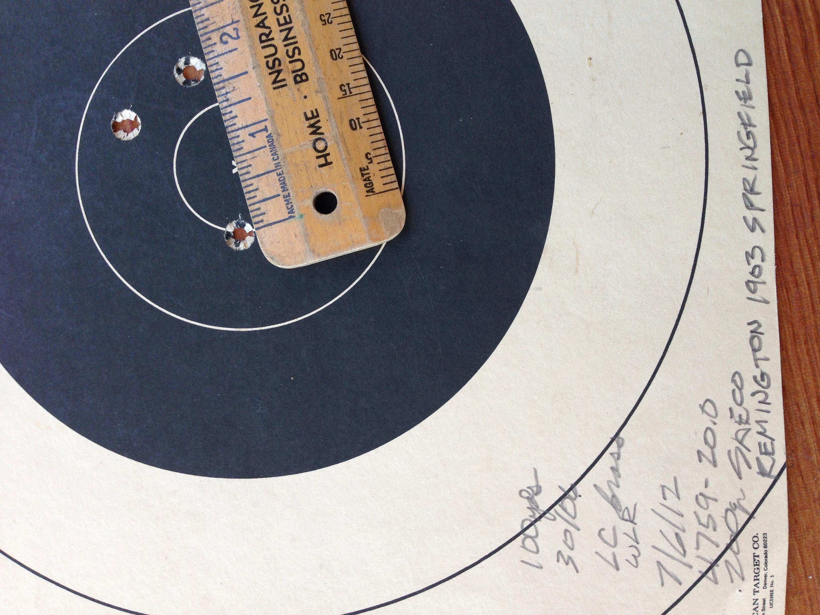

Many years ago, I came into possession of a pristine Remington mfg version of the Springfield 1903/A1 in 30/06. This rifle had clearly been well cared for and remains in very good condition. I shot it one time when I got it, cleaned it and tucked it away in the back of the safe and nearly forgot about it. I recently moved and in the course of relocating the guns and safe, I got it out and was admiring the old rifle. It has a pretty decent set of iron sights and while I shot NRA hi-power matches years ago, I never used this old rifle for such. Mostly we shot old Garands or M14/M1A's back then. Sometimes the match directors would let me use my FAL also. A few guys were using AR15's and today those nearly dominate. I never got to see an 03/A1 compete.
Lately, I have been wondering how well an old dog like this might shoot at longer distances such as 500 and 1000yds? I know they used to shoot these old rifles at the Camp Perry matches, for all I know maybe they still do? I still have some old DCM surplus ammo in the original Garand clips and just picked up a few boxes of Hornady Match ammo for it. I have access to a nice 300yd range these days and another at 200yds. What is the accuracy potential for an old original 03/A1 with the open sights? Just wondering what I should expect from it?
Irish
Remington made Springfield 1903 at 100 yards
The three shot groups illustrated was fired off the bench using 200 grain cast bullets at 100 yards with iron sights and 70-year-old eyes.

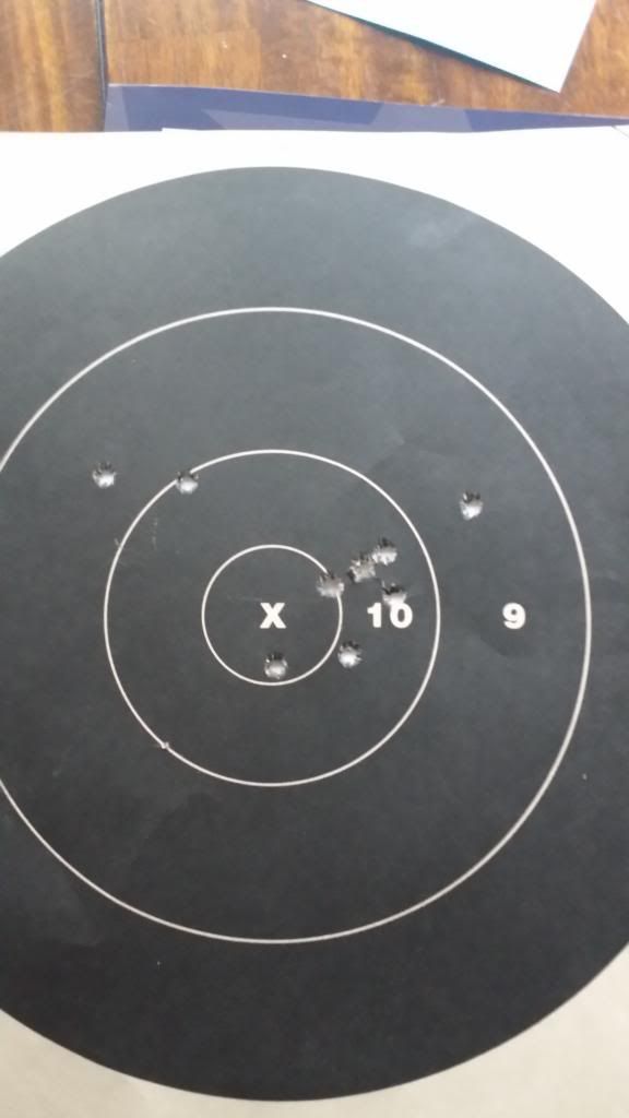

Complete novice to vintage iron shooting, 11 shots at 100 yards using 155 gr hand loaded A-Max.
I have had several comments of disbelief from hunters sighting/playing in the offseason that a 95 year old, as-issued rifle with a 70 year old barrel, using open iron sights and a sling, is capable of this at 100 yards. Especially with a round like the .30-06.
However, nobody with experience firing a 1903 would be surprised or even impressed; they would be giving pointers on how to improve further. Learn sight picture with the irons and welcome to the brave new (old) world.
Oh, one things I learned right away, at least for me: shoot it like a bench rested hunting rifle and you will be disappointed. It's not a rifle that suffers poor or sloppy fundamentals (positions, NPA, grip, pull). Mine lets me know immediately if I'm slipping.
Its nice to see you dont make things easy for your self by using small bore targets.
Get yourself some 100 yard SR1 scaled targets and you will be able to impress people more as the larger 10 and X rings will have most of your group riding full value scores. National Target sells some great targets. You can have the full target or just the centers ordered through them.
Dont be any harder on yourself than you have to be.
Will do, pmclaine!
The local rifle range only has zeroing targets available, and these small bores were the only black center targets I could get my hands on at any of the LGS' around here. Good sight picture, but very small scoring rings ;)
Many thanks lads. That is some good info and great shooting. It had been so long since I shot this rifle last that I really could not recall how well it shot, other than it was OK and on tgt from a makeshift, not too steady rest. We have a local centerfire match coming up soon and it includes a open site class. I thought I might drag the old warhorse out to play.
