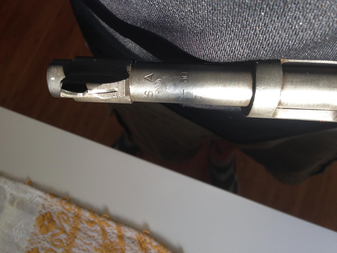

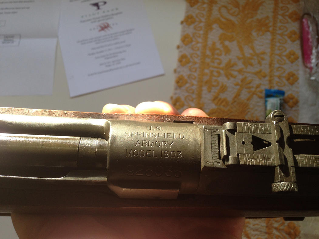

So my last post was about the Gibbs 1903 sniper...because it shot so well I went out and bought myself an original springfield. I dont know anything about the rifle so any comments would be great. I paid 700 dollars for it and for all I know it could have been assembled for someone recently. Either way the serial number is after the 800,000 so it's a shooter and it has been rebarreled as the date on the barrel is 3-30. No stamps on the stock and not sure what else to look for to make sure I paid the right price.

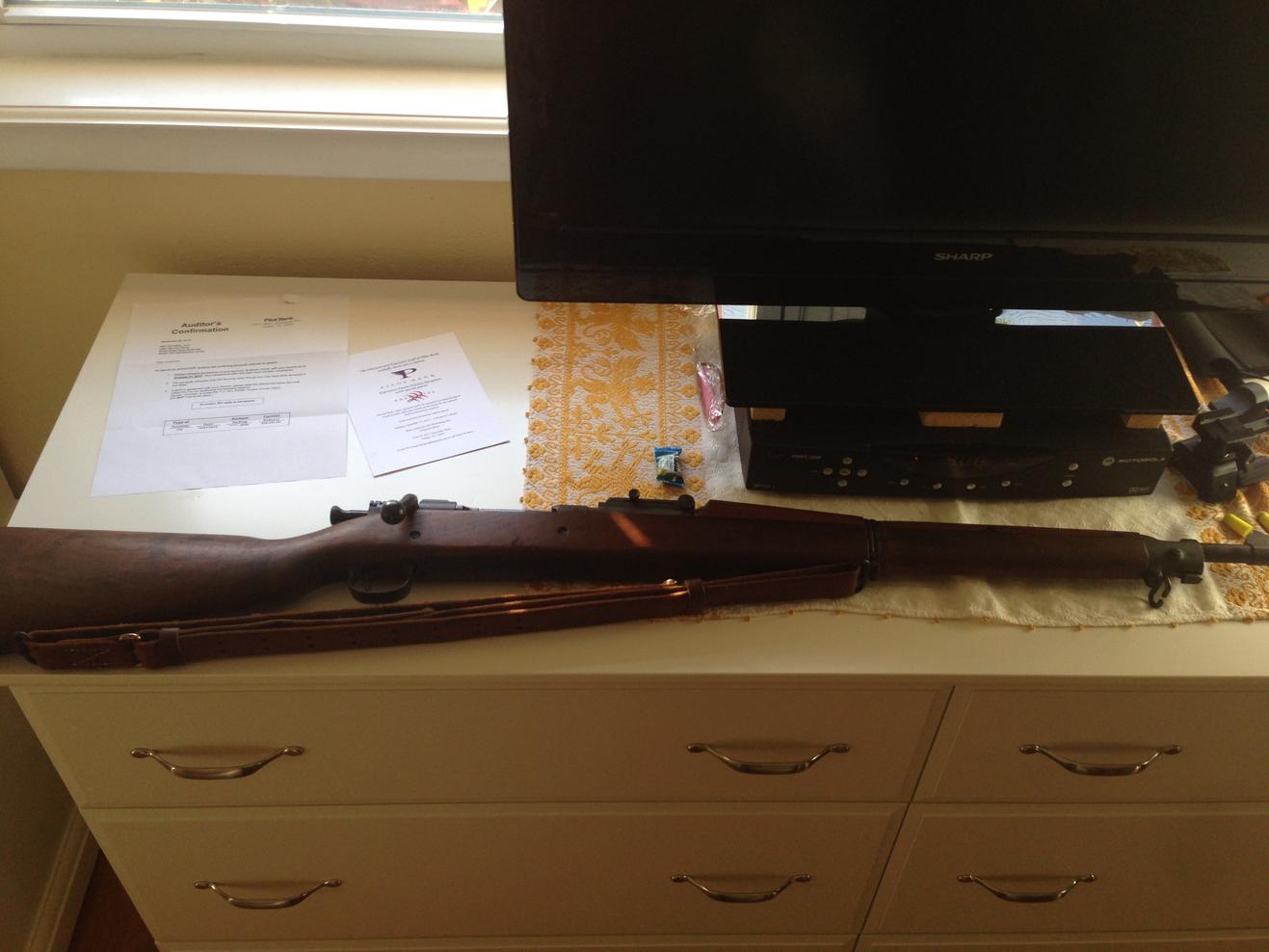

The gun after adjusting the sights is amazing. I have the first photo which is of the first 5 shots I made shooting from a lead sled at 100 meters making a small adjustment until the final bulls eye. The second photo is shooting the gun off of my range bag taking no longer than 5 seconds between shots. The other photos are of the gun...the barrel is pristine...like a mirror. I dont have any gauges, but from the way it shoots I dont need no stinkin' gauges!!!
Can anyone give me some feedback on the gun...did I do well price wise?
Nice looking rifle, and seems to shoot really well. I think you did pretty good for $700, not a steal but a good price if the barrel is that nice. It's not really a 1903A1 though. 1903A1's are rifles which were originally built at the arsenals with C stocks in the late 20's through the mid 30's (I think, don't hold me to that time frame). Yours has a "S" or scant stock, and the S/N dates it much to much earlier. It probably picked up the stock at the same time as the barrel, but it may have gone through multiple rebuild too.

Don't worry about the 1930 barrel. It could be old, but new, meaning not used after the rebuilt.

As mentioned, the serial number puts your rifle in 1918. Being rebuilt in 1930 may make the barrel NM; check the muzzle crown at 6 o'clock for a sunburst/turtle looking stamp. The scant stock didn't come around till WWII. These were used quite a bit on 03-A4s, thus there were no cartouches. Glad it shoots well for you.
