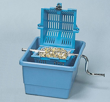

A dillon media separator works perfectly for me - i fill the basin with water from the garden hose and crank the case separator around a few times. The bottom half stays in the water and all the pins fall. magnet test and/or visual test after they are drying.

No offense to doubled but using a media separator to remove SS media from bottle neck brass is asking for trouble (the one mentioned above). This method ONLY works for pistol brass and it works well.

it's one step in a 3 step process and it works quite well for initial separation. everyone will do what they feel is right but to say it works only for pistol brass is foolish. with the basin filled with water it removes 99% of all my media from .223 thru .50cal and is very effective.
step 2 is using a magnet on your drying table
step 3 is a visual inspection before loading.

<div class="ubbcode-block"><div class="ubbcode-header">Originally Posted By: doubled</div><div class="ubbcode-body">A dillon media separator works perfectly for me - i fill the basin with water from the garden hose and crank the case separator around a few times. The bottom half stays in the water and all the pins fall. magnet test and/or visual test after they are drying.
</div></div>
That is awesome! How well does it work? Do you usually catch a lot of media after a final inspection or is the separator really good at getting it out? That could definitely safe me a lot of time.
