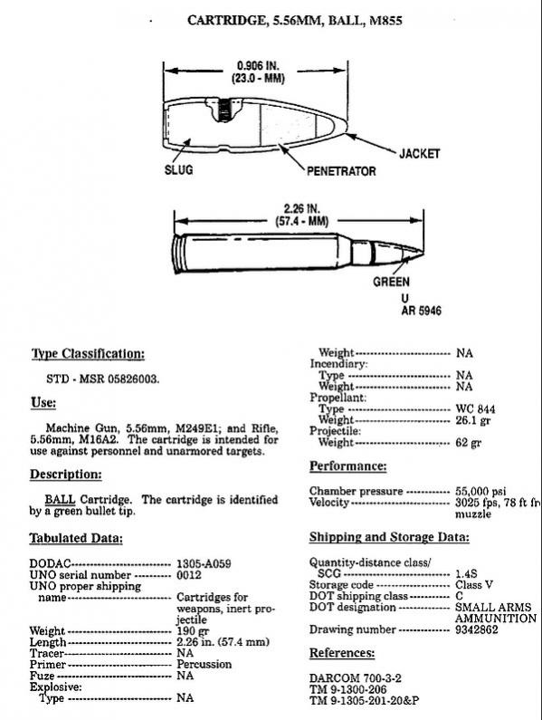

Off the Army Small Caliber Ammunition Data Sheet (TM 43-0001-27) for M855:
CARTRIDGE, 5.56MM, BALL, M855
Type Classification: STD - MSR 05826003.
Use: Machine Gun, 5.56mm, M249E1; and Rifle, 5.56mm, M16A2. The cartridge is intended for use against personnel and unarmored targets.
Description: BALL Cartridge. The cartridge is identified by a green bullet tip.
Tabulated Data:
DODAC 1305-A059
UNO serial number 0012
UNO proper shipping name Cartridges for weapons, inert projectile
Weight 190 gr
Length 2.26 in.
Primer Percussion
Propellant:
Type WC 844 <span style="color: #FF0000">(as of 1994 when Winchester/Olin were running lake City -- once ATK got the ontract they would most assuredly have changed it to their own powders to stay at spec'ed velocity and pressure)</span>
Weight 26.1 gr
Projectile:
Weight 62 gr
Performance:
Chamber pressure 55,000 psi
Velocity 3025 fps, 78 ft from muzzle

Lake City and the Army use the nominal data on the performance sheets but vary powder charges to get optimum pressure, velocity, and accuracy.
H335 may or may not be WC844 -- it depends on whose powder mill the contractor and the government use. Note that Hodgdon bought out DuPont's IMR line, Federal still uses IMR 4064 in some of their 308 loads, and Winchester buys some of their Powders from General Dynamics.
Also note the data dates back to 1994, and the government changed contractors from Olin to ATK back around 2000.
WC844 is NOT the same as H335
They are close in burn rates but you need to work up your load with WC844 as it is not a commercial canister powder - each lot can be very different.
Primers DO make a difference - I have seen a 50fps increase when switching from Win to CCI primers - everything else being the same.
