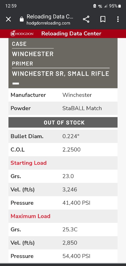

Curious about Staball in 223/556 with 75gr BTHP.
Went to Hodgdons website load data today and found it interesting.
Starting load had beat my max Tac load by 205 fps.
Never seen an error on Hodgdons load data before.
Reactions: lash
That is most definitely an error on the velocity for the minimum load... Might be good to send hodgdon an email before someone tries to achieve that velocity and ends up wearing parts of their rifle.
Unless staball match has a magic inverse relationship between pressure and velocity...
