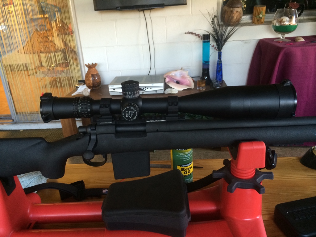

Got the scope base on with surprising zero effort, a Seekins SRS rail mounted up front, and the Nightforce NXS 5.5-22 x 56 has arrived; but my scope rings from the old box of gun goodies were too high, so new rings are on order. Also somewhere on a UPS truck is an Atlas bipod and a friend is sending me an HS Precision Gen-2 DBM w/ 10 round mag that he never used.
My google-foo has failed me, so I'm unable to find one of the smaller 4 round HS Gen-2 .308 mags to fit it. I'll need that before deer session due to Florida hunting regs. Maybe I should write another bill to fix that.

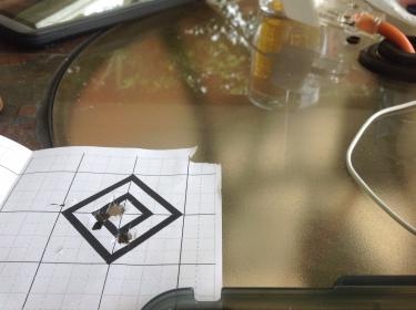

After 40 rounds of break in and roughing in the zero using 168gr American Eagle boat tail I switched to the match grade stuff. Best results were from 168gr Federal Gold Medal Match at just under 1 MOA shooting off the bipod. The rifle is defiantly capable of more but considering that I had no cheek weld, I'm very pleased with this as a start.
A Bradley Adjustable cheek rest is already on the way.
