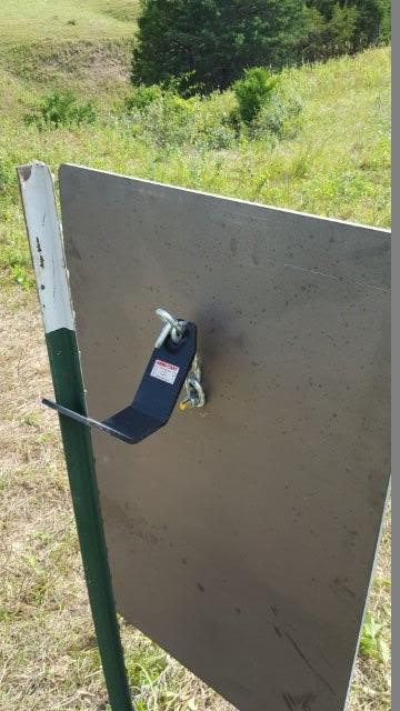

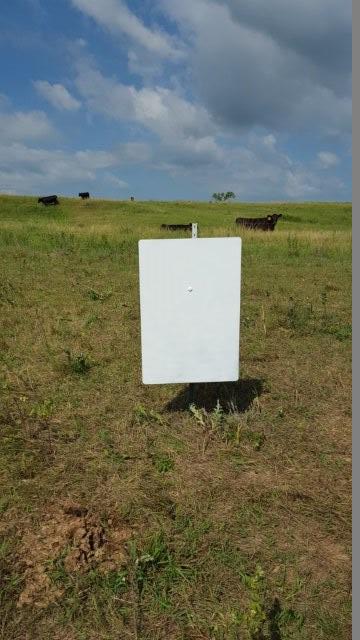

Here is one that we put up at 1000 yards. 24 x 36 AR500 3/8"
It hangs easily on a well placed T Post and hasn't sagged it 2 years.
The single bolt and chain mount allows for the plate to move freely.
Hanging a big plate like this cannot get any easier.
Hang Fast Targets more info

The Hang Fast mounting system allows the plate to swing freely on a short chain section making hits at distance easy to see because the plate will react substantially but reset within seconds. This gives you enough time to get back on the scope and see the plate movement and spot your own hits. The single (loose) mounting point also enhances harmonics making the plate ring loudly.
