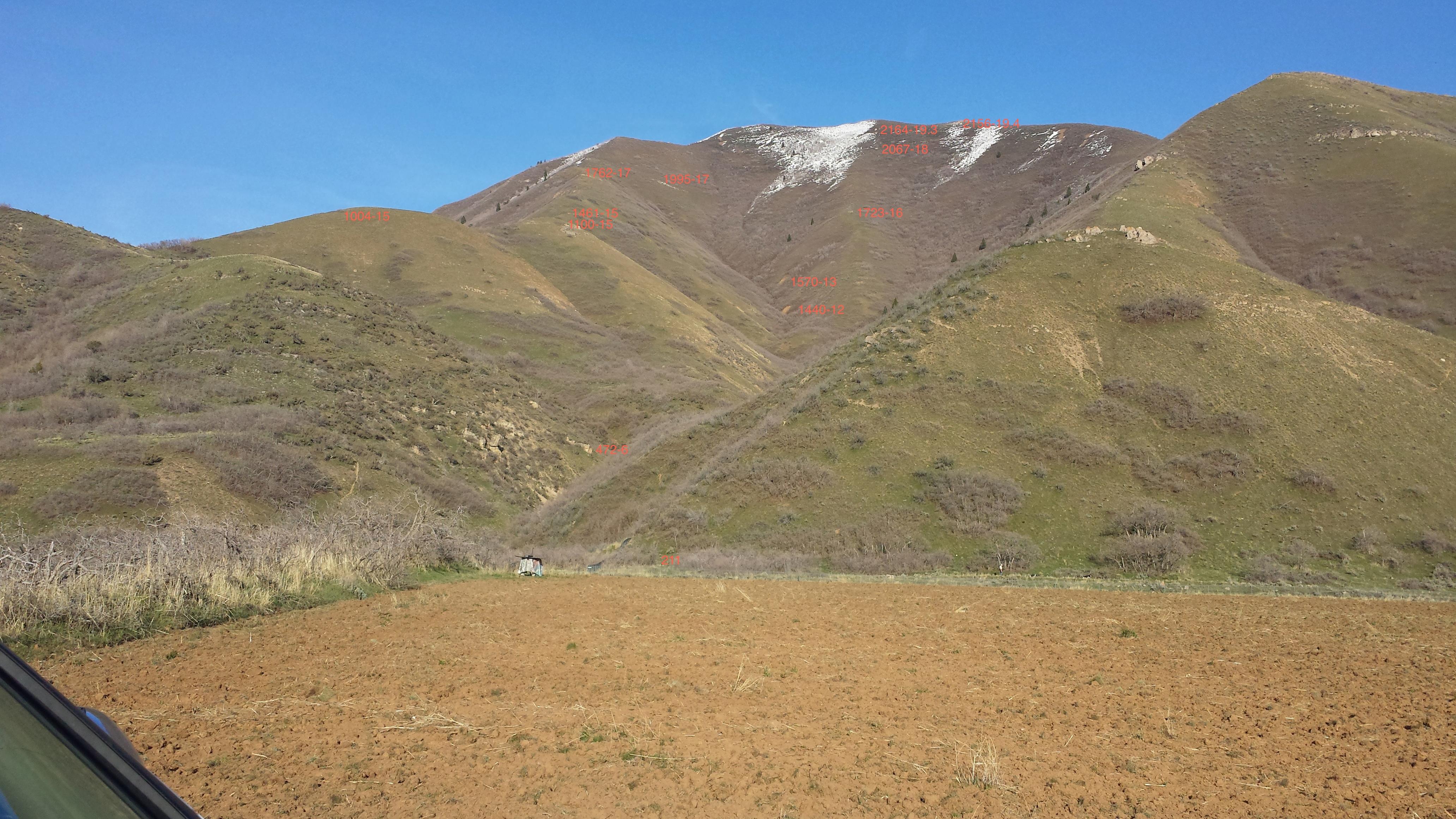

Here's my new range out to 2200 yds near the summit which is about 19-20 uphill angle.
Alan

I would say 1.5 MOA for the closer stuff, 2 MOA for the ELR is fine. Even a laser of a caliber such as the Edge will struggle with the small targets at ELR in any kind of wind. I have shot my 338 Edge at 600 on Jake's (JC steel) 3/8" targets all day, they hold up just fine. As Jake mentioned you can save $$ and weight going with 1/4" for the far stuff, and they ring completely different than the thicker steel.
