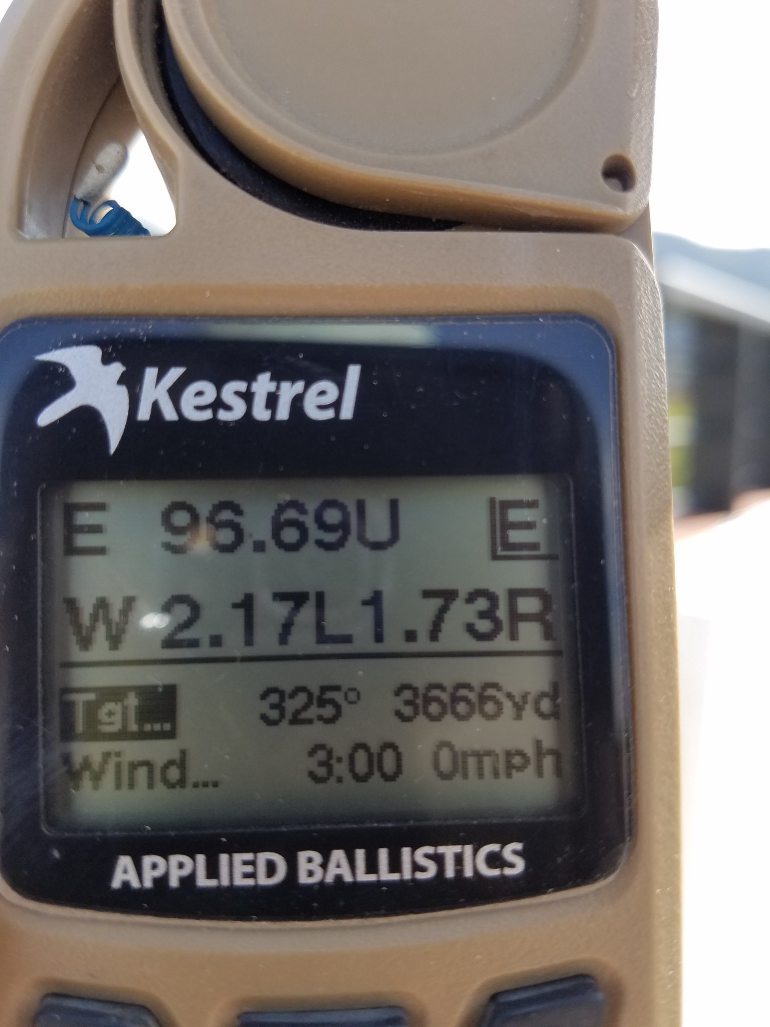

    Kestrel Updates
    I was also happy my Kestrel would pick up closer readings around 3669/3666 (I didn't get pictures of both range and Kestrel from the same range which is why they are off by 3 yards). I have since updated firmware (1.21) so the Kestrel will now accept readings out to 5029M.
    While I don't have a scope that has over 96MIL of travel, its actually a nice feature that the Kestrel takes the longer range because of the way I am using the Kestrel with the Steiners. Sometimes I might range past the target and pick up a range on something much farther than what I intended . When that happens, the integrated BT communication tells the Kestrel the range. If I ranged something farther than the Kestrel can read, I get a message on the Kestrel "Unusable Target Data Received".
    This is the same message you would get on the Kestrel if you also didn't get a range on the Steiners ( ---- y). The problem is that you have to hit the "exit" button to bypass the message on the Kestrel. So, if your in a hurry, you can't simply re-range, you have to interact with the Kestrel to dismiss the message before you can get a valid range displayed. There is no feedback in the Steiner on this, so you would need to realize your range is longer than what the Kestrel can deal with.
    So, by increasing the max distance the Kestrel for the Kestrel, I have a more efficient workflow when I make a mistake now.
    I am pretty sure this was NOT what was intended for this function (most likely ELR), but I am happy to have the new feature :)
