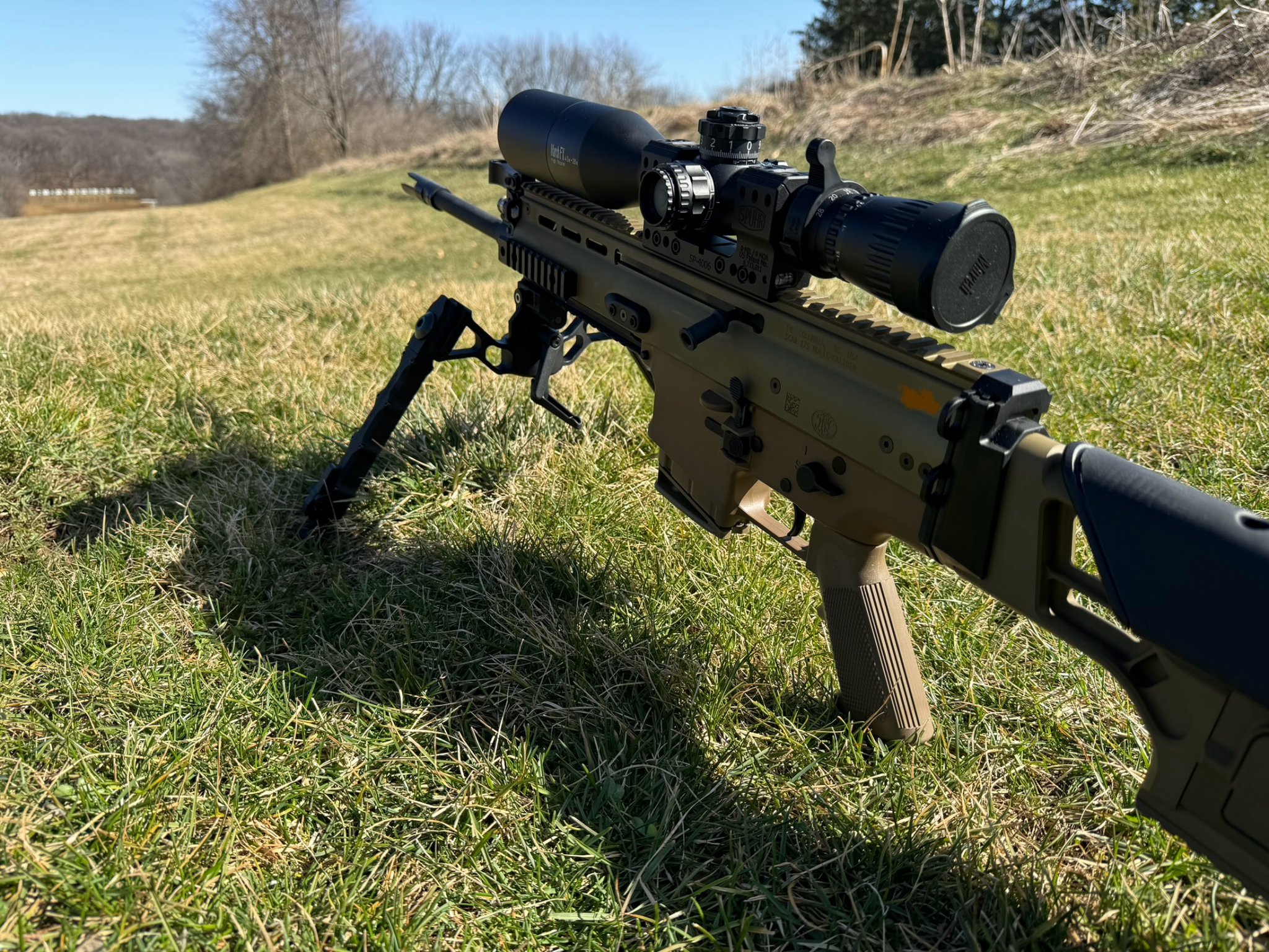

I took the March 4.5-28 to the range yesterday to plink an 8” steel target at 615 yards and I’m glad I didn’t go for any less magnification. 28x was about perfect for that size target at that distance and the wide FOV of the High Master allowed me to see my splashes at max magnification, even under gas gun recoil.
It must have been a mirage free day shooting at 28 power. Glad to hear you are happy with the scope.
I didn’t see any mirage. The temperature was in the 40s and my barrel never heated up to the point it would be an issue. What factors affect mirage?
High humidity (not sure high dew point vs. high relative humidity), warm ground and cooler air, a breeze can help things (esp hot barrel mirage), hot sun hot day, I’m sure there’s more.

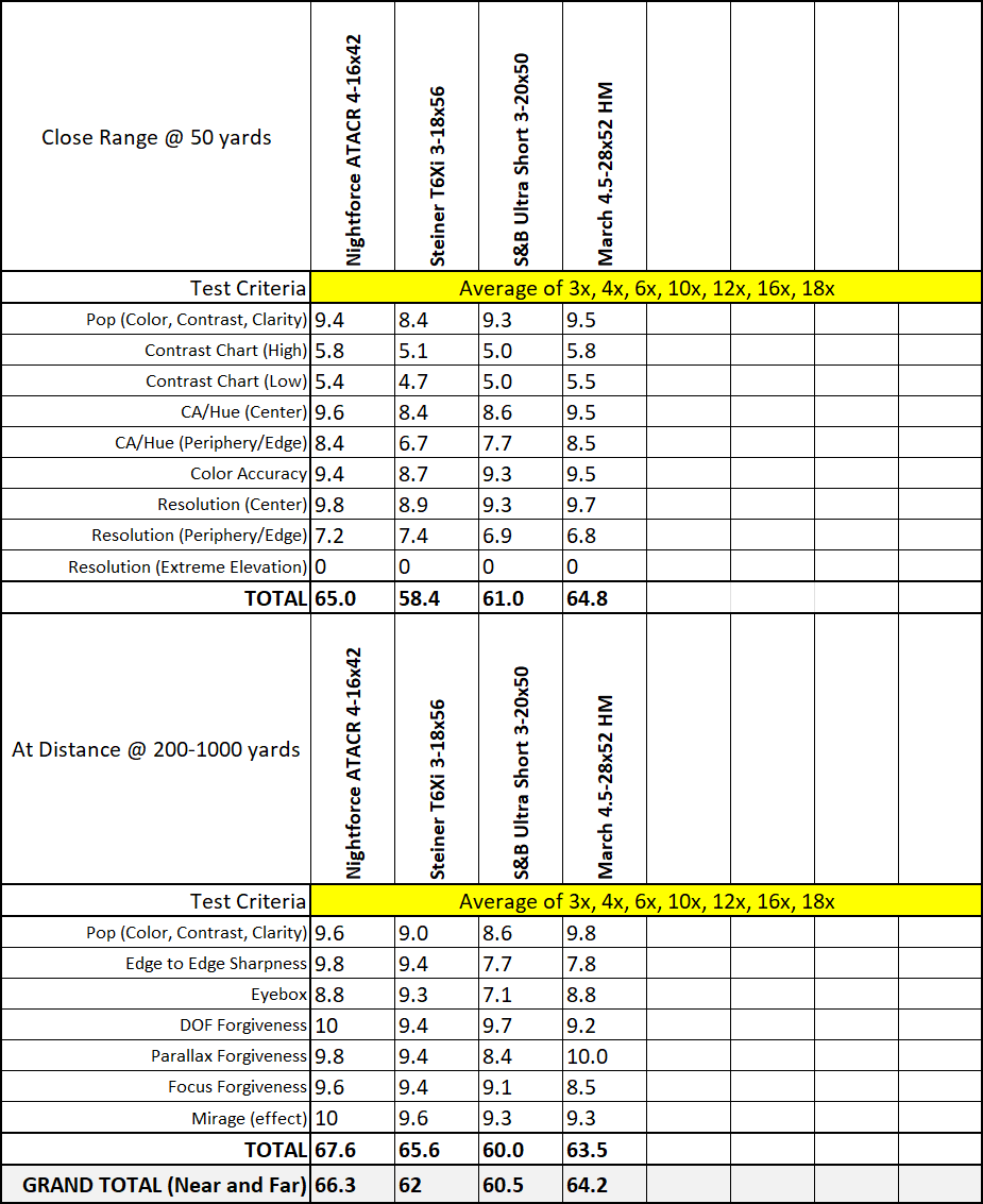

@Glassaholic NF last in this regard on your summary but 2nd on the chart. Typo or am I missing something?
Parallax Adjustment Forgiveness: Schmidt 3-20 = March 4.5-28 = Steiner T6Xi 3-18 > Nightforce 4-16

Oooh, good question, I can see how that would be a bit confusing, I think I need to explain that a little better in my reviews. For the chart here is the description:
Parallax Forgiveness​
Similar to DOF forgiveness, you set your parallax at 500 yards and notice a target at 200 yards is parallax free, and a target at 1000 yards is also parallax free. If parallax is well controlled at 1000 yards, but I transition to 200 yards and notice a lot of movement then this would get a lower number value.
But for the evaluation section here is the description:
What exactly is parallax “forgiveness”? I define this as how finicky it is to adjust the parallax dial in order to get parallax properly set for the distance to target from the scope, keep in mind that many think of the parallax dial as more of a “side focus” and indeed that is its primary purpose but you should always check to see if parallax misalignment is apparent even though the image may appear in focus. In a perfect world, when a scope is properly focused it should also be parallax free, but this is not always the case and if you find that you get “in focus” sight pictures but parallax is “off” then you might try fine tuning the diopter slightly to see if that helps settle down parallax (or even improve IQ). The Schmidt, March and Steiner showed excellent forgiveness while the ATACR was very good but required slightly more adjustment for closer targets.
The difference between the two is that with the first I am simply looking at how parallax free the image is from near to far, but in the second section I am identifying when you have to adjust for parallax how finicky is the adjustment itself to get parallax just right, the NF struggled more than the others at closer distances, it wasn't bad by any means but I felt the others were slightly better.
Hopefully that makes sense and thanks for pointing that out.

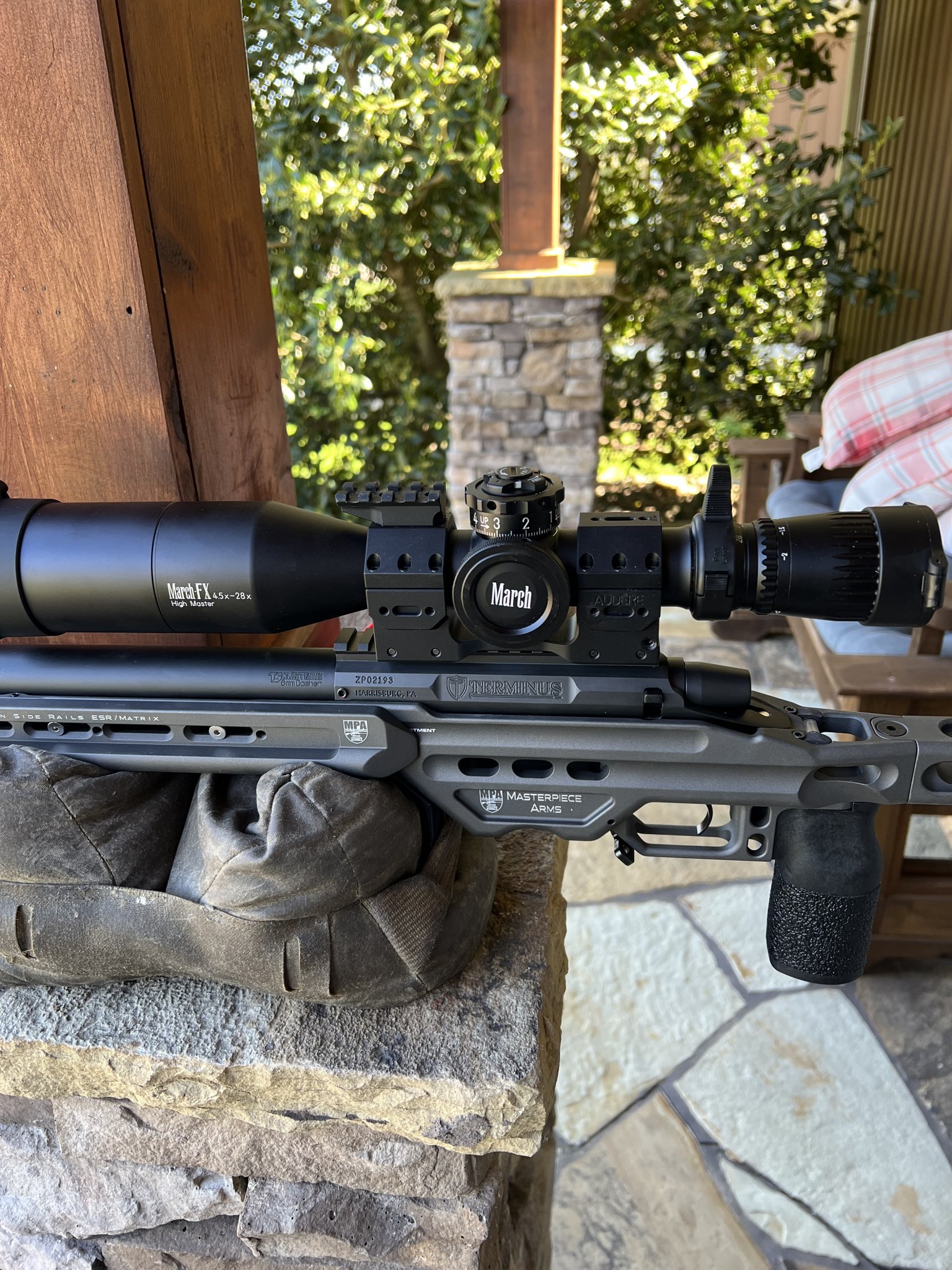

Got the March in today and mounted it. Some first impressions:
Fit and finish is top notch and love all the extras they include.
Turrets are some of the best I’ve spun. They are at Tangent level but do feel different. Zero play and perfect alignment. Elevation and windage feel identical.
Parallax and power are smooth with the appropriate amount of tension.
Optically it is very good. I was able to resolve the individual barbs on a barbwire fence at 300 yards. By this I mean I could distinguish the 4 individual points on each barb. I’ll give some details on this when I have more time to evaluate.
The reticle (LDK) it really good as well. .03 mils seems to be the sweet spot for me. The .025 lines on the J-Tac are almost too fine in certain situations.
I’ll sight it in and check tracking this week in preparation for a 1 day match next weekend. Hopefully have some updates after that.
