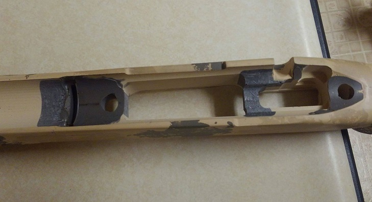

Barring any binding fit issues... in other words, assuming a correct inlet and fit, You probably don't need any bedding at all. I don't believe you need any pillars with modern composite stocks (manners, mcmillan).
All epoxy does is ensure that there is a correct 1:1 fit with no chance for multiple "homes" for the action to bounce around to. Pillars, IMO are a carry over from wooden stocks that compressed over time and behaved goofy in changing weather conditions.
Here's what I'm using now with my Manners EH1. JB weld in the recoil lug and front action screw area, and a dab around the rear action screw. This was done with the action screws "snug" but not tight, and the barrel wrapped in masking tape to keep it free-floating and centered in the barrel channel. I haven't experienced any zero shift, loss of accuracy, screws coming loose, etc. Did this about a year ago.
The full-on pillar glass bed jobs are mostly for show/presentation/warmfuzzy/feelgood.
