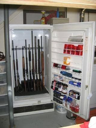

If Im storing a rifle for a long time I will put it in the deep freeze
