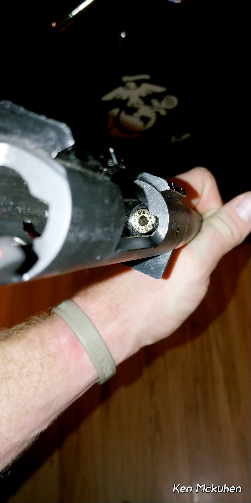

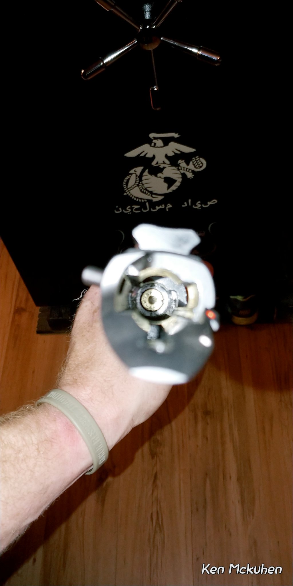

For your enjoyment, here's some photos of the current situation.

If you are feeling out of your depth, there is no shame in letting someone else handle it. Its more embarrassing to bring them something after you Cletus's it all up. Bradu probably gave you the easiest suggestion. Just look up removing a stuck case from a reloading die, and you should get the idea.

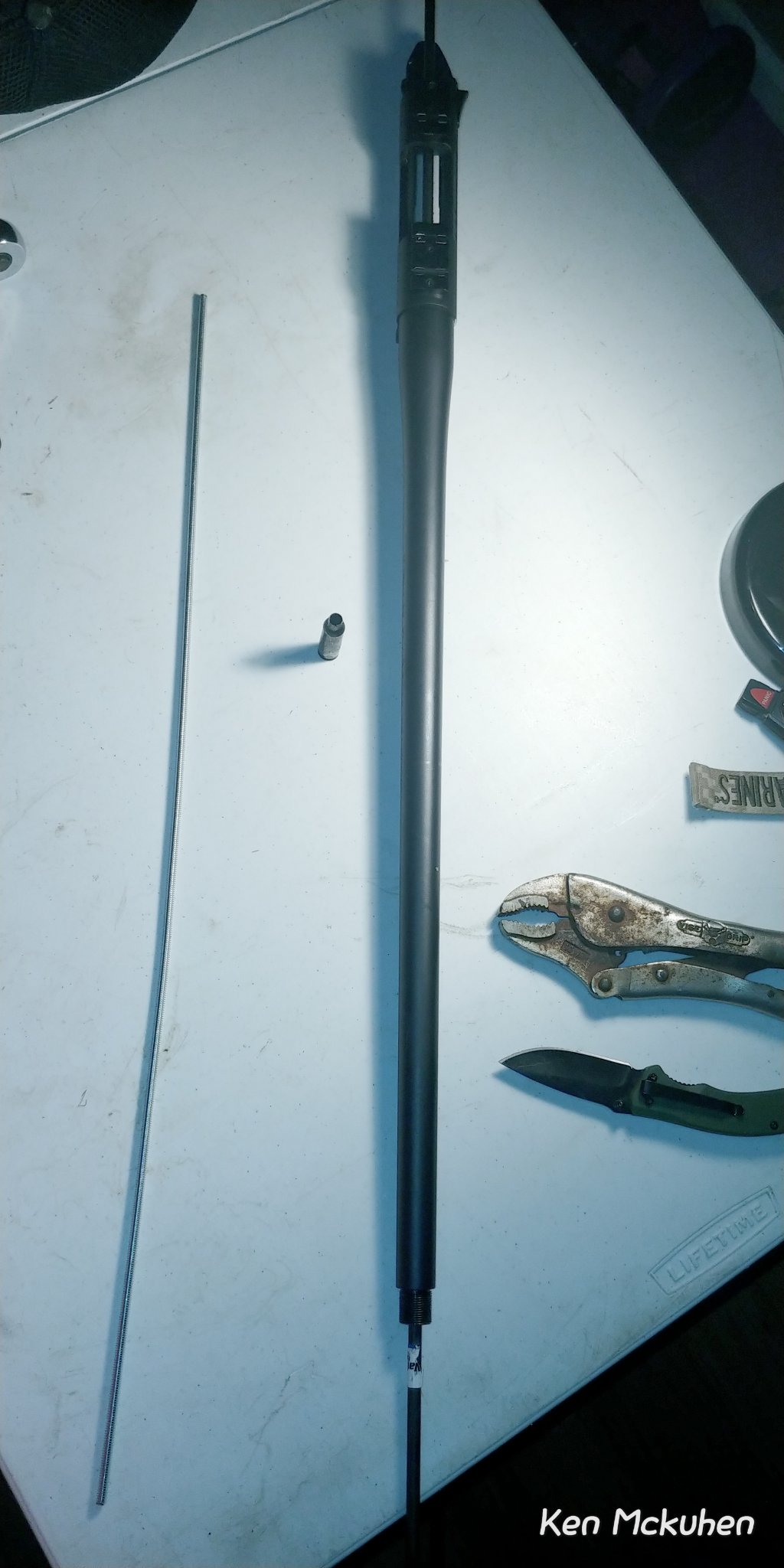

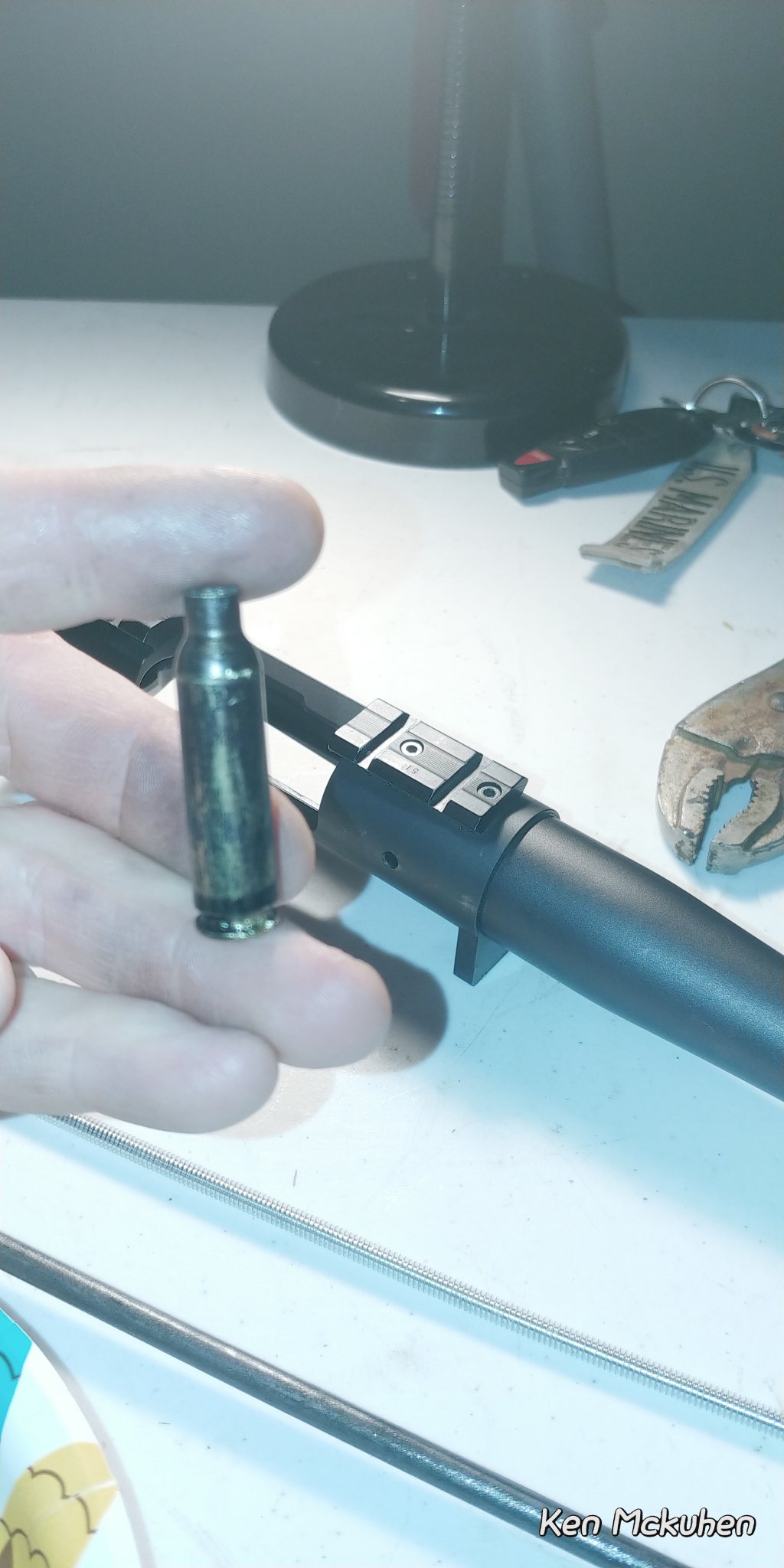

Success. Ended up tapping the primer seat. Using a threaded rod about 1/2 into casing. Neoprene washers against the rear of action with flat washers and a nut.
Minute or so of wrenching down, the case came out like tits on prom night. Quick and easy and ready to get my hands on em.

Damn man by the looks of that piece of brass I would say you are way overdue for a chamber scrubbing.

The dummy rounds were black, originally. The projectile was pressed down into the casing. The dummy brass was filled with some sort of epoxy. I assume when I drilled out the primer, made a grease fitting for the threaded barrel and attempted hydraulic pressure meathod - it pushed the round into powder cavity and the epoxy out through the primer hole.

That makes sense then and helps explain the other issue from your pick were the shoulder looks blown out and radiused. The hydraulic pressure from the muzzle pushing against the bullet I guess displaced the epoxy filler in the case.
