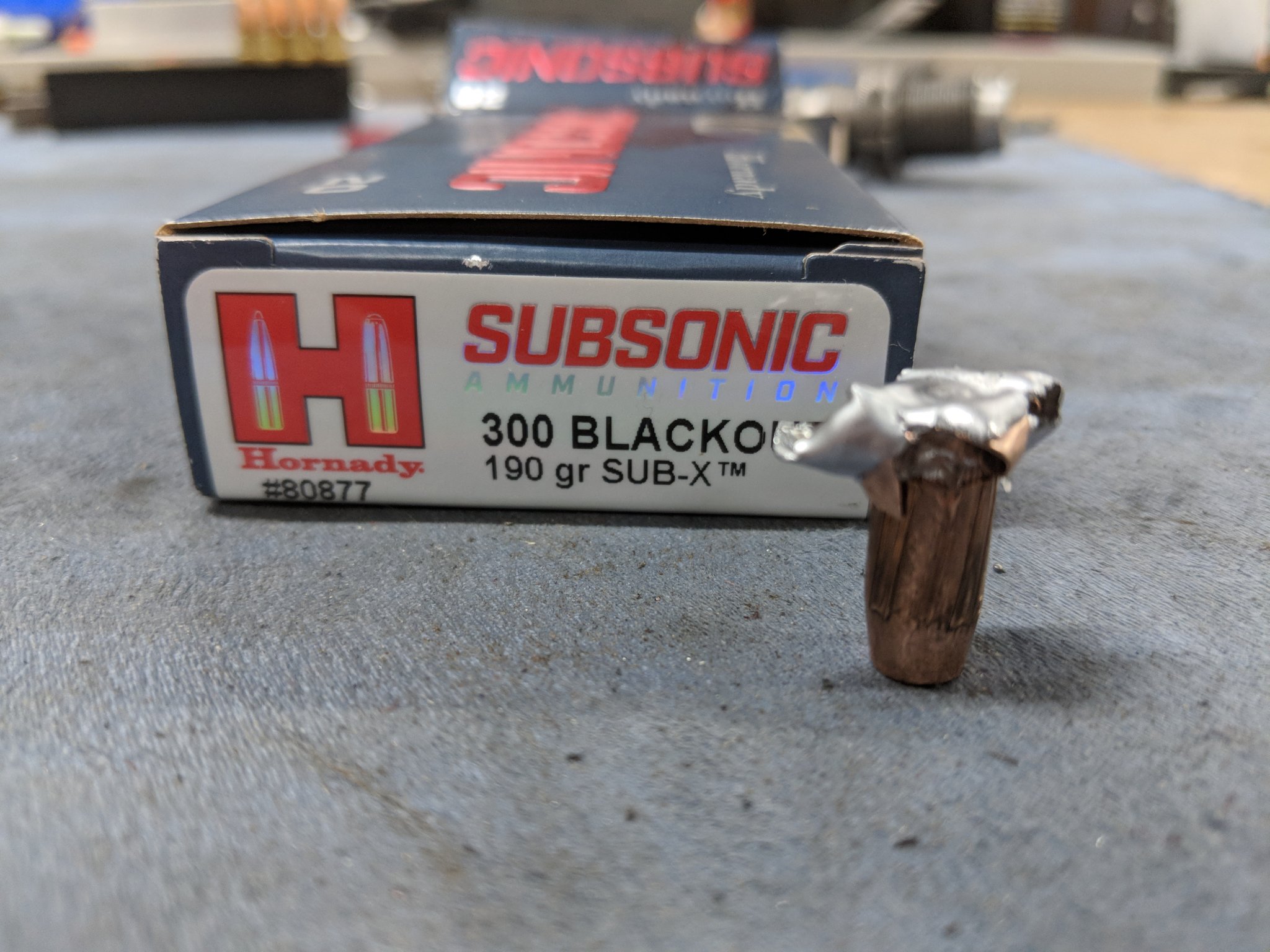

I did some testing with them when they released loaded ammo. I pulled a few, and downloaded them to around 800 fps.

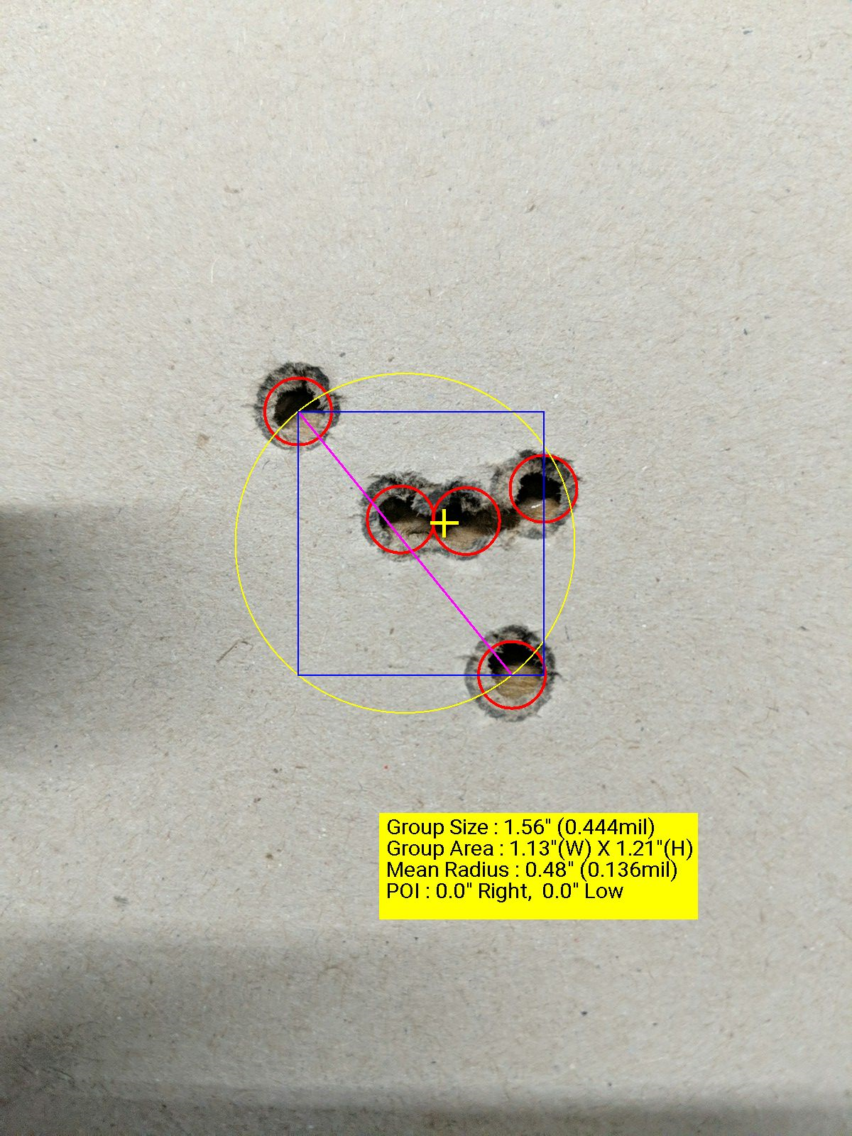

Group at 100 yds.

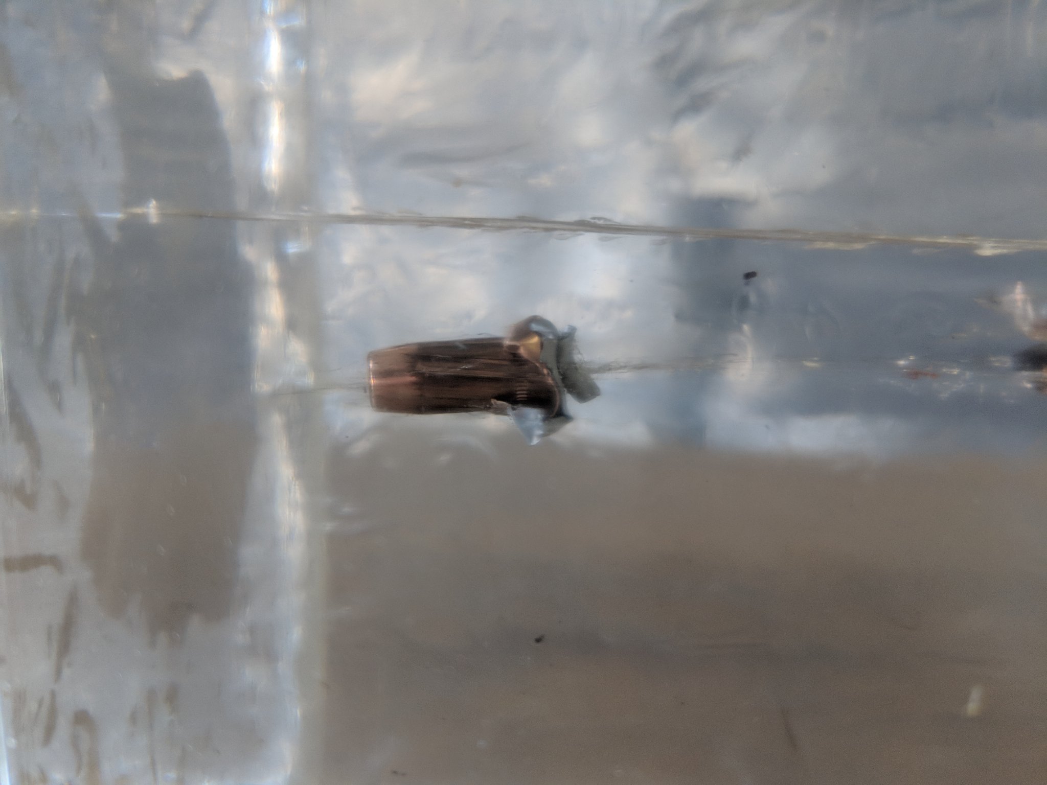

Expansion in 10% Clear Ballistics gel

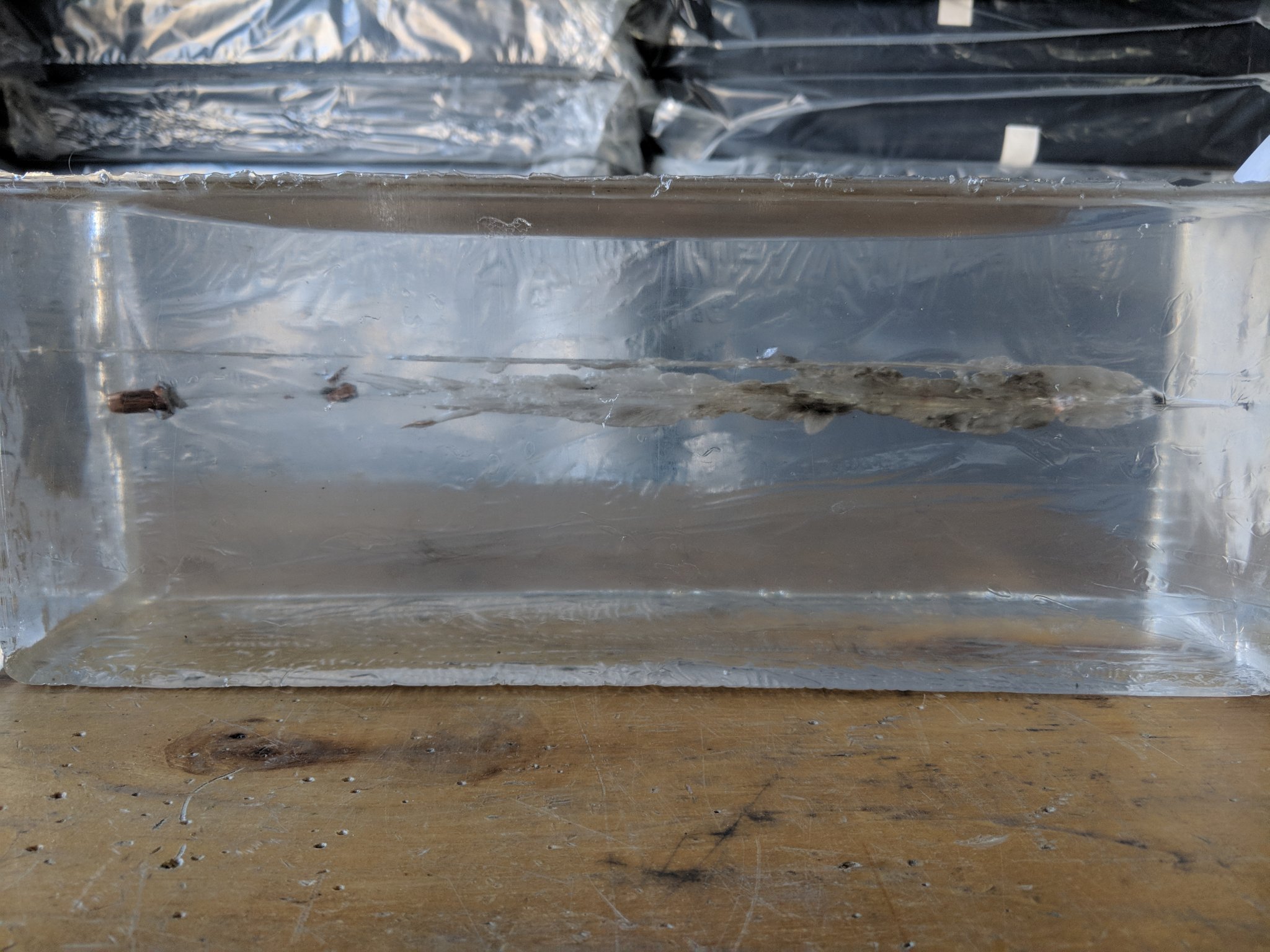

Roughly 14" in gel
