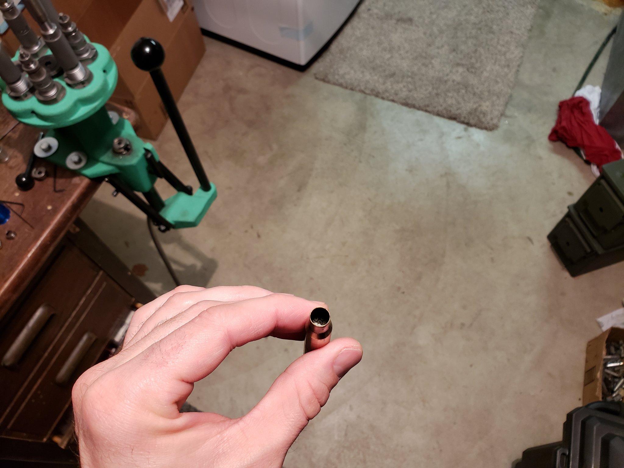

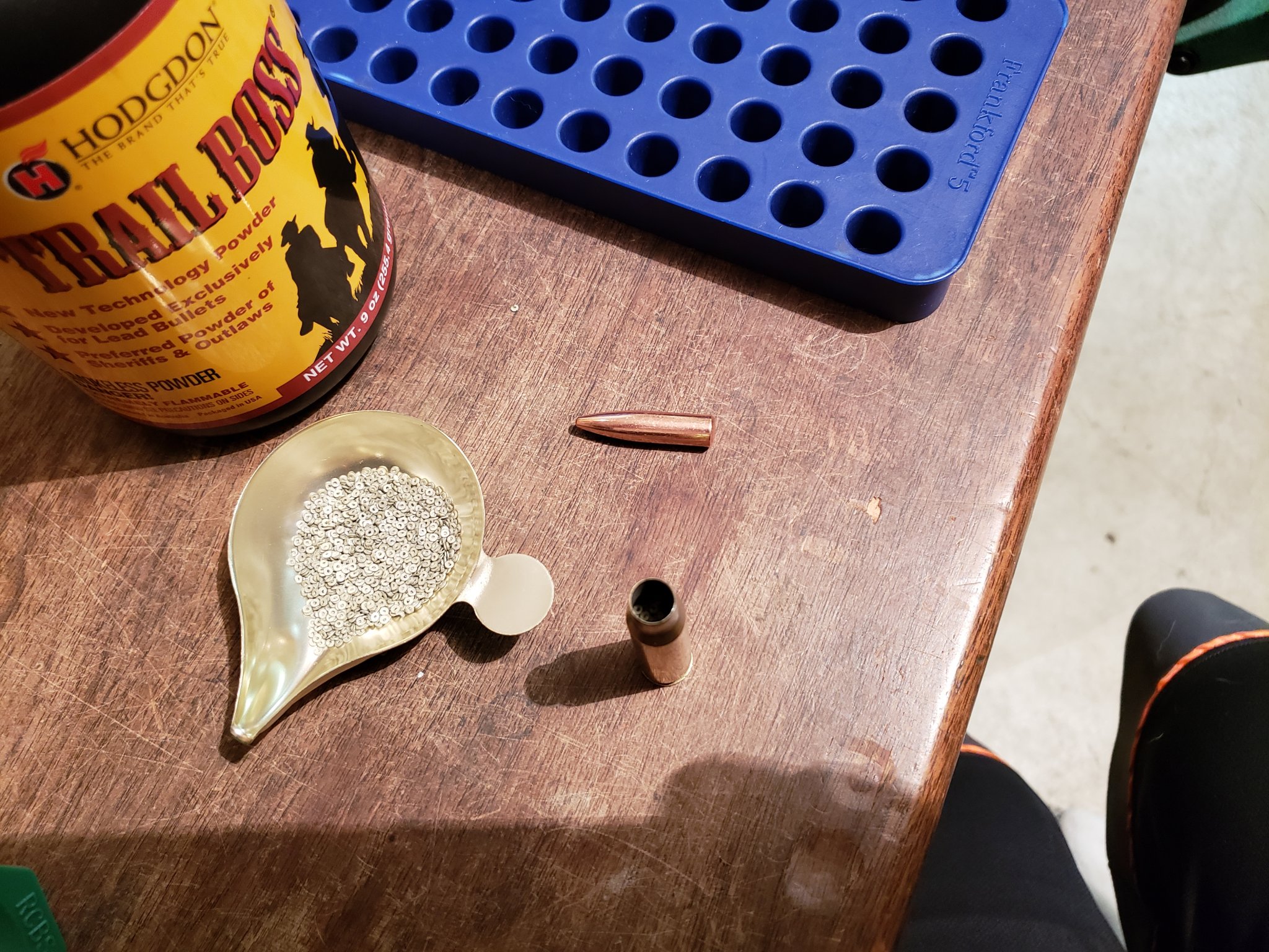

I went ahead and attached a pic of a 308 with 11.5 grains since I'm loading these today anyway for reference?.

I agree something isn't adding up.
12gr of trailboss fills a 308 to the neck.
Your case should be filled just fine to use trail boss.
