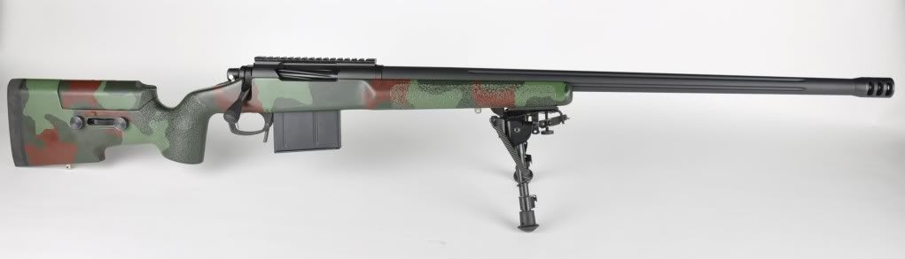

Re: Suggestions for .338 lapua with Stiller tac-338?
The TAC 338 works great with the Badger Mag bottom metal. Here is the last one I built, and it worked flawless.
