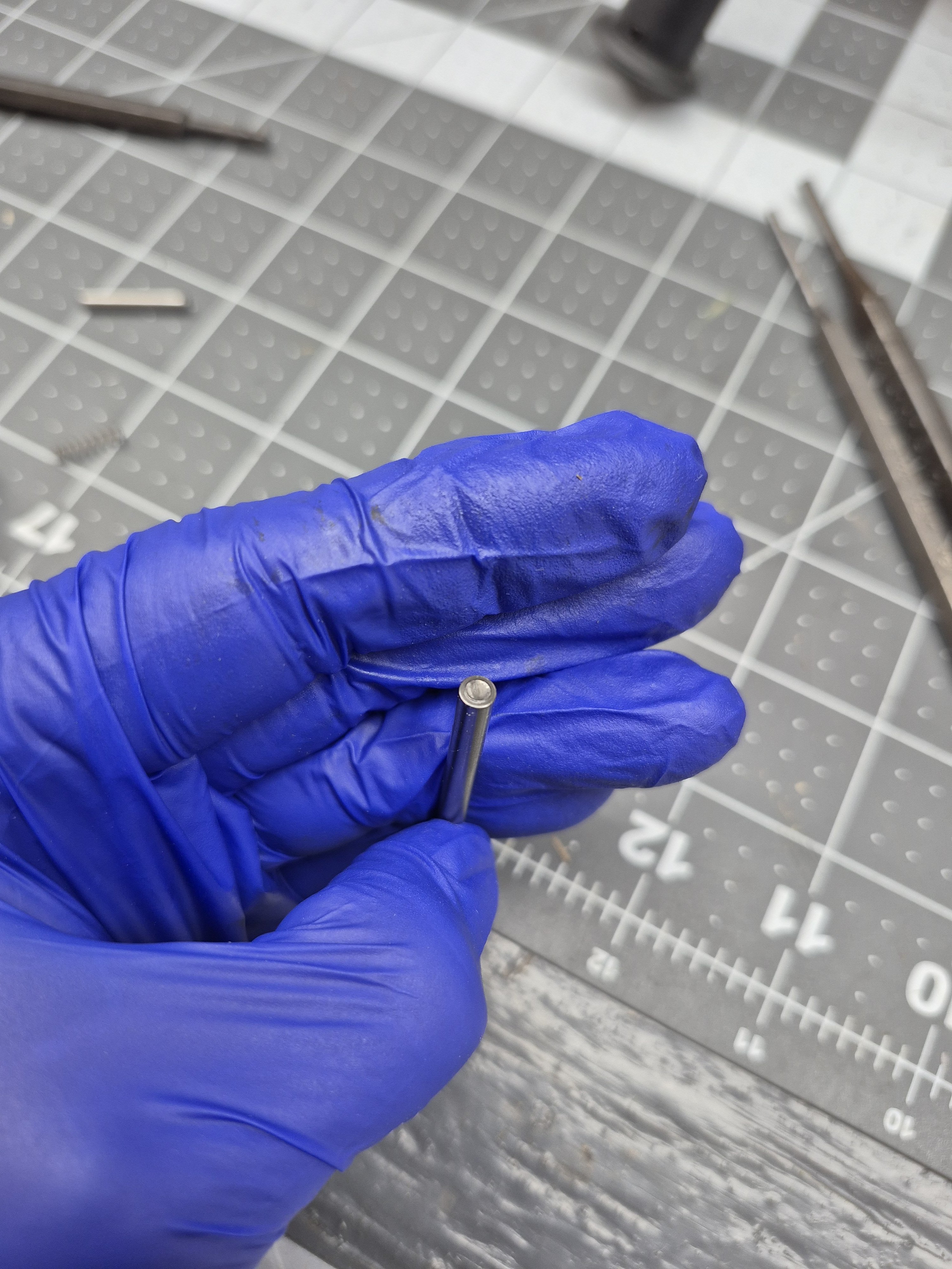

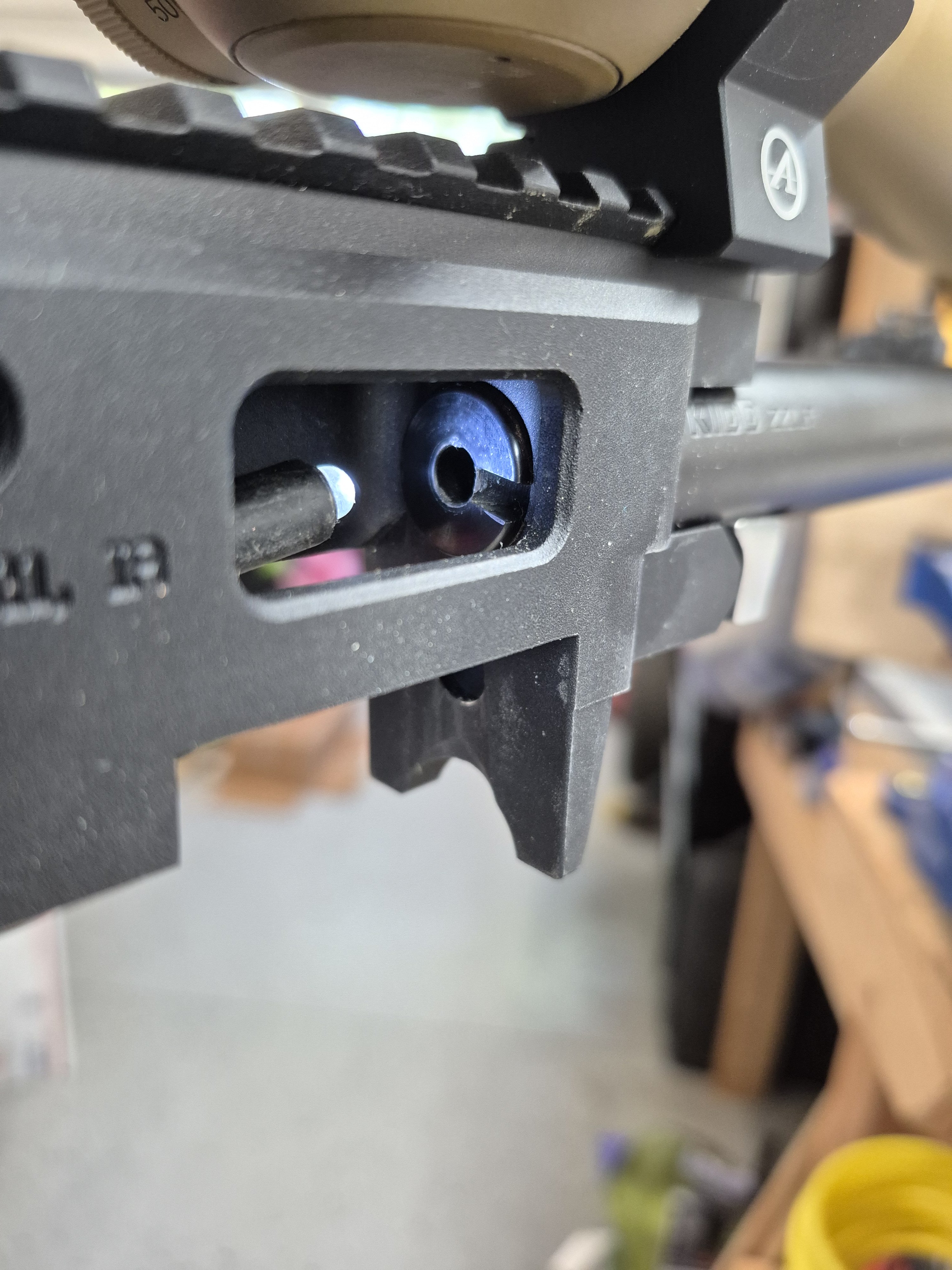

Never realized how hard Lapua was to find. Had to settle for a brick of Pistol OSP to test out. I was going to go today and stripped my gun down to give it a good cleaning before testing the new ammo and found the below.

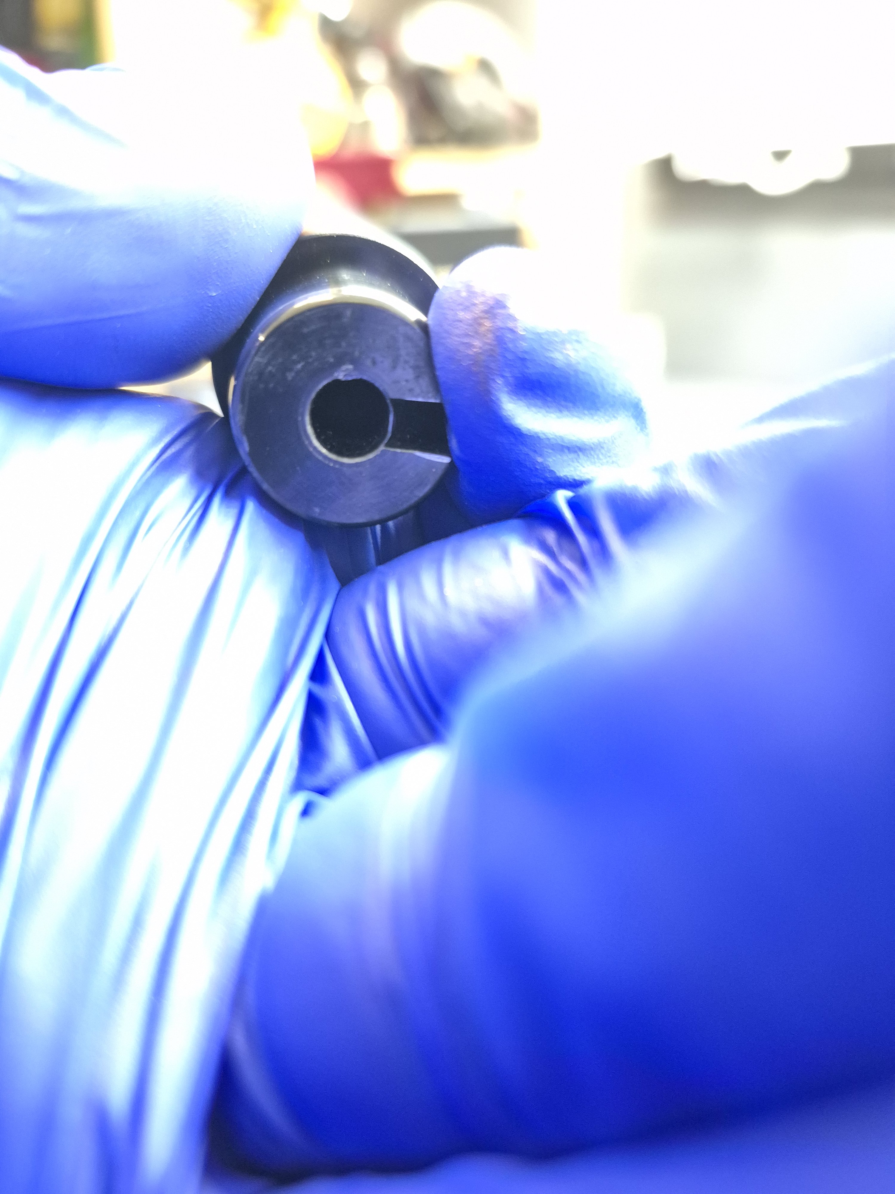

When I was at my parents after the match I tested the gun with a new lot of Wolf and it shot like absolute crap. This would explain it but I have no idea when or how it broke. Since new I've dry fired this gun and never had the pin impact the breech face. I'm going to assume the pin broke and then however it fired broken caused the dimple in the barrel.

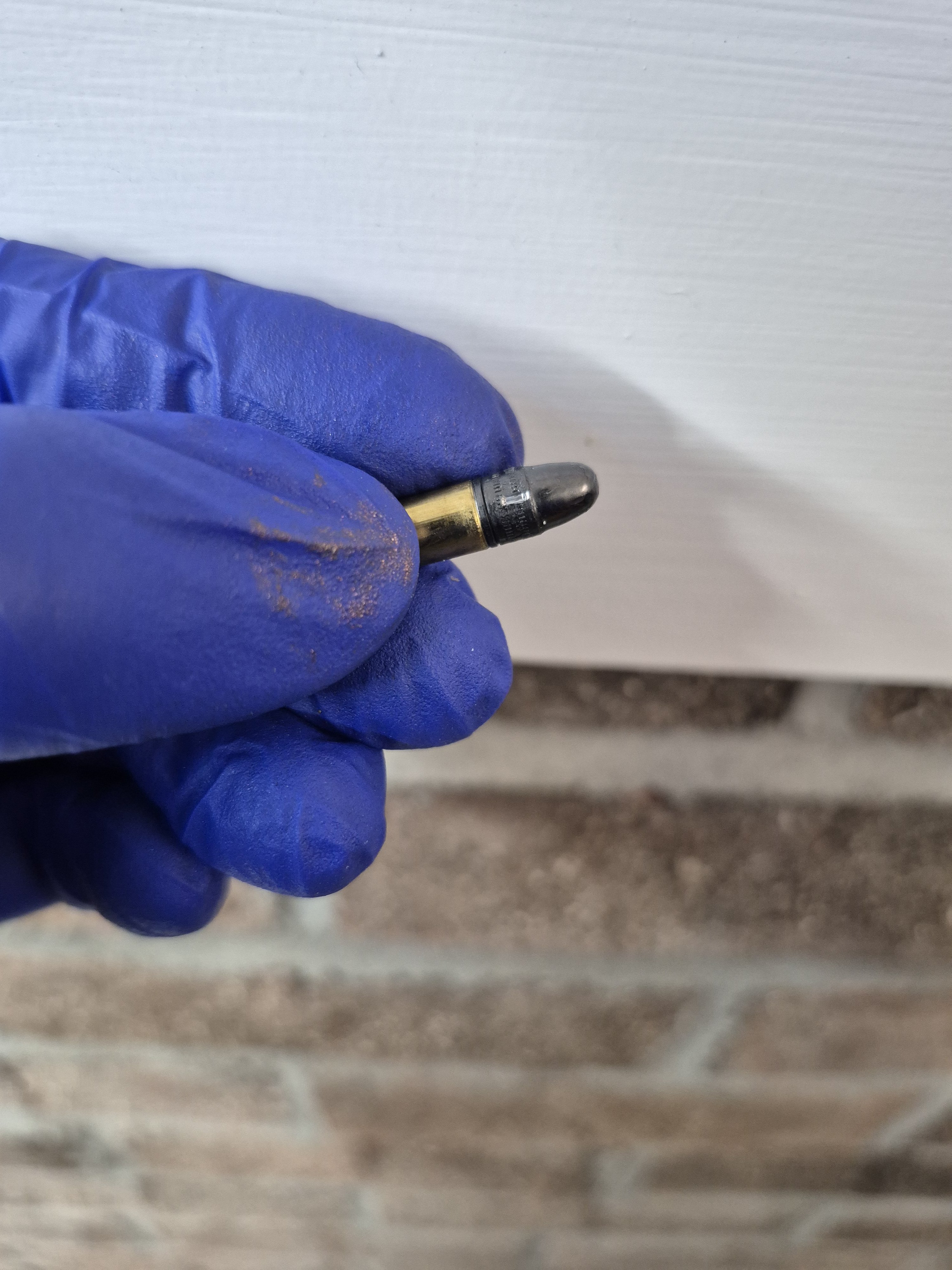

I tried sliding a round in the chamber and you can see it shaving the bullet really bad. Another reason it shot like crap. I took a fine jewelers file to it and got it out and polished it up. Can hardly tell it was even there. No more dry fire on this gun unless it has snap caps.

The firing pin is titanium and $38 for the little fucker. Just outside their 1 year warranty. Probably order 2 to be on the safe side.

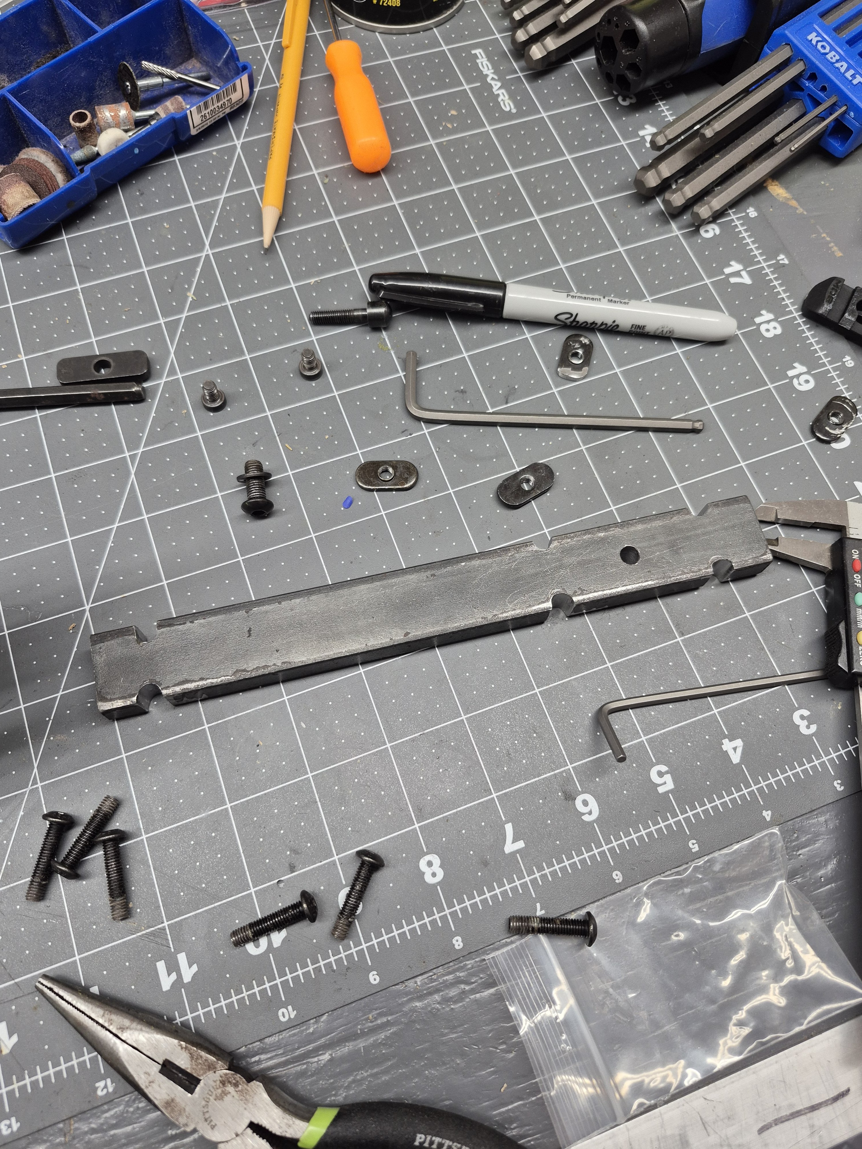

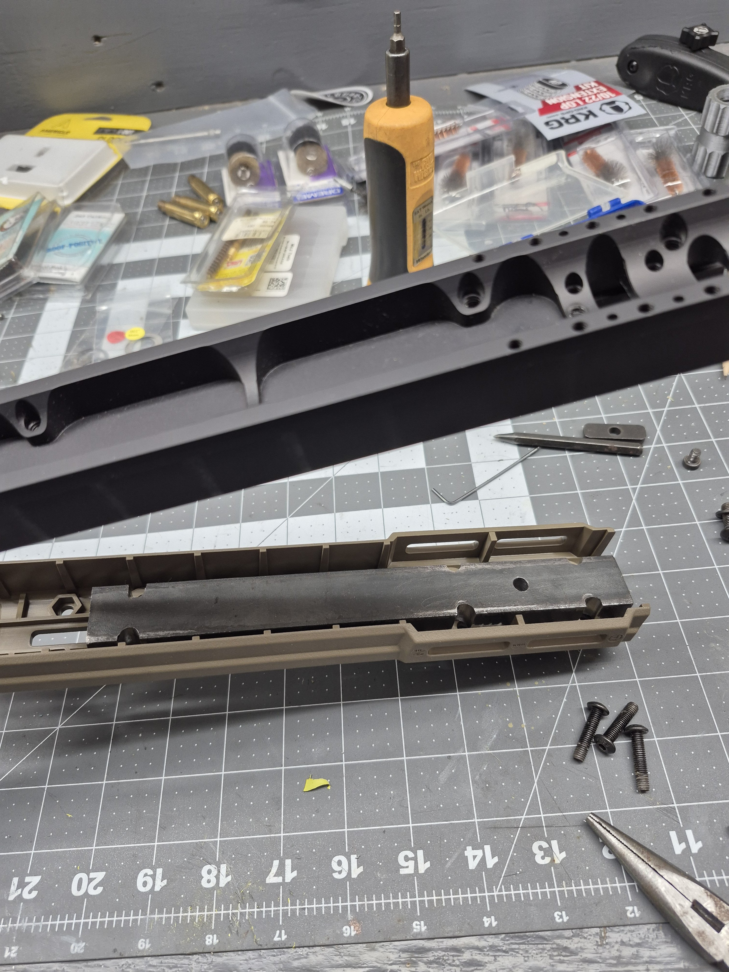

Next up was the weight up front and mounting the bipod better. The 10/22 Bravo doesn't have the slants in the front to hold a harris straight so I needed to mount a pic rail to keep it centered and ran a bipod stud through that. I also took a chunk of steel and cut slots for the screws that matte the plastic exterior to the backbone. This runs from the front almost to the action mounting point. Added some good weight to the front for sure.

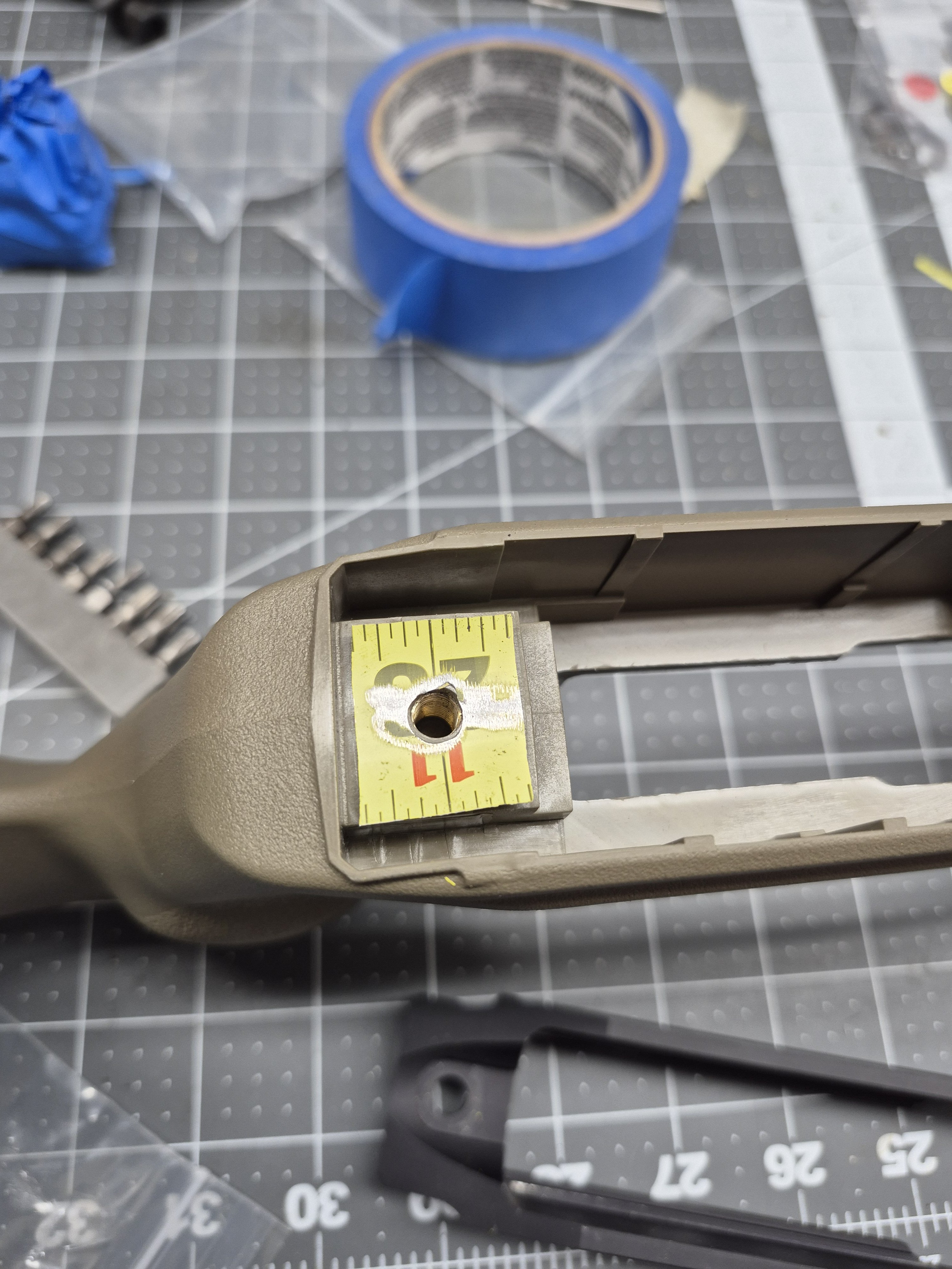

The last thing I wanted to address since I have no 2nd mount point yet is the fit of the rear. Krg sends 2 shims (.010" and .020") but even the .010" was too thick to seat the action. Luckily enough a tape measure tape measures .007" and a piece of blue painters tape .005". I started with making a quick shim from the tape measure and a light tap on the muzzle and she locks up right in the back. With how tight it is I'm not sure how much better a tang mount could be. What it could still improve on is bedding on the sides of the action between the backbone. The barrel can still shift left or right with a good hit.

Research “chamber iron” and you will understand the error of filing away the displaced metal at the chamber rim.
Did you ever use a steel firing pin or only the titanium? What do your pin strikes look like on the fired cases?
There should be a slight radius where the pin changes diameter to decrease the stress loading, if it’s a sharp corner cut the new one will fail as well.

I'll have to look up a chamber iron. Still no proof yet if it will effect this rifle in the end but hopefully this weekend I'll see.
The firing pin is titanium and there was no option for any other material type. It is not a typical 10/22 pin. I'll have to look at the pin harder but there really isn't much radius if at all.
What I'm suspecting is the hammer was dropped when the bolt wasn't completely forward. This would allow the hammer to strike the pin more on an upward strike rather than directly behind. I'm thinking this caused a bend motion in the pin and caused it to break as it did.

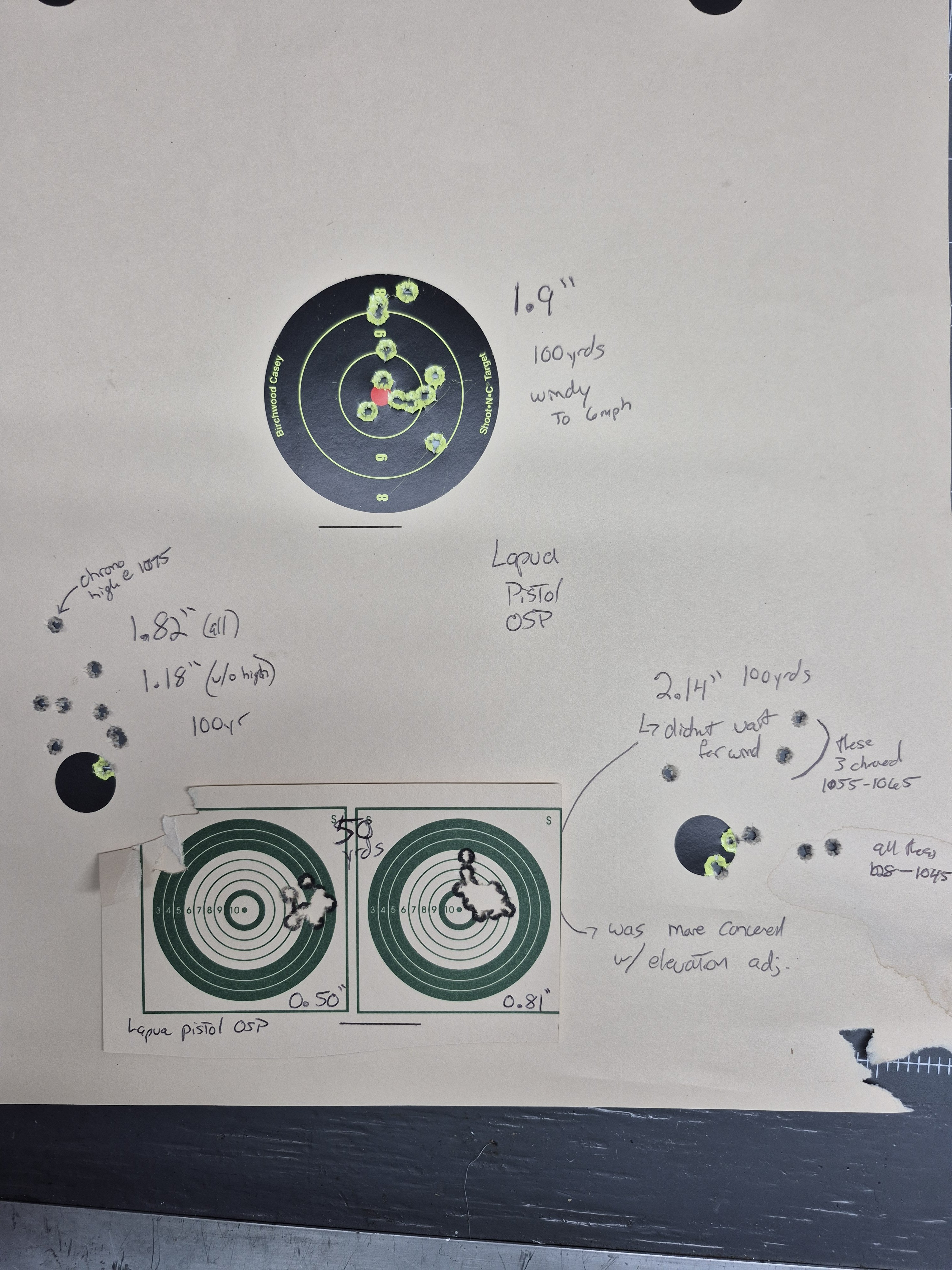

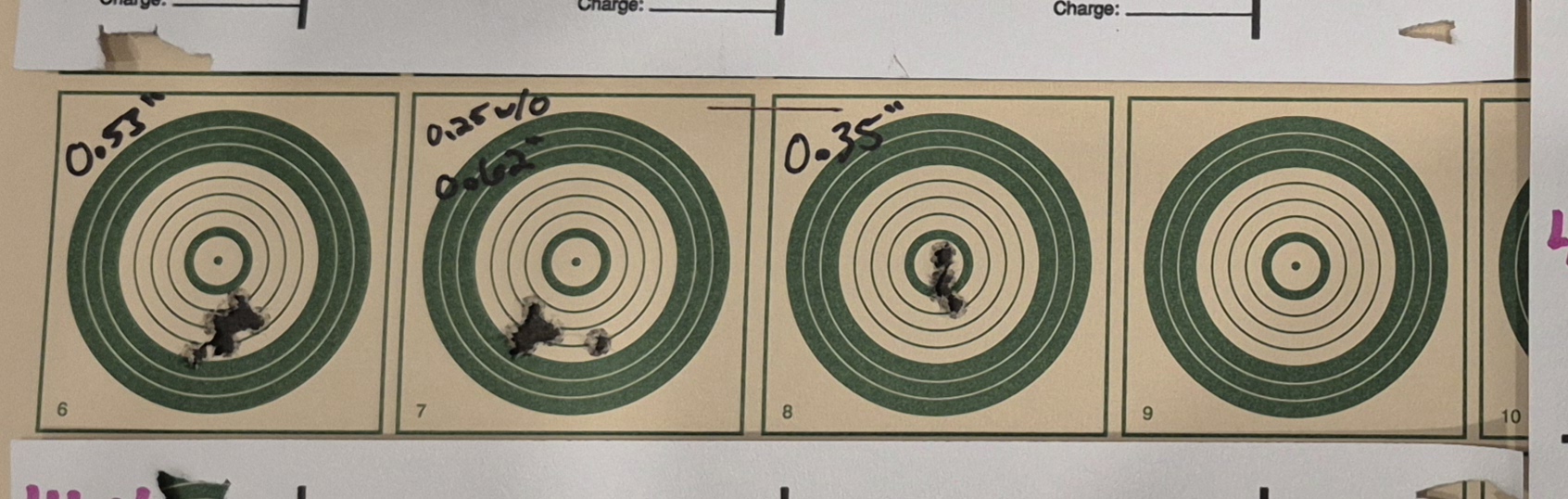

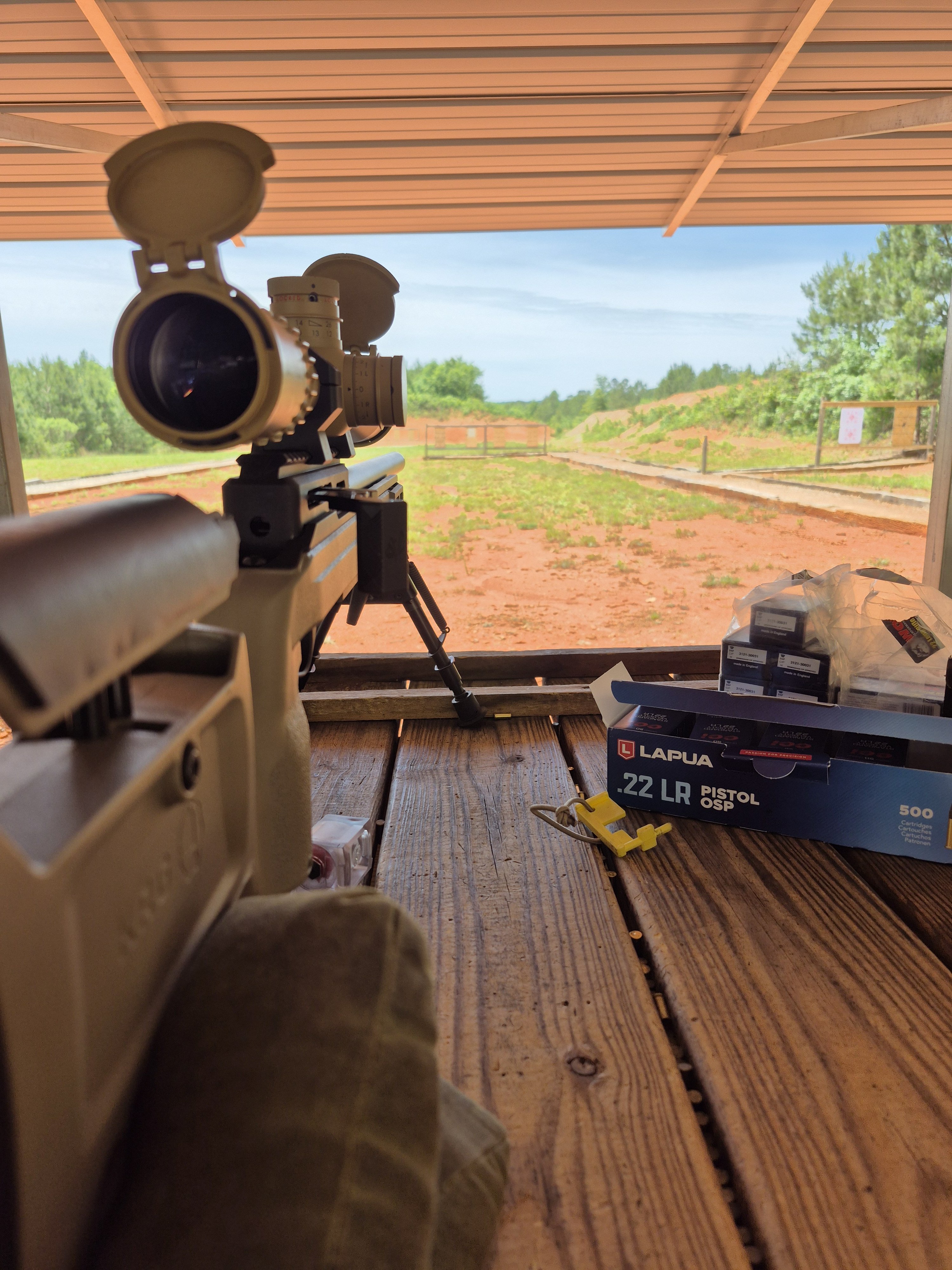

Tried out some Lapua Pistol OSP and it seems to group well with it but the ES could be better. After 100rds were averaging 50es with an SD of about 11. I shot 3 groups at 100 and you can really see when something pops hotter.
3 50yrd groups are 5 shots.
2 50yrd groups are 10 shots
3 100yrd groups are 10 shots
100yrd bottom right group I shot with less regards for the wind, was just checking a slight elevation adjustment. Wind was constantly gusting to 8-12mph on and off. Was just after a storm blew through.

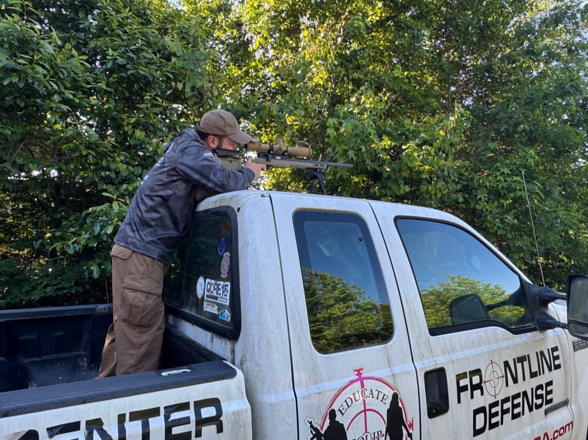

Shot a match and I'll say at this point I'm the loose screw. I shot well but luck of the wind gods on each stage is more of a factor than anything else. Rifle shot amazing and the toggle has a speed advantage on one particular stage. However we all got smoked by the Semi autos on this unlimited round and points stage accuracy by volume got them 13 more hits on this one stage over everyone else. Going to keep chasing this rabbit but I'm thinking maybe this winter getting it a gift for how well she's performed and splurge for a mcmillan 22-A5.... maybe.
I was the first one to hit 440yrds and only one of i think 3 total to hit it. I just did it out of order like an idiot. 26.6 mils of drop, had to dial 20 and hold 6.6.
The one photo the MD got of me
