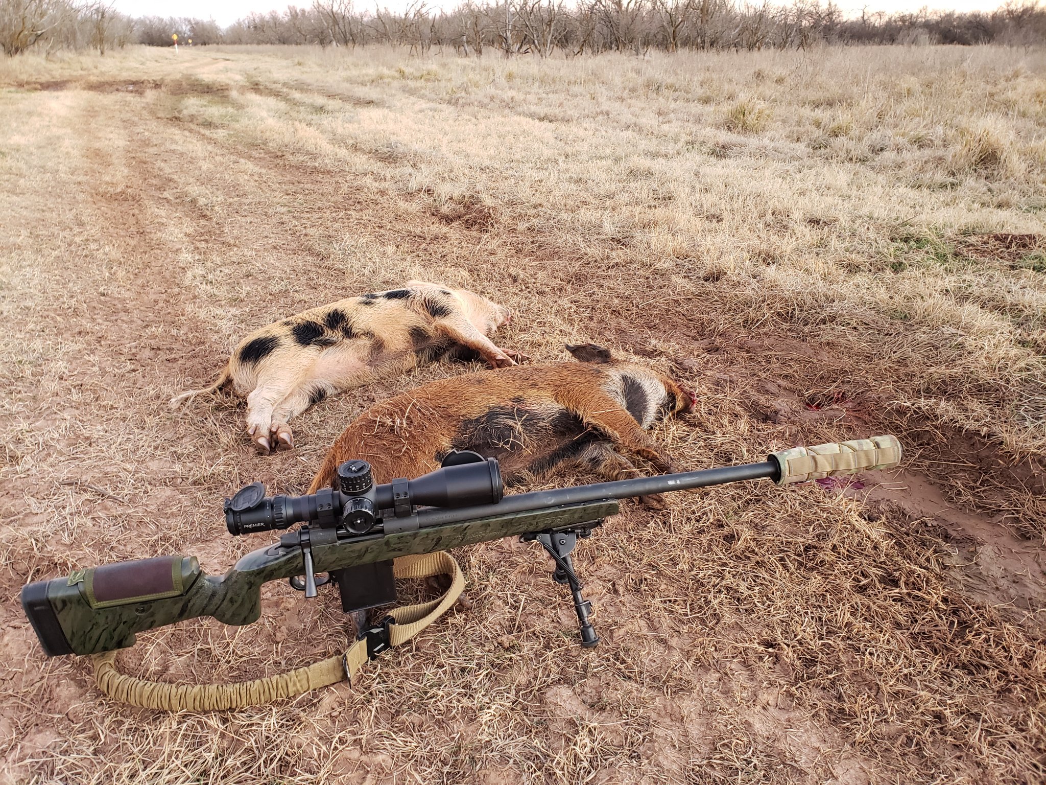

I'm shooting a 6mm Creedmore in a 1-8'' 16.5" , suppressed Medium Varmint barrel on a ARC Nucleus action. I lose 200 fps compared to my same caliber 22" barrel, shooting 105 gr, berger hybrids, shoots 1/2 moa at 600yds which is as far as my range goes. Deer season starts this weekend and Iwill post results if I shoot anything at long range. Yotes out to 300 drop straight down, hit anywhere with minimal exit wound, Texas yotes aren't worth much market wise, and are eliminated for predator control on whitetail ranches.

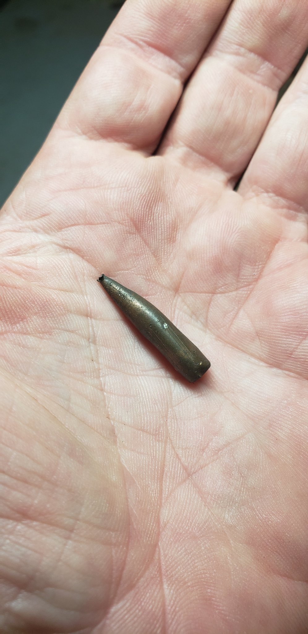

This is an 87gr berger. I had 2 of these. One was dug(melted) out of a frozen milk jug at 640 yds and one was picked up off the ground at 900yds. The one I picked up off the ground skipped in the snow in front of the plate. I saw the splash of snow and thought I missed but then heard "DING"....I was thoroughly confused so I drove down to the target, saw the skip mark in the snow. It went down in the snow, bounced off the ground, came back up out of the snow and hit the plate. The bullet was laying in the snow right in front of the plate. I dont know what happened to the 2nd bullet and I cant remember which one this was but I'm pretty sure this is the one I dug out of the jug at 640yds. Again I'm a target shooter so terminal ballistics dont matter to me but if I was using a rifle for anything bigger than groundhogs I would not be using a Berger. I know they say "hunting" but the terminal ballistics of a real hunting bullet have got to be better.
Seeing that, the 87gr Vmax might be my ticket in a 6mm
If youre only shooting 400 yards max, get a 18-20" 243. Preferably an 8 twist. 9 twist would work too. Not with 105's though. And shoot 90/95gr Nosler ballistic tips. Or some Bergers. Youll smoke varmints all day. Every day. While also having plenty of horsepower to kill anything else you point it at. Ive seen a shitload of coyotes run a long waaays after being hit with a 22 cal. 223 and 22-250 mostly. Bullet diameter matters.
Any idea how those heavier 22 match bullets perform on game? The steel shooter thinks the 85.5 gr Berger hybrids look awesome but I have to remind myself this is going to be a short/mid range coyote gun and I should be looking at vmax’s or varmint hollow points
I've not used the hornady on critters but based on others I'd run them without hesitation. In fact I have a bunch of 80gr eld loaded in my 223ai that will get used some this season. The 80 and 90gr Berger vld kill everything from small varmints to deer out of my 22 creed just fine.

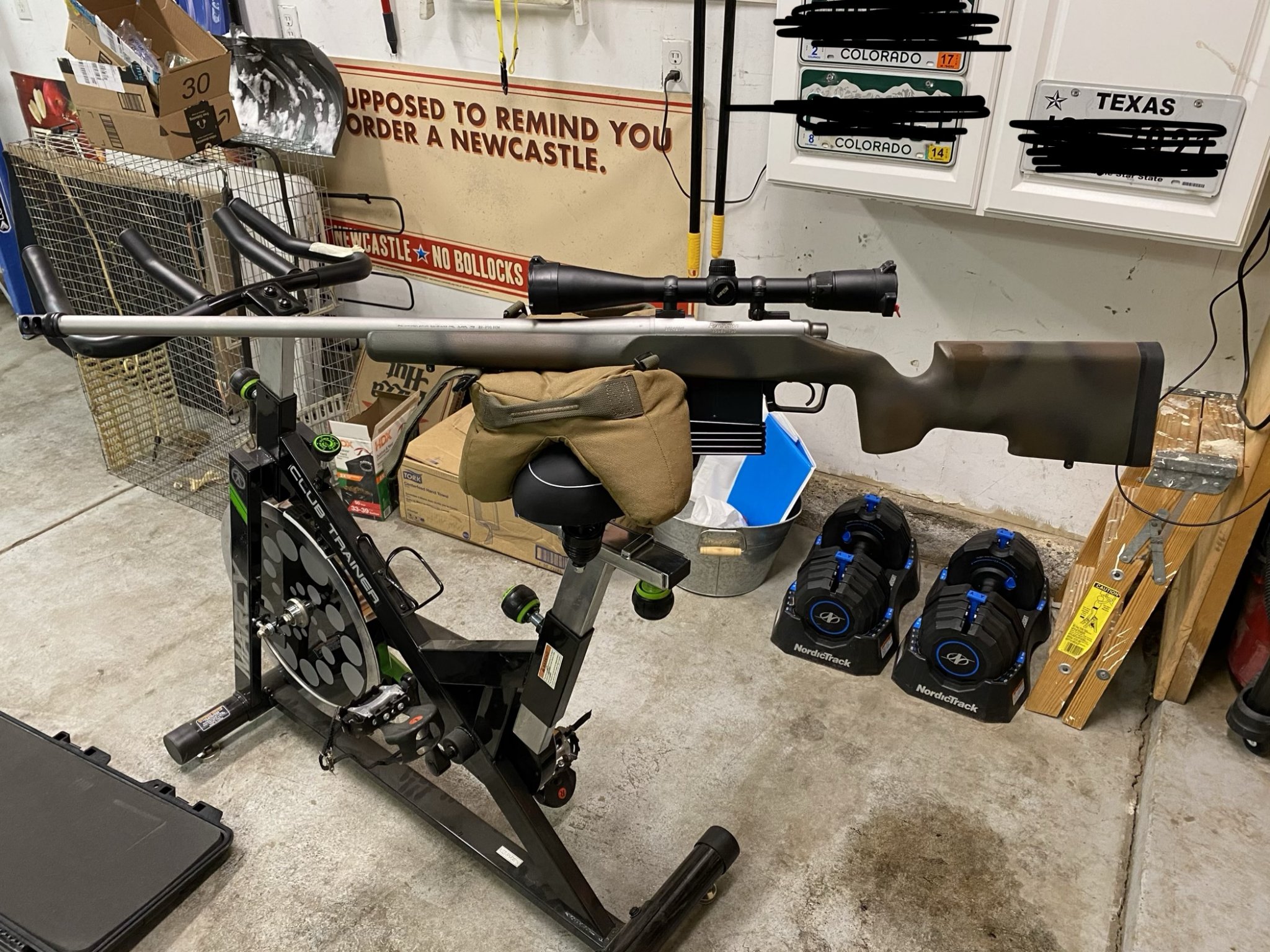

I haven’t built the shorty gun yet and my wife isn’t stoked about me spending the money building a whole new gun. So, I’m thinking of just getting a new 18” barrel for my rem 700 22-250 I have that currently lives in a Grayboe Renegade.
I’m now leaning toward a caliber that may be a little more barrel life friendly. Thinking maybe 223 or 223AI (should still have good velocity for light weight varmint bullets). Maybe the 223 AI I could even run heavier bullets if I wanted to use it as a trainer rifle.
Any other barrel friendly calibers to consider like 6BR? Not sure 6BR would be worth it in an 18” barrel.
picture of my rifle as-is today below (26” Varmint barrel)
You’d need a new bolt for the .223/.223AI if you’re gonna go with rebarreling your current .22-250. If you’re gonna go that route, you’ll probably not save that much money over just buying a new complete rifle (or used rifle on the PX here).
How do you like your Renegade stock? Looks nice.
I like it. I wasn’t crazy about the woodland camo at first but I got a great deal on it and the color is growing on me now.
The stock itself is solid, it would probably make a decent weapon itself if just used as a club.
All joking aside it is nice and the Grayboe bottom metal is very nice as well. It actually accommodates all of my AI mags better than my Hawkins bottom metal on another gun.
