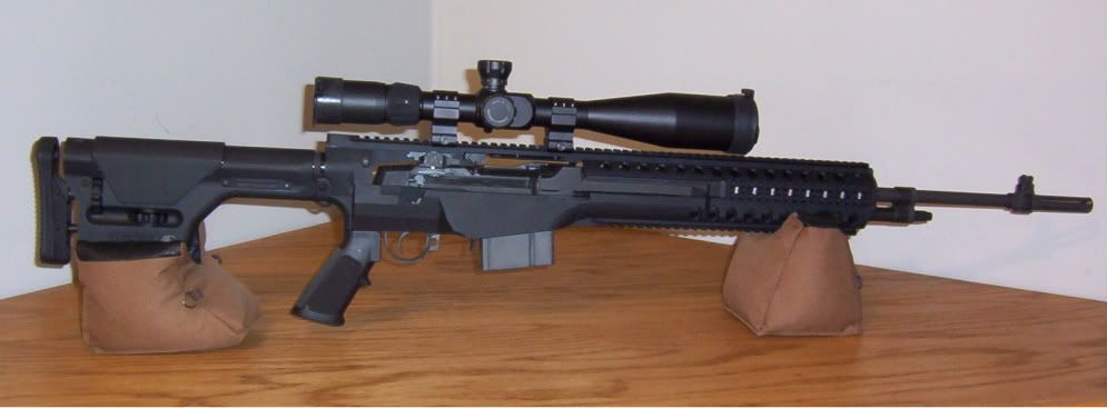

Like I said its in a Troy stock so there's no adding a scope mount. Here's a Pic.

The Breech shield is for shooting with the blank firing attachment and is specifically for keeping the gas out of your face. Good stuff.
You can put one o several direct connect onto the muzzle threads, or if you want to use a direct connect you could also use an adapter and put a standard 5/8-24 thread QD on that and keep your front sight.
Whatever setup you put on, check the bore of the supprssor the first time you install to make sure everything lines up. You are pulling against a very small shoulder there on the front of the barrel.
Best of luck with your project. I dig the rail on it.

That's what I'm hoping for cause for the life of me I can't find that damn breech shield anywhere(thanks for the link 762 I'm sure it's there but I can't find it)

It's there if you want to buy it. It's under M14 accessories as the blank firing attachment kit. You should be okay with the Troy MCS. I receive very little gas blowback using my scoped and suppressed M1A.
