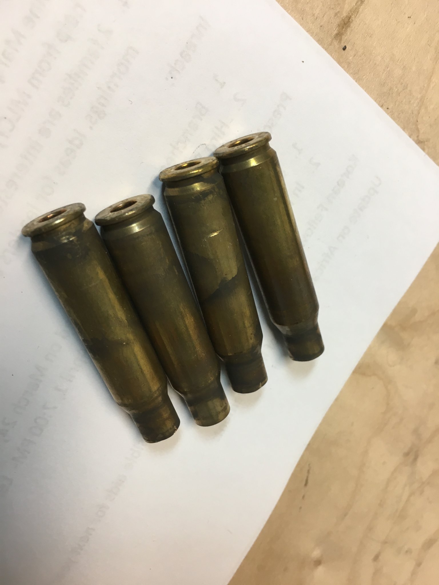

Recently started shooting with a can. Bullet casing after shooting looks like it’s tarnished. What’s going on?

Looks dirty which is normal to an extent. These fired in a semi auto?
If so, where was the ejection pattern (3-4 o’clock is normal, indicative of acceptable pressures).
What can are you using?
Factory or hand loads?
Rifle was cleaned hours before these shots. Semi auto ar10. Barnes ttsx factory loads. Dead air sandman. I didn’t notice where cases flew. I was in a box blind. I plan to go to the range soonish.... i have an adjustable gas block. First can on semi auto.
No problem, semi autos and suppressors can be tricky. Adjust your gas block until the ejection pattern is at 3-4 o’clock and watch for pressure signs. If it groups, ejects at 3-4 consistently with none of the usual pressure indicators on the brass you should be fine.
Gas blowback will dirty the brass, esp if the can itself generates lots of back pressure (most do but KAC and SF manage back pressure well at the cost of overall sound suppression)
